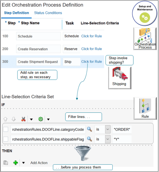

Here's an example line selection criteria:
The line selection criteria filters out lines that can't ship so Order Management only sends shippable lines to the fulfillment system that processes shippable lines, such as your shipping system or Oracle Global Order Promising.
Note
Use the Manage Orchestration Process Definitions task in the Setup and Maintenance work area.
Use the line selection criteria to add the rule.
Add the rule to each orchestration process step that shippable affects, as necessary. For example, if the item is a warranty, then it isn't shippable. To filter out the line that isn't shippable, you probably want to add the rule to each step that references a schedule, reserve, or ship task, such as the Schedule step, the Create Reservation step, Create Shipment Request step, and so on.
The entire If statement isn't visible in the screen capture. Here are the entire statements:
DooSeededOrchestrationRules.DOOFLine.categoryCode is "ORDER" -
DooSeededOrchestrationRules.DOOFLine.shippableFlag is "Y"

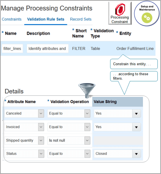

Constrain Changes That You Allow on Order Lines
Note
Use the Manage Processing Constraints task in the Setup and Maintenance work area.
Set the Entity attribute to Order Fulfillment Line.
Use the Details area to add your filters.
Assume that if the order line is closed or canceled, or if Order Management already shipped it or invoiced it, then you don't want your users to modify a value on the line, such as Ship-to Site:
Attribute Name
Validation Operation
Value String
Canceled
Equal To
Yes
Invoiced
Equal To
Yes
Shipped Quantity
Is Not Null
Status
Equal To
Closed
