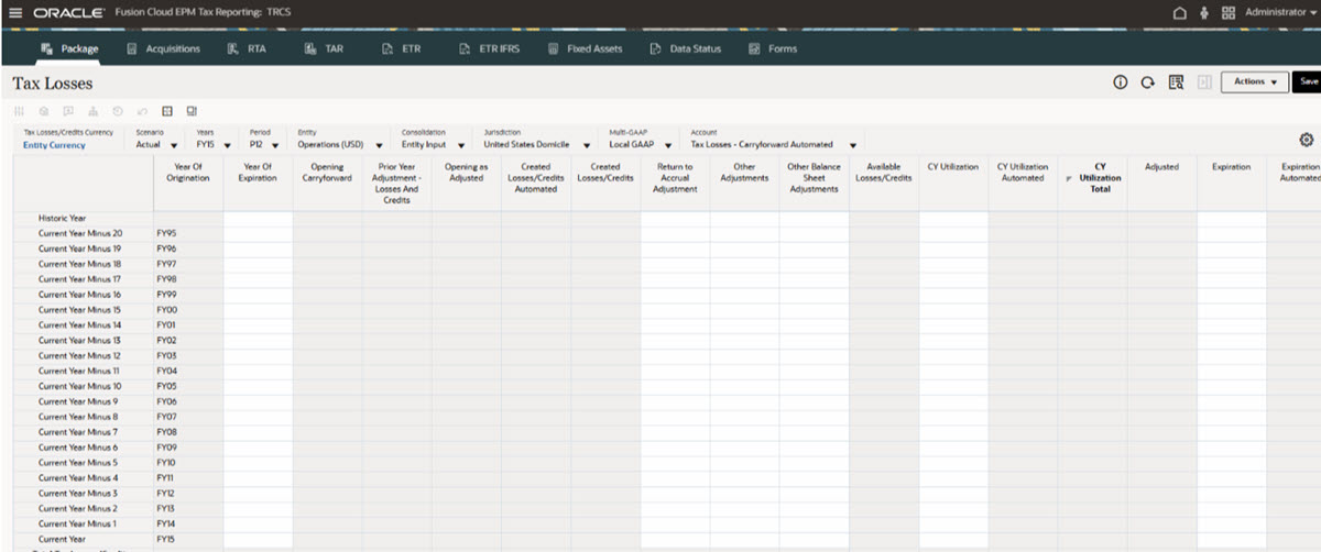

From the Home page, select Tax Provision National, and then Package, The columns on both the Tax Losses and Tax Credits forms are the same. See the table, "Tax Losses and Tax Credits Detailed Schedule " below for an explanation of each column.
Tax Losses Form
Table 12-1 Tax Losses and Tax Credits Detailed Schedule
