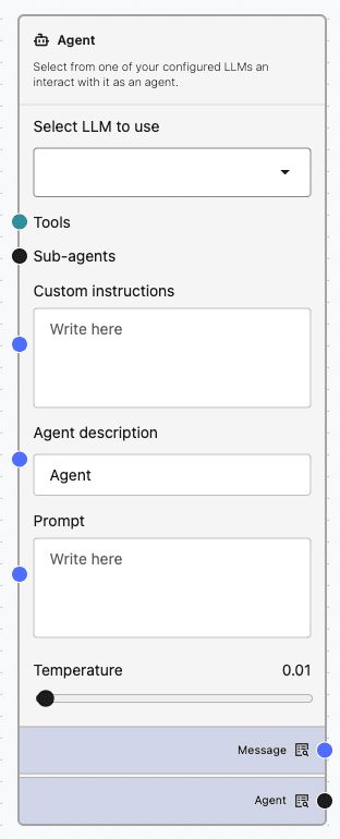

Agent
An Agent node uses an LLM configured in LLM Management to carry out instructions, answer questions, and orchestrate complex multi-step tasks using hierarchical manager/worker orchestration and sub-agents.
When to use?
- For multi-step tasks that require tool calls, planning, or delegation
- In manager/worker scenarios where a coordinator Agent assigns tasks to sub-agents
- When tool-enabled reasoning is needed such as search, APIs, or debugging tools
How to add and configure?
- Drag the Agent node onto the canvas.
- Select a base LLM from LLM Management.
- Optionally, attach relevant Tools.
- Optionally, connect other Agent nodes to the Sub-agents connector to set up manager/worker orchestration.
- Provide instructions through a Prompt or Message input.
- Optionally, set the temperature to a low value for more predictable and deterministic responses from the LLM, or to a high value for more varied and creative output.
- Connect the output Message as input to Agent, Output, or Processing components per the flow logic.
Inputs:
- Message (instructions)
- Optional JSON or tool configurations as needed
Outputs:
- Message: Agent result or summary
- JSON: Tool results or any structured output produced by the agent

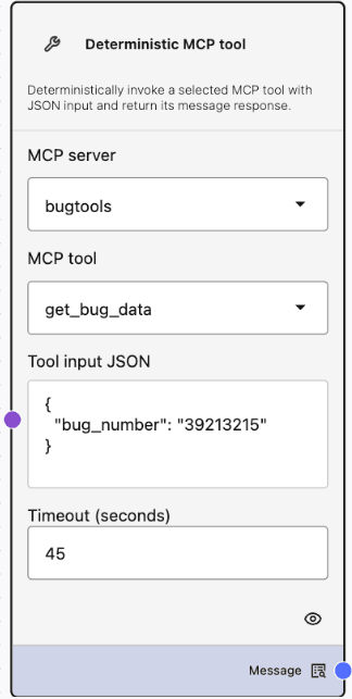

Bug Tools
The Bug Tools node is a specialized component for interacting with your organization’s bug or issue trackers.
When to use?
- To query bugs, create updates or comments, or retrieve triage information
- To automate bug lifecycle processes within an Agent flow
- Drag the Agent node (or another compatible node that supports tool calls) onto the canvas.
- Attach Bug Tools in the Agent’s Tools configuration.
- Provide the required credentials or configuration for your bug tracking system.
- Use prompts or instructions within your Agent to invoke Bug Tools.
Inputs: Tool parameters supplied by Agent prompts or upstream data
Outputs: Message summaries or structured JSON results returned by the tool
- Be explicit in your prompts by specifying which bug ID(s) to query or update.
- Use the Parser or Type Convert node to format tool JSON output for display.

Deterministic MCP Server
The Deterministic MCP Server node invokes one specific tool from a saved MCP server by using explicit JSON input. It returns the selected tool response as a message.
When to use?
- To run a specific MCP tool without agentic tool selection
- To use a saved MCP server with a known tool and payload
- To execute deterministic tool calls where the server, tool, and JSON input are chosen up front
- Make sure an MCP server has already been created and saved in the MCP server configuration area.
- Drag the Deterministic MCP Server node from the Tools category onto the canvas.
- Select the saved MCP server.
- Select the MCP tool exposed by the selected server.
- Provide Tool input JSON, or connect an upstream node to pass the JSON payload at runtime.
- Optionally, adjust the timeout value in seconds.
- Use View tool description to inspect the selected tool description and input schema.
Inputs:
- MCP server: The saved MCP server source to use
- MCP tool: The tool exposed by the selected MCP server
- Tool input JSON: A JSON object payload passed to the selected MCP tool
- Timeout (seconds): Timeout used while discovering tool metadata
Outputs:
- Message: The selected MCP tool’s returned text
Note: The payload must be a JSON object. If an upstream node is connected to Tool input JSON, that incoming value overrides the inline JSON.
The node loads available tools dynamically based on the selected server, shows the tool description and input schema, and generates a default JSON payload skeleton from the tool’s input schema when available. It resolves MCP authentication from the saved wallet secret for the selected server, supports MCP servers exposed over SSE or streamable HTTP, and returns the first text content item from the MCP tool response.
The node reports readable validation and execution errors for missing server, missing tool, invalid JSON, schema mismatch, invalid URL, authentication issues, and MCP transport failures.

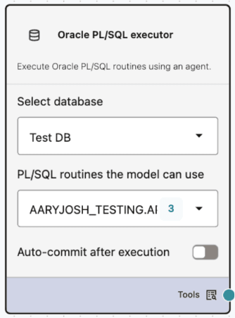

Oracle PL/SQL Executor
The Oracle PL/SQL Executor node exposes selected Oracle PL/SQL procedures and functions as tools that an Agent can call. It uses Oracle catalog metadata and runtime execution logic to discover and invoke in-database business logic safely through a structured tool interface.
The node provides a discovery tool for listing routines and signatures, and an execution tool for invoking an approved procedure or function with bound arguments. It supports packaged procedures, standalone procedures, functions, overload selection, named and positional arguments, OUT and IN OUT values, return values, and DBMS_OUTPUT capture.
When to use?
- You want an Agent to call existing Oracle stored procedures/functions instead of rebuilding the same logic in a separate service.
- You need to expose curated in-database business operations to an LLM using tool-calling.
- You want the model to discover available PL/SQL routines first, then execute only approved routines.
- Register or reuse an Oracle database datasource in Agent Builder.
- Add the Oracle PL/SQL Executor node from the Tools category.
- Select the target database.
- Choose the specific PL/SQL routines the model is allowed to use.
- Set Auto-commit after execution only if the use case requires successful calls to be committed automatically.
- Connect the node’s Tools output to an Agent node.
- In the Agent instructions, guide the LLM to use the discovery tool first when needed, call the execution tool with the exact routine or qualified name, and report results only when the tool returns success.
Inputs:
- Oracle datasource selection
- Allowed routine selection
- Optional auto-commit at runtime
Outputs:
- Message summaries by Agent
Only routines visible in the connected schema metadata can be executed. The node does not execute arbitrary free-form PL/SQL text from the LLM. It discovers routines from Oracle metadata, resolves requested routines against the discovered set, and builds executable blocks only from validated metadata.

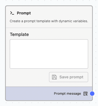

Prompt
The Prompt node creates and formats textual instructions for an LLM or Agent, often combining fixed instructions with dynamic values from upstream nodes.
When to use?
- To centralize system instructions and role-based prompts
- To create templates that incorporate values from upstream nodes
- Drag the Prompt node onto the canvas.
- Write your instructions, optionally using placeholders to reference outputs from upstream nodes.
- Connect the Prompt node to an LLM or Agent node.
Inputs: Message or JSON data for variable interpolation
Outputs: Message containing the final prompt text

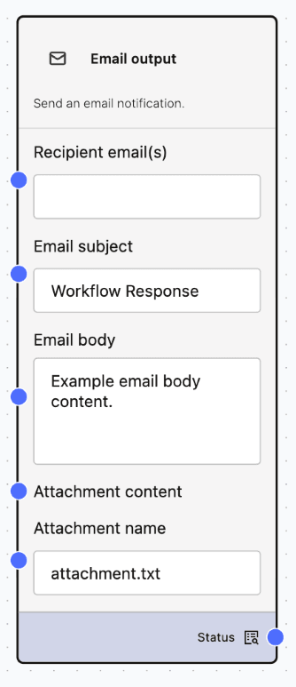

Email Output
The Email Output node sends generated content via email. Accepts comma-separated email addresses and sends the generated content by email to multiple recipients.
When to use?
- To notify stakeholders by sending artifacts such as summaries, alerts, or reports
- To automate email communications within your workflows
- Make sure SMTP is configured. See SMTP Configuration
- Drag the Email Output node onto the canvas.
- Provide a subject, specify recipients as comma-separated email addresses to send to multiple people, and connect the Message output from an upstream node to serve as the email body.
- Optionally, attach any supported files using upstream file or data nodes.
Inputs:
- Recipient email(s)
- Email subject,
- Email body,
- Attachment content(optional),
- Attachment name (optional, default name:
attachment.txt)
Outputs: None (the node sends the email)

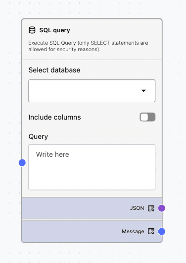

SQL Query
The SQL Query node executes SQL statements against configured databases and returns the results for use in workflows.
Note: Only SELECT-like queries are supported for security and governance.
When to use?
- To retrieve data for enriching prompts
- To enable further processing or visualization downstream
- Ensure the database connection is set up. See Database Data Source.
- Drag the SQL Query node into your workflow.
- Enter your SQL query text. This can be static or parameterized using data from upstream nodes.
- Connect the output to nodes such as Parser, Type Convert, or Combine JSON.
Inputs: Message or JSON containing the query and its parameters
Outputs:
- DataFrame: Tabular data results
- JSON: Array of row objects

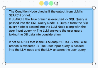

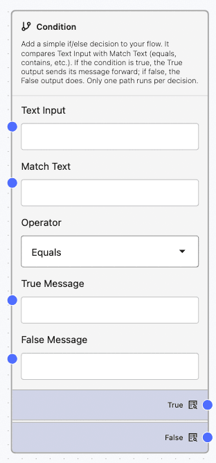

Condition
The Condition node enables simple if-else decision logic in agent flows. Use condition node to compare a Text Input against a Match Text using operators. If the condition evaluates to true, it outputs a configurable true message and follows the “true” branch. If false, it outputs a false message and follows the “false” branch. You can use it for basic branching without complex orchestration.
When to use?
- Route flows based on keywords or user roles.
- Validate input values, such as numbers or specific formats.
- Gate actions before invoking tools or services.
Drag the Condition node onto the canvas.
- Configure the following settings:
- Text Input: The value you want to check.
- Match Text: The value to compare against.
- Operator: Choose from equals, not equals, contains, not contains, greater than, less than, or regex match.
- True Message (optional): Message to return if the condition is met.
- False Message (optional): Message to return if the condition is not met.
- Connect the True and False outputs to their respective next steps.
- Test the Condition node using sample inputs.
- equals / not equals: Checks for an exact match (case and spacing matter).
- contains / not contains: Useful for keywords.
- greater than / less than: Only works with numeric values.
- regex match: Matches text patterns using regular expressions (best for simple patterns).

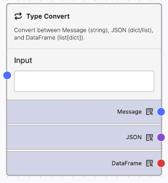

Type Convert
The Type Convert node transforms data between message to string, JSON to dictionary or list, and dataframe to list of dictionaries for use by downstream nodes that require a specific structural type. It outputs all three types simultaneously, allowing downstream nodes to use whichever type they require.
Type Convert node supports robust JSON parsing from text:
- Detects and extracts the first valid JSON object or array found within the text (such as from code blocks or mixed content).
- Recursively parses nested JSON strings (for example, JSON fields that contain JSON data) to generate a structured output.
When to use?
- When downstream nodes require a specific data type:
- Parser: Accepts JSON or DataFrame
- Combine JSON: Accepts JSON only
- LLM/Prompt/Chat: Requires Message format
- To standardize mixed input formats received from APIs, tools, or earlier steps
- Drag and drop a Type Convert node from the Processing category.
- Connect any of Message, JSON, or DataFrame from the upstream node as input.
- Test the Type Convert node by connecting the output(s) - string, dictionary, or list of dictinories to appropriate downstream node(s). Execute the flow by selecting Playground.
Conversion Examples:
Input: “Hello” Outputs: Message - “Hello”, JSON - {“value”:”Hello”}, DataFrame - [{“value”:”Hello”}]
Input: ‘{“id”:1,”text”:”Hi”}’ Outputs: Message - string, JSON - {“id”:1,”text”:”Hi”}, DataFrame - [{“id”:1,”text”:”Hi”}]
Input: ‘[{“id”:1},{“id”:2}] Outputs: Message - string, JSON - [{“id”:1},{“id”:2}], DataFrame - [{“id”:1},{“id”:2}]
Inputs: Message, JSON, or DataFrame
Outputs (provided simultaneously):
- String for Message. JSON string for JSON objects/arrays
dictorlist(Union[Dict,List]) suitable for Parser or Combine JSON Datalist[dict]for table‑like flows
For example flows that use the Type Convert node together with the Parser and Combine JSON Data nodes, see Example Flows Using Combine JSON Data and Example Flow Using Parser.
- Use this node before Parser or Combine JSON to ensure the data is correctly formatted as JSON.
- If you expect arrays, check that the DataFrame output is a list of dictionaries (
list[dict]). - Keep the Message output concise if it will be used as input for prompts.

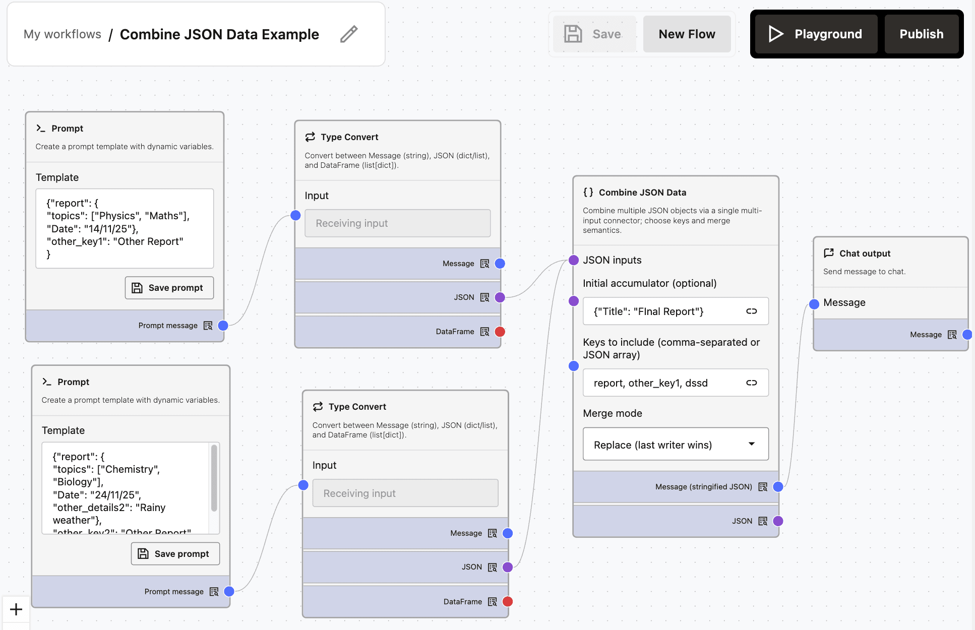

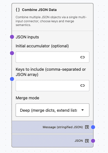

Combine JSON Data
The Combine JSON Data node merges multiple JSON payloads into a single object. It allows you to filter top-level keys and define how to resolve conflicts between keys. The node outputs both a JSON object and a Message containing the stringified JSON.
When to use?
- Combine results from multiple APIs or queries.
- Create a single JSON payload for downstream processing.
Drag and drop a *Combine JSON Data** node from the Processing category.
Connect one or more upstream JSON sources to the JSON inputs inlet.
Optionally, connect the output of a previous Combine JSON node to the Initial accumulator field for multi-stage merging. Leave it empty for a filter-only operation.
Input the top-level keys to include from input sources in the Keys to include field. Supported formats are a JSON array or a comma-separated list:
["a","b"],a, b, ora b. Leave it empty to include all the top-level keys. -
Select the Merge mode from Deep or Replace. Use Deep merge to recursively extend lists, replace scalars, and combine keys from all JSONs. Use Replace mode to overwrite keys with values from the JSON of the last connected node to the JSON inputs inlet.
Test the Combine JSON node by connecting two or more JSON inputs to the JSON inlet and the stringified JSON or merged dictorionary JSON to a chat output node. Execute the flow by selecting Playground, typing a space in the Chat input, and pressing Enter.
Inputs: Multiple JSON or Message-with-JSON
Outputs:
- JSON: A merged object suitable for downstream nodes.
- Message: A stringified JSON for display or logging purposes.

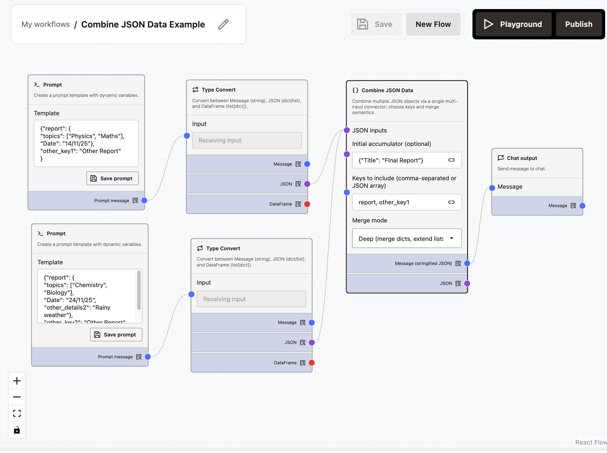

Example Flows
Example 1: Using the Combine JSON Data Component in Deep Merge Mode:
The output JSON {"Title": "Final Report", "report": {"topics": ["Physics", "Maths", "Chemistry", "Biology"], "Date": "24/11/25", "other_details2": "Rainy weather"}, "other_key1": "Other Report"} includes only the keys specified in the ‘Keys to include’ field (report and other_key1) of the Combine JSON Data node. In Deep Merge mode, list values are combined for matching keys (key=topics), whereas scalar values (key=Date) are replaced.
The Initial Accumulator can be any JSON, with or without keys that overlap with the incoming JSONs and will appear in the final JSON output. Any matching key in the Initial Accumulator will be replaced by the incoming value in the final JSON output. In this example, the Initial Accumulator is {“Title”: “Final Report”}.
Example 2: Using the Combine JSON Data Component in Replace Merge Mode:
The output JSON {"Title": "Final Report", "report": {"topics": ["Chemistry", "Biology"], "Date": "24/11/25", "other_details2": "Rainy weather"}, "other_key1": "Other Report"} includes the keys that were entered in the ‘Keys to include’ field (report and other_key1) of the Combine JSON Data Node. In Replace Merge mode, all the values for the same keys (key=topics) are replaced. The key value from the last input replaces the previous key values, so nodes connected later to Combine JSON Data overwrite those connected earlier.
The Initial Accumulator can be any JSON, with or without keys that overlap with the incoming JSONs and will appear in the final JSON output. Any matching key in the Initial Accumulator will be replaced by the incoming value in the final JSON output. In this example, the Initial Accumulator is {"Title": "Final Report"}.

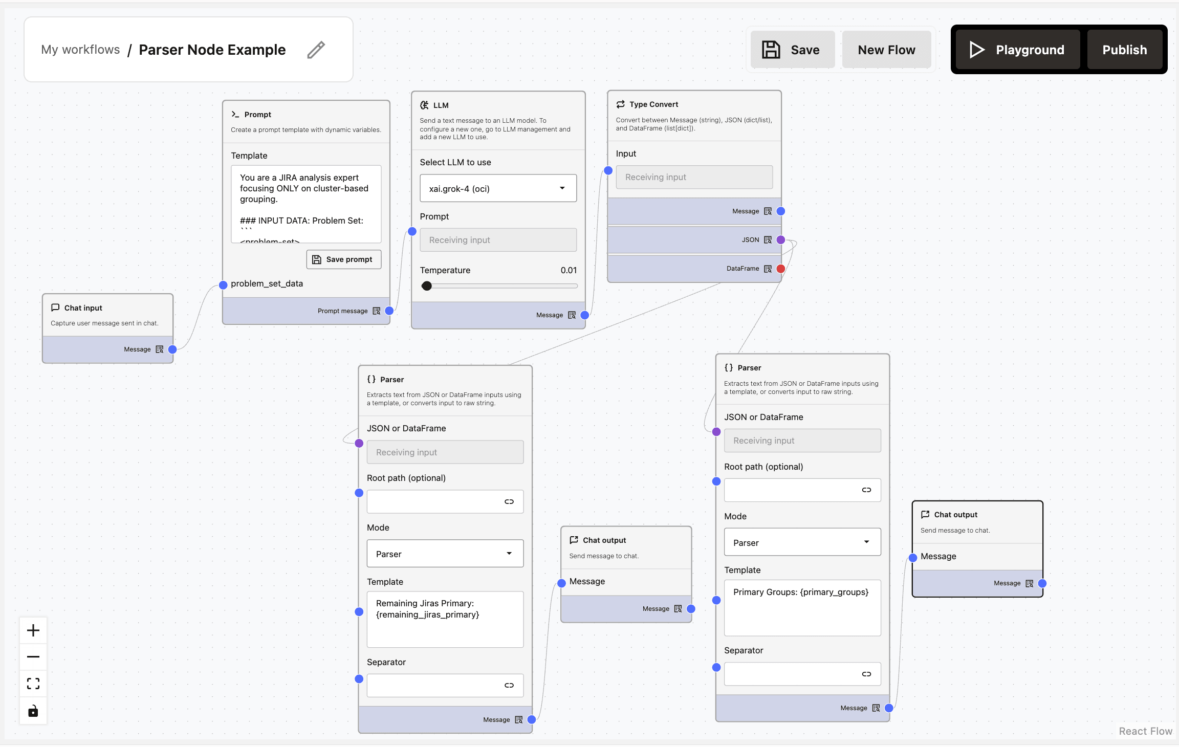

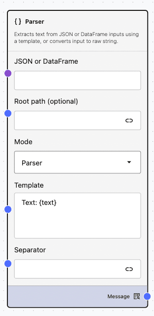

Parser
The Parser node extracts, formats, and combines text from structured inputs, such as JSON or DataFrame. It transforms these inputs into a clean, readable message output that can be displayed or passed to downstream steps.
When to use?
- Convert SQL or API results into easily readable messages.
- Create lists from arrays, such as orders, tickets, or products.
- Quickly convert JSON to a string format for logging or debugging.
Drag and drop a Parser node from the Processing category .
Connect JSON or Message outputs from upstream nodes to the JSON or DataFrame inlet. Alternatively, input a JSON in the text box.
Input an optional dot-path in the Root path field to navigate into the input before applying template. Examples: records, records.0, outer.inner.items.
Select Mode from Parser or Stringify. The parser mode applies the template to each of the selected items or objects. The stringify mode ignores template and converts the selection(s) to a raw string.
Input Template for parser mode as a format string with placeholders referencing keys or columns from objects, or {text} for entire string inputs.
Examples:
- Name: {name}, Age: {age}
- {PRODUCT_ID}: {PRODUCT_NAME} — stock {STOCK_QUANTITY}
- Text: {text}
Enter a Separator which is a string used to join multiple rendered items when the input is a list. Default is
\n. -
Test the Parser node by connecting a JSON input to its JSON inlet and routing the output message to a chat output node. Execute the flow by selecting Playground.
Inputs: JSON or DataFrame
Outputs: Message containing the final rendered text

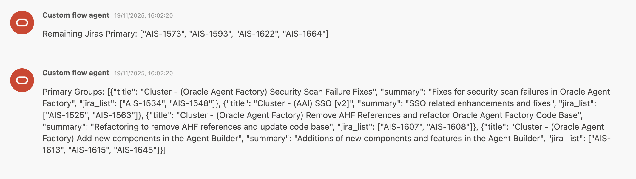

Example Flow
Below flow demonstrates grouping the Jira issues into a ‘Primary Group’ and storing the remaining Jira issues as ‘Remaining Jiras Primary’.
Using the following prompt, the LLM will generate a JSON with two keys - primary_groups and remaining_jiras_primary.
You are a JIRA analysis expert focusing ONLY on cluster-based grouping.
INPUT DATA: Problem Set:
<problem-set>
{{problem_set_data}}
</problem-set>
TASK: Group JIRAs based ONLY on cluster IDs.
STRICT RULES:
ONLY group by cluster ID matches
MANDATORY : EXACT cluster ID should match
MANDATORY : Each group MUST have minimum 2 JIRAs in the jira_list
If a group has fewer than 2 JIRAs, dissolve that group and ALL JIRAs from that group MUST be moved to remaining_jiras_primary
Order JIRAs chronologically within groups
DO NOT group by any other attributes
NO partial matches allowed
NO inferred relationships
VERIFY all groups meet the minimum 2 JIRAs requirement BEFORE outputting
DO NOT explain your reasoning or corrections
DO NOT output any intermediate results
MANDATORY: Use double quotes for ALL strings in JSON (not single quotes)
MANDATORY: Do NOT add “JIRA” prefix to any ID - use the exact ID format from the input data
OUTPUT FORMAT:
"primary_groups": [
"title": "Cluster - <Full Cluster ID>",
"summary": "Clear description of cluster impact",
"jira_list": ["EXACSOPS-1", "EXACSOPS2-2"]
"remaining_jiras_primary": ["EXACSOPS-3", "EXACSOPS-4"]
CRITICAL INSTRUCTION: Return ONLY the final VALID JSON with proper double quotes for all strings. Do not include ANY explanations, reasoning, comments, corrections, or text of any kind outside the JSON structure. The response must begin with {{ and end with }} without any other characters.
Now, if you want to send the data in primary_groups directly for review and route remaining_jiras_primary through another round of analysis, you can use Parser nodes to parse the JSON generated by the LLM and extract data from two keys. This requires two Parser nodes. Select Playground to execute the flow.
You can use the two outputs from the two Parser nodes for different purposes in a complex workflow.
