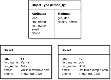

Figure 1-1 shows an object type, person_typ, and two instances of the object type.
Figure 1-1 Object Type and Object Instances
Description of Figure 1-1 follows
Description of "Figure 1-1 Object Type and Object Instances"
Object types serve as blueprints or templates that define both structure and behavior. Object types are database schema objects, subject to the same kinds of administrative control as other schema objects. Application code can retrieve and manipulate these objects. See Managing Oracle Objects.
