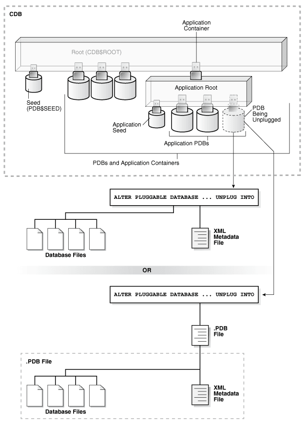

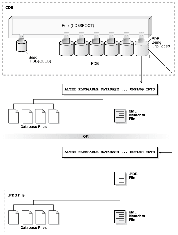

To unplug a PDB, connect to its CDB root or application root and use the ALTER PLUGGABLE DATABASE statement to specify either of the following:
XML file
An XML file (.xml extension) contains metadata about the PDB after it is unplugged. This metadata contains the required information to enable a
CREATE PLUGGABLE DATABASEstatement on a target CDB to plug in the PDB. -
.pdb file
A .pdb file contains a compressed archive of the XML file that describes the PDB and the files used by the PDB (such as the data files and wallet file). A .pdb file enables you to copy a single, compressed file (instead of multiple files) to a new location to plug the PDB into a CDB.
The following illustration shows how this technique unplugs an application PDB from an application container.
