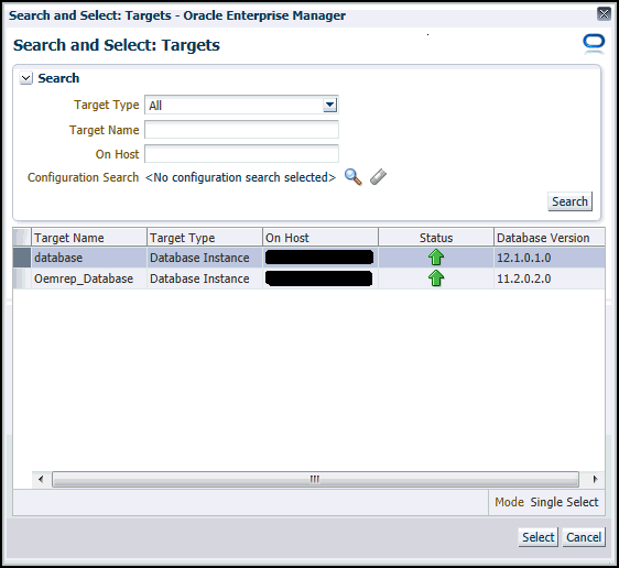

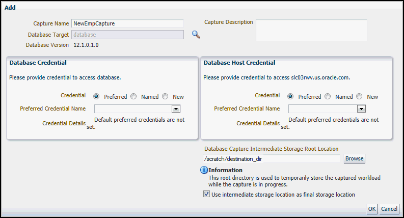

  5. Provide a capture name, provide an optional description, then click the Target Database search icon.
    The Search and Select: Targets pop-up appears.
  6. Select a Target Type, optionally provide a configuration search, choose a target database from the list, then click Select.
    The Add pop-up reappears with added sections for Database Credential and Database Host Credential.
  7. Provide database credentials, database host credentials, a Database Capture Intermediate Storage Location, then click OK.
    • After the Capture, the files are copied to the storage location, unless you use the intermediate storage location as the final storage location.
      For captures on an Oracle RAC database, Enterprise Manager only supports Oracle RAC configured with a shared file system.
    The selected target database now appears in the list of databases in the Select Production Databases table.

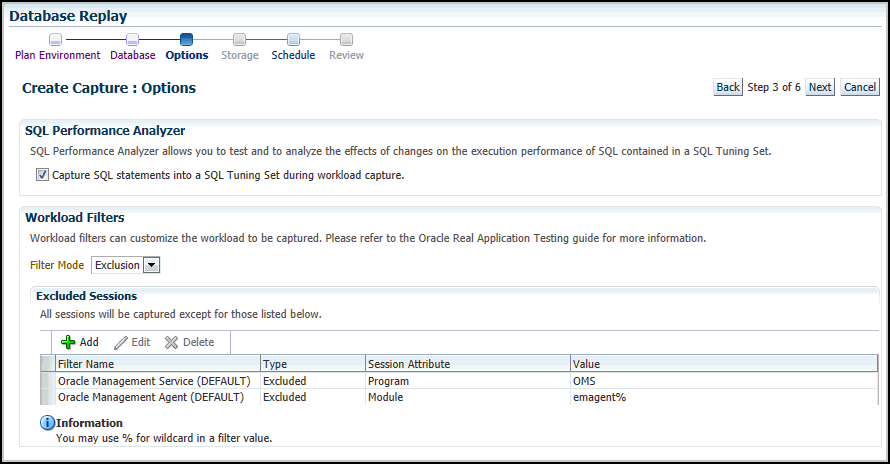

  9. Select the workload capture options:
    • Under the SQL Performance Analyzer section, select whether to capture SQL statements into a SQL tuning set during workload capture.
      While Database Replay provides an analysis of how a change affects your entire system, you can use a SQL tuning set in conjunction with the SQL Performance Analyzer to gain a more SQL-centric analysis of how the change affects SQL statements and execution plans.
      By capturing a SQL tuning set during workload capture and another SQL tuning set during workload replay, you can use the SQL Performance Analyzer to compare these SQL tuning sets to each other without having to re-execute the SQL statements. This enables you to obtain a SQL Performance Analyzer report and compare the SQL performance, before and after changes, while running Database Replay.
      Capturing SQL statements into a SQL Tuning Set is the default, and is the recommended workload capture option. Capturing SQL statements into a SQL Tuning Set is not available for Oracle RAC.
      Tip:
      For information about comparing SQL tuning sets using SQL Performance Analyzer reports, see "Generating SQL Performance Analyzer Reports Using APIs".
    • Under the Workload Filters section, select whether to use exclusion filters by selecting Exclusion in the Filter Mode list, or inclusion filters by selecting Inclusion in the Filter Mode list.
      To add filters, click Add and enter the filter name, session attribute, and value in the corresponding fields.
      Tip:
      For more information, see "Using Filters with Workload Capture".
    After selecting the desired workload capture options, click Next.

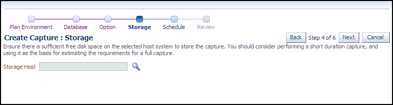

    The Create Capture: Storage page appears.
  10. Click the Storage Host icon, choose a target from the list, then click Select.
    The Storage page now requests Host Credentials and a Storage Location.
  11. Provide Host Credentials, click Browse to select a Storage Location, select the location and click OK, then click Next.

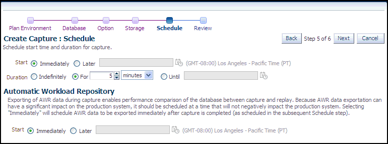

  12. Schedule the starting time and duration for the capture, schedule the exporting of AWR data, then click Next.
    • The default capture duration is 5 minutes. Change the capture duration to capture representative activity over a time period of interest that needs to be tested.

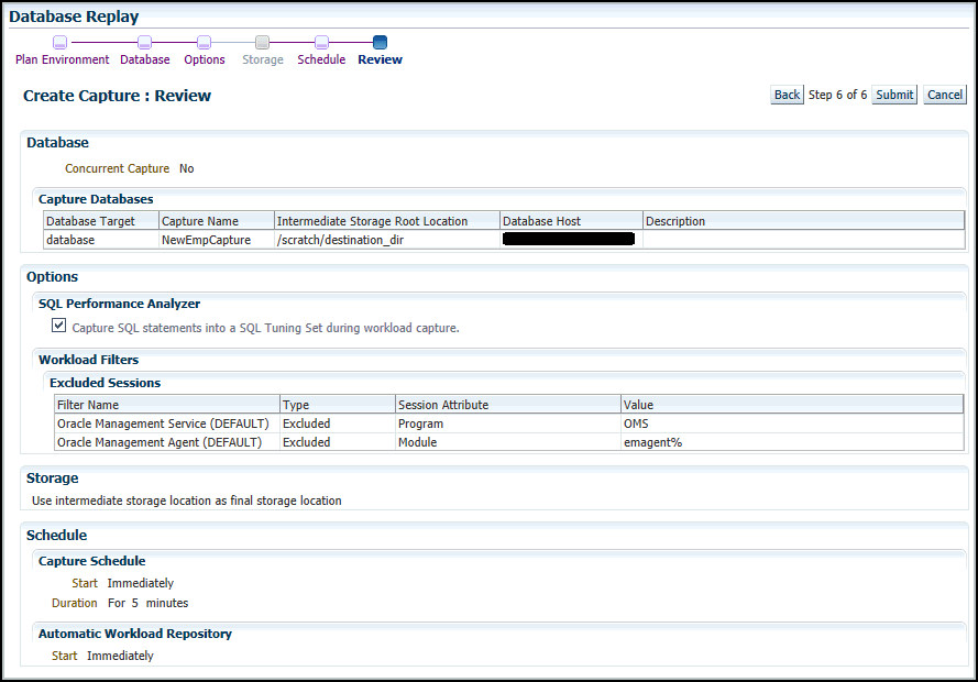

    The Create Capture: Review page appears.
  13. If all of the parameters appear as you have intended, click Submit to start the capture job.
    • The "Capture SQL statements into a SQL Tuning Set during workload capture" option is enabled by default. Uncheck this option if you do not want to compare SQL tuning sets at the end of the Replay.
    The Database Replay page reappears, displays a message that the capture was created successfully, and displays the status of the capture in the Captures list, such as "Scheduled."

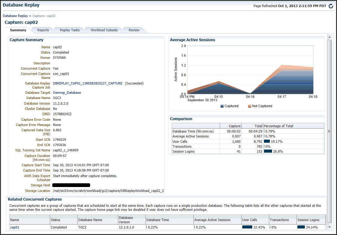

  14. For detailed information about the capture, double-click the name of the capture.
    The Capture Summary page appears, and displays several attributes, including the average active sessions, a workload comparison, and related concurrent captures, if any.
      Capturing SQL statements into a SQL tuning set is the default and recommended workload capture option.
  11. Provide Host Credentials, click Browse to select a Storage Location, then click Next.
  13. If all of the parameters appear as you have intended, click Submit to start the Capture job.
    The Capture Summary page appears, and displays several attributes, including the average active sessions, a workload comparison, and related concurrent captures.

  2. From the Captured Workloads tab of the Database Replay page for a capture that has a Status other than Completed, click the name of the desired capture from the Capture table.
    The Summary tab of the Database Replay page appears, showing detailed statistics, a chart for average active sessions that updates dynamically while the capture is in progress, a comparison of data for captured elements versus the same elements not captured, and related concurrent captures, if any.
    • The Not Captured data shown in the Active Average Sessions chart shows the database activity (database sessions) that is not being captured.
    • The values for the Total column in the Comparison section shows all of the captured and uncaptured activity in the database. Filtering, as determined by the Workload Filters you provided in the Options step of the Create Capture wizard, is primarily why some activity is captured or not. Additionally, background activities, database scheduler jobs, and unreplayable calls are not captured.
    • You can click the refresh icon in the upper right corner to update the capture while it is running.

  2. From the Capture Workloads tab of the Database Replay page, click the name of a capture that has a Status of Completed.
    The contents of the Summary tab of the Database Replay page appears as for a capture in progress, except the Average Active Sessions chart shows aggregated data for the capture time period, rather than dynamic data recorded during the capture.
    The Average Active Sessions chart provides a graphic display of the captured session activity compared to the uncaptured session activity (such as background activities or filtered sessions). This chart appears only when Active Session History (ASH) data is available for the capture period.
    Under Comparison, various statistics for the workload capture are displayed:
    • Capture column
      Displays the statistics for the captured session activity.
    • Total column
      Displays the statistics for the total session activity.
    • Percentage of Total column
      Displays the percentage of total session activity that has been captured in the workload.

  3. Click the search icon next to the Database Target field and select a database from the pop-up that appears.
    The target version of the database loading the workload must be at least as high as the one you used to capture the workload. For instance, if you captured using Oracle Database 12x, the database you select to read the Capture must be at least version 12x.
