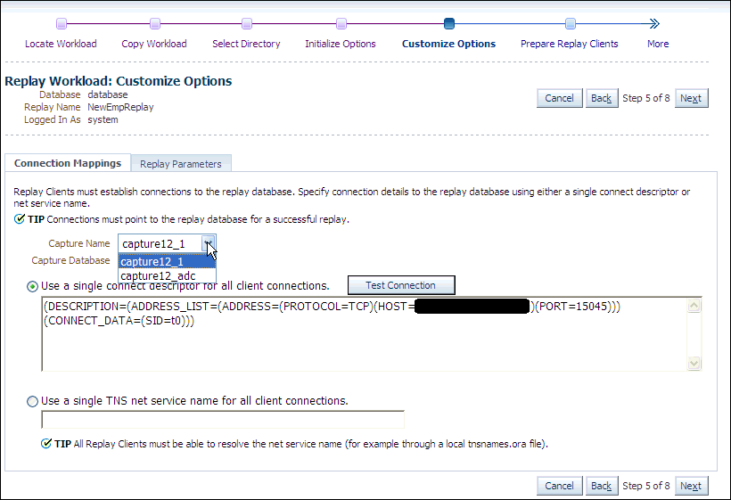

Connection Remapping
During workload capture, connection strings used to connect to the production system are captured. In order for the replay to succeed, you need to remap these connection strings to the replay system. The replay clients can then connect to the replay system using the remapped connections.
For Oracle Real Application Clusters (Oracle RAC) databases, you can map all connection strings to a load balancing connection string. This is especially useful if the number of nodes on the replay system is different from the capture system. Alternatively, if you want to direct workload to specific instances, you can use services or explicitly specify the instance identifier in the remapped connection strings.

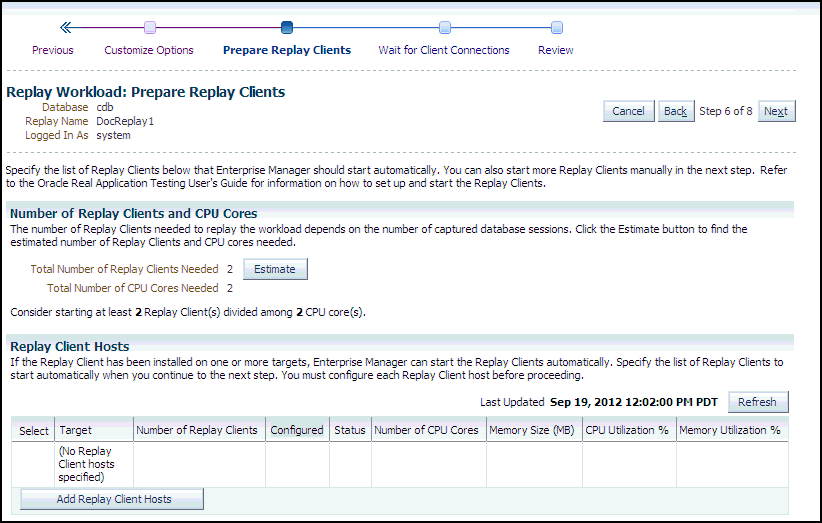

Setting Up Replay Clients
The replay client is a multithreaded program (an executable named wrc located in the $ORACLE_HOME/bin directory) where each thread submits a workload from a captured session. Before replay begins, the database will wait for replay clients to connect. At this point, you need to set up and start the replay clients, which will connect to the replay system and send requests based on what has been captured in the workload.

Calibrating Replay Clients
Since one replay client can initiate multiple sessions with the database, it is not necessary to start a replay client for each session that was captured. The number of replay clients that need to be started depends on the number of workload streams, the number of hosts, and the number of replay clients for each host.
To estimate the number of replay clients and hosts that are required to replay a particular workload, run the wrc executable in calibrate mode.
In calibrate mode, the wrc executable accepts the following keywords:
  • replaydir specifies the directory that contains the preprocessed workload capture you want to replay. If unspecified, it defaults to the current directory.
  • process_per_cpu specifies the maximum number of client processes that can run per CPU. The default value is 4.
  • threads_per_process specifies the maximum number of threads that can run within a client process. The default value is 50.
The following example shows how to run the wrc executable in calibrate mode:
%> wrc mode=calibrate replaydir=./replay
In this example, the wrc executable is executed to estimate the number of replay clients and hosts that are required to replay the workload capture stored in a subdirectory named replay under the current directory. In the following sample output, the recommendation is to use at least 21 replay clients divided among 6 CPUs:

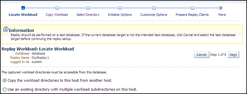

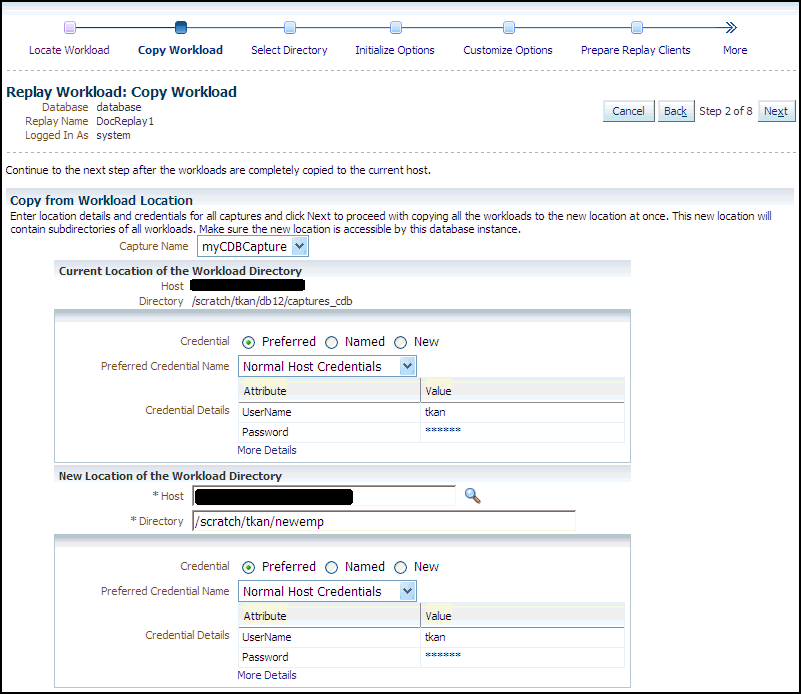

Replaying a Database Workload Using Enterprise Manager
This section describes how to replay a database workload using Enterprise Manager.
Before proceeding, you must already have created a replay task and created a replay from the replay task. To do this, see "Preparing a Single Database Workload Using Enterprise Manager".

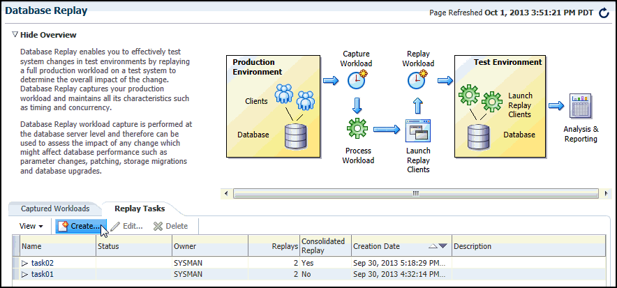

The primary tool for replaying database workloads is Oracle Enterprise Manager. If Oracle Enterprise Manager is unavailable, you can also replay database workloads using APIs, as described in "Replaying a Database Workload Using APIs".
To replay a database workload using Enterprise Manager:
  1. From the Targets menu of the Enterprise Manager Cloud Control console, select Databases. Then, from the Performance menu of the Databases page, select Database Replay.
    If the Database Login page appears, log in as a user with administrator privileges.
    The Database Replay page appears.

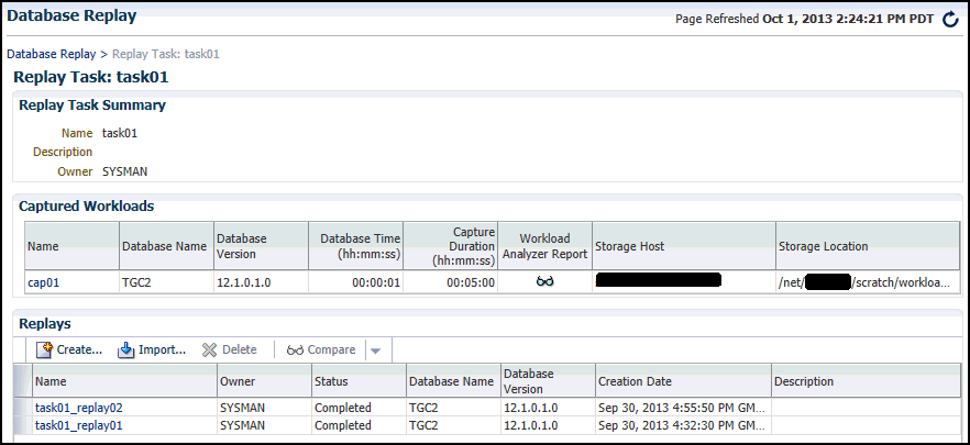

  2. Select the Replay Tasks tab, then click the link for the desired replay task in the table.
    The Replay Task page for the replay appears.
  3. Click Create in the Replays section to create the replay.
    The Create Replay pop-up appears.
  4. Provide a required Name and optional description, then click the Target Database icon.
    The Search and Select: Targets pop-up appears.
  5. Choose the appropriate database, then click Select.
  6. Click OK in the Create Replay pop-up.
    The Database Replay page for your replay appears, which includes a Task List with a link to perform the replay.
  7. Click the link for the Replay Workload task.
    The Replay Workload: Locate Workload page appears.
  8. Select the desired workload location option.
    If you have not previously copied the workload from its storage location to the replay location where the replay clients can access it, select the option to copy the workload. Otherwise, select the option to use the existing replay directory that contains the workload to be replayed.
    Click Next to display the Replay Workload: Copy Workload page.
  9. Provide the required credentials and the new location of the workload directory to which you want to copy the workload, then click Next.
    The system responds by displaying a progress bar graph during processing, then displays the Replay Workload: Select Directory page after the copy operation concludes.

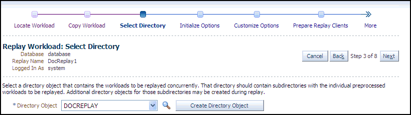

  10. Specify the Directory Object, or create a new Directory Object that points to the location that contains the workload. If you chose to copy from the workload location to a new location in the previous step, make sure that the directory object points to the exact location you specified in the New Location of the Workload Directory section.
    The system responds by displaying a Capture Summary. You can expand the Capture Details section to see the workload profile and workload filters. You can also generate a Workload Capture Analyzer Report and Database Capture Report. The Capture Summary does not appear for consolidated replays.

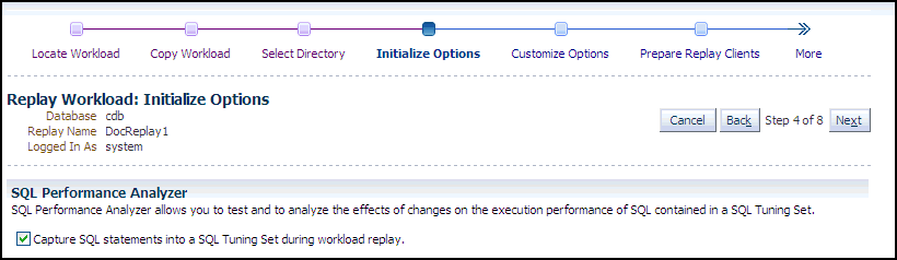

  11. In the SQL Performance Analyzer section, retain or disable the Capture SQL Statements option, which is enabled by default and recommended. You can disable this option if you do not want to compare SQL tuning sets at the end of the replay.
    • The SQL Performance Analyzer can initiate an impact analysis of environmental changes on the performance of SQL statements within a SQL Tuning Set. You can create and analyze SQL Performance Analyzer tasks to test the effects of a database upgrade, initialization parameter change, Exadata simulation, or custom experiments. A task compares the effects of before-trial changes with after-trial changes.
      Although Database Replay provides an analysis of how a change affects your entire system, you can use a SQL tuning set in conjunction with the SQL Performance Analyzer to gain a more SQL-centric analysis of how the change affects SQL statements and execution plans.
      By capturing a SQL tuning set during workload replay, you can use SQL Performance Analyzer to compare this SQL tuning set to another SQL tuning set captured during workload capture, without having to re-execute the SQL statements. This enables you to obtain a SQL Performance Analyzer report and compare the SQL performance, before and after change, while running Database Replay.

  12. Remap captured connection strings to connection strings that point to the replay system. Note that you need to remap each capture connection. For example, in the illustration above, you would need to remap the connection for both capture12_1 and capture12_adc.
    (You can remap connections per workload for consolidated replay. There is a Capture Name drop-down to choose the workload.)
    Click the Connection Mappings tab. There are several methods you can use to remap captured connection strings. You can choose to:
    • Use a single connect descriptor for all client connections by selecting this option and entering the connect descriptor you want to use. The connect descriptor should point to the replay system.
      To test the connection, click Test Connection. If the connect descriptor is valid, an Information message is displayed to inform you that the connection was successful.
    • Use a single TNS net service name for all client connections by selecting this option and entering the net service name you want to use. All replay clients must be able to resolve the net service name, which can be done using a local tnsnames.ora file.
    • Use a separate connect descriptor or net service name for each client connect descriptor captured in the workload by selecting this option and, for each capture system value, entering a corresponding replay system value that the replay client will be use. If you selected the "Use replay options from a previous replay" option in the Initialize Options step, the "Use a separate connect descriptor" option is selected, and the previous replay system values appear in the text field below.
      This option does not apply to consolidated replays.

  14. Ensure that the replay clients are prepared for replay:
    Before proceeding, the replay clients must be set up.
    1. Click Estimate to determine how many replay clients and CPUs are required for the replay.
    2. Click Add Replay Client Hosts to add a host or hosts for the replay clients. (If you do not want to add any replay client hosts, you can still continue and start the replay clients from the command line outside of Enterprise Manager).
      The Search and Select: Replay Client Host pop-up appears.
      • Specify a Target Name and then click Go, or just click Go to display the entire list of available hosts.
      • Choose a host and then click Select.
    3. When the host name appears in the Target column of the Replay Client Hosts table, specify the number of replay clients recommended from the estimate results, then make sure that the number of CPUs listed for the host satisfies the minimum recommendation in the estimate results. You should start at least one replay client per captured workload.
    4. In the Configured column, click the No link to configure the replay client host in the pop-up that appears.
    5. Click Apply after you have finished providing input in the pop-up. The Configured column now displays Yes in the Replay Client Hosts table.

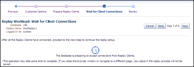

  15. Click Next to start the replay clients and display the Replay Workload: Wait for Client Connections page.
    If you have reached this step in the process from the Enterprise menu, you also need to enter credentials for the replay job and for the replay result storage host.
    • As replay clients are started, the replay client connections are displayed in the Client Connections table.
    • The text below the clock changes if a replay client is connected.
    • The Client Connections table is populated when at least one replay client is connected.
    When all replay clients have connected, enter host credentials at the bottom of the page to start the replay job, then click Next to display the Replay Workload: Review page.

Setting Up the Replay Schedule and Parameters Using Enterprise Manager
The replay schedule feature enables you to scale up the instances of captured workloads to be included in a consolidated replay, and then control the relative playback scheduling of the instances within the replay. The relative scheduling of the captured workload instances is visually displayed by updating the alignment of the active session chart for each instance.
This feature is available for Cloud Control Database plug-in 12.1.0.5 and later releases.

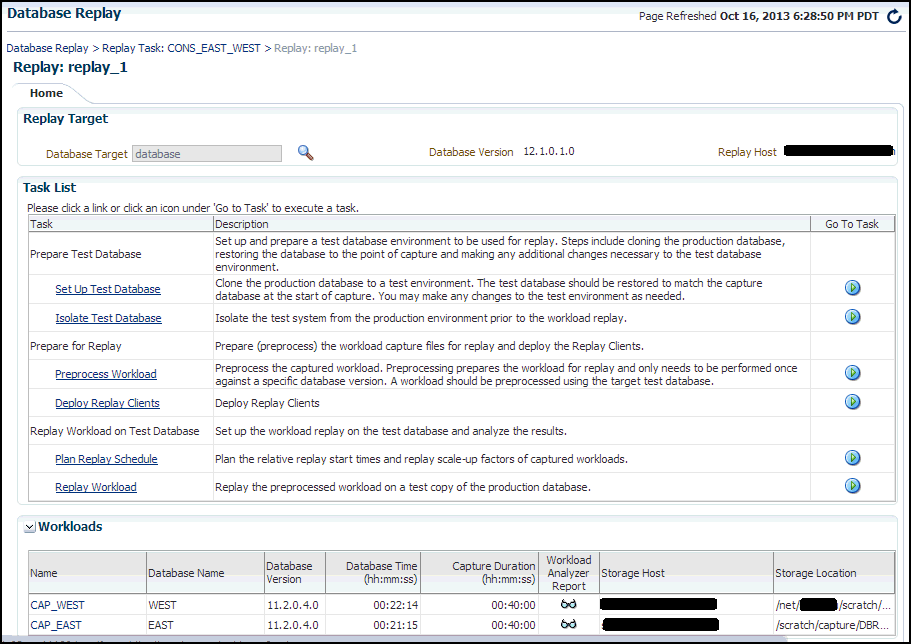

  1. From the Database Replay home page, click on the Replay Tasks tab.
  2. Click on the name of an existing replay task with more than one workload to navigate to the Replay Task page.
  3. Click Create to create a new replay.
  4. Provide the requisite information in the Create Replay pop-up, then click OK.
    The new replay appears in the Replays table.
  5. Click the name of your new replay in the Replays table.
    A Task List now appears in the Replay page.
  6. Click the Plan Replay Schedule link.
    The Plan Replay Schedule page appears.

  1. From the Database Replay page, click the Replay Tasks tab.
  2. Click the name of the replay task that contains the replay for which you want to monitor replay progress.
  3. From the Replays section of the Replay Task page, click the name of the replay you have submitted for processing in the Create Replay wizard. (The Status column for this replay should show In Progress.)
    The Home tab of the Database Replay page appears, and the Replay Summary shows a Status of Running.

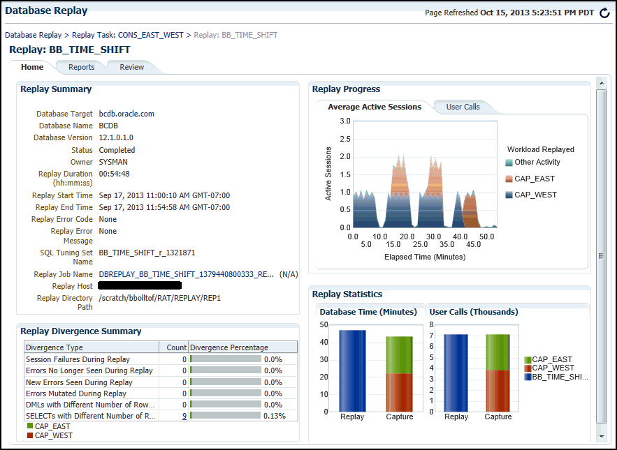

    The Home tab of the Database Replay page appears, and the Replay Summary shows a Status of Completed.
    • The replay line in the User Calls chart graphically represents the replay progress during the course of the entire replay from initiation to conclusion.
      The chart shows how much time it has taken to replay the same workload compared to the elapsed time during the workload capture in terms of user calls. If the Replay line is above or to the left of the Capture line, the replay system is processing the workload faster than the capture system.
    • Under the Replay Divergence Summary, any errors and data discrepancies between the replay system and the capture system are displayed as diverged database calls during replay. You can use the percentage of total calls that diverged as a measure of the replay quality.
      To view details about the diverged calls, click the link that corresponds to the type of diverged call in the Count column to access the Diverged Calls During Replay page. The Diverged Calls During Replay page shows the most relevant set of replayed calls that diverged from the workload captured by grouping them based on common attribute values and specified filter conditions. To view details about a particular diverged call—such as the call attributes, SQL text, and bind variables—click the corresponding link in the SQL ID column to bring up the Replay Diverged Statement page.
  4. To return to the Database Replay page, click the Database Replay breadcrumb.

  1. From the Database Replay page, click the Replay Tasks tab, then select the desired replay task.
    The Replay Task page appears.
  2. Click Import in the Replays section.
    The Import Replay: Source page appears
  3. Select one of the three choices available to import a replay, then click Next.

    • The capture_sts parameter specifies whether to capture a SQL tuning set in parallel with the workload replay. If this parameter is set to TRUE, you can capture a SQL tuning set during workload replay and use SQL Performance Analyzer to compare it to another SQL tuning set without having to re-execute the SQL statements. This enables you to obtain a SQL Performance Analyzer report and compare the SQL performance—before and after the change—while running Database Replay. You can also export the resulting SQL tuning set with its AWR data using the EXPORT_AWR procedure, as described in "Exporting AWR Data for Workload Replay".
      This feature is not supported for Oracle RAC. Workload replay filters that are defined using DBMS_WORKLOAD_REPLAY do not apply to the SQL tuning set capture. The default value for this parameter is FALSE.
