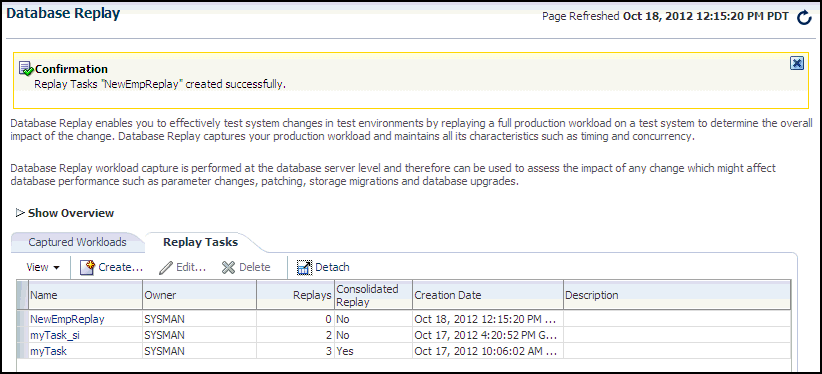

To create a database replay task:

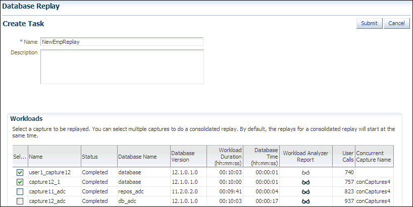

  1. From the Database Replay page, click the Replay Tasks tab, then click Create in the toolbar.
    The Create Task page appears.
  2. Provide a Name for the task, select a capture to be replayed, then click Submit. For consolidated replays, select two or more captures.
    The Database Replay page reappears, and displays your newly created replay task in the table under the Replay Task tab.

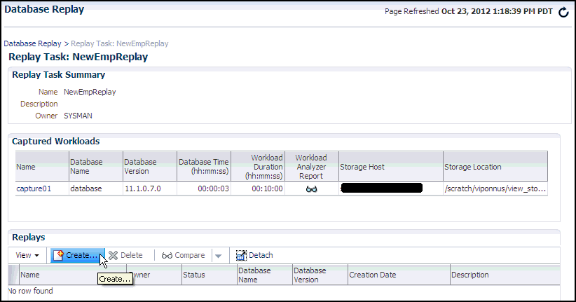

  1. From the Database Replay page, click the Replay Tasks tab.
  2. Click the link for the desired replay task in the table.
    The Replay Task page for the capture appears.
  3. Click Create in the Replays section.
    The Create Replay pop-up appears.

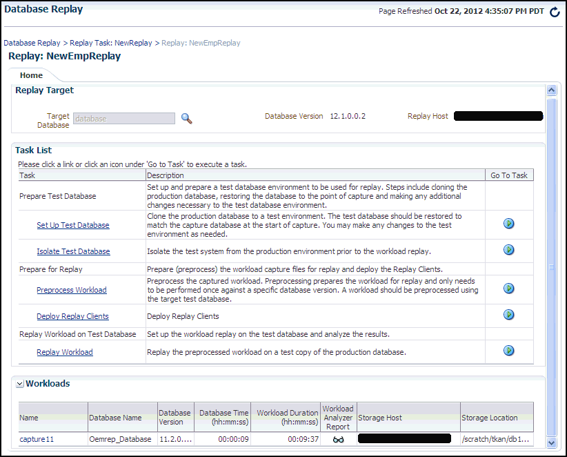

    The Database Replay page for your replay appears, which includes a Task List with links to perform the needed tasks.
You can now proceed to the first task in the Task List, described in the next section.

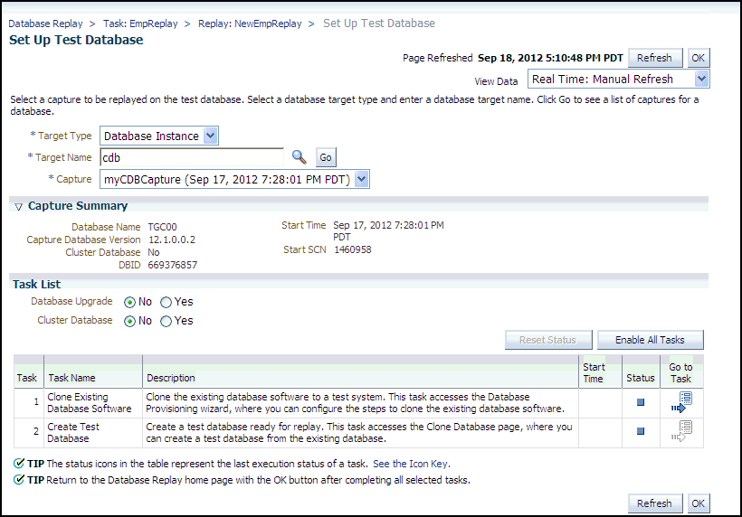

To set up the test database:
  1. From the Replay page for your particular replay, click the link for the Set Up Test Database task.
    The Set Up Test Database page appears.
  2. Choose whether you want to upgrade the database or not, and indicate whether this is a cluster database.
  3. Click the Go to Task icon for the Clone Existing Database Software sub-task, or click Enable All Tasks if you want to create the test database first.
  4. Follow the instructions provided in the online help for the wizards.
    When the tasks are complete, a checkmark appears in the Status column for each task.
  5. Click OK to return to the Database Replay page.

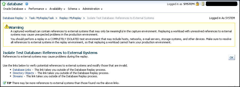

To isolate the test database:
  1. From the Replay page for your particular replay, click the link for the Isolate Test Database task.
    A page appears explaining that references to external systems can cause problems during the replay.
  2. Use the links provided to verify potential references to external systems, modify those that are invalid, then click OK.
    The Replay Summary page reappears.
Preprocessing the Workload and Deploying the Replay Clients
The final preparation for the replay involves preprocessing the workload and deploying the replay clients. For example:
  • Preprocessing the workload
    You need to preprocess each captured workload once for each version of the database against which the workload will be replayed. After you preprocess the workload once, you can use it for any subsequent replay tasks and replays without needing to preprocess again, as long as the test database is the same version as the database where the workload was preprocessed.For instance, for a replay task that contains two replays named "MyReplay1" and "MyReplay2," after you have preprocessed "MyReplay1", you can just directly reuse the directory object to replay "MyReplay2."
    The Workload Analyzer report is available after preprocessing.
  • Deploying the replay clients
    You do not need to deploy the replay clients to other replay client hosts if these hosts can access the Oracle home of the test database you specified in the Database Target Name field.
The following procedures explain how to accomplish each of these tasks.

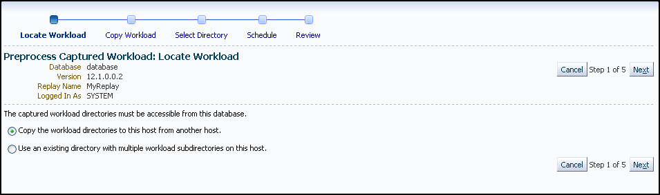

  1. From the Replay page for your particular replay, click the link for the Preprocess Workload task.
    The Preprocess Captured Workload: Locate Workload page appears.
  2. Select the desired workload location option, then click Next.
    You initially need to select the copy option.

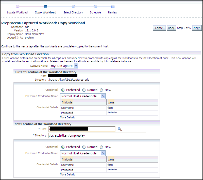

    The Preprocess Captured Workload: Copy Workload page appears.
  3. Provide the required credentials and the new location to which the workloads will be copied and preprocessed, then click Next.

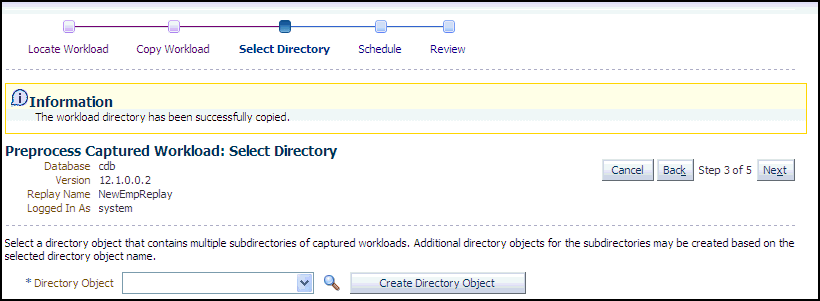

    The system responds by displaying a progress bar graph during processing, then displays the Preprocess Captured Workload: Select Directory page after the copy operation concludes.
  4. Specify the Directory Object, or create a new Directory Object that points to the location that contains the workload. If you chose to copy from the workload location to a new location in the previous step, make sure that the directory object points to the exact location you specified in the New Location of the Workload Directory section.
    The system responds by displaying a Capture Summary. You can now expand the Capture Details section to see the workload profile and workload filters. The Capture Summary does not appear for consolidated replays.
    Click Next to display the Preprocess Captured Workload: Schedule page.

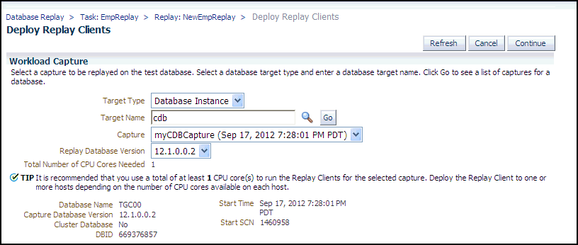

To deploy the replay clients:
  1. From the Replay page for your particular replay, click the link for the Deploy Replay Clients task.
    The Deploy Replay Clients page appears.
  2. Accept the default values defined for the associated workload capture, or override these values, then click Continue.
    The Provision Oracle Database Client wizard appears.
  3. Follow the instructions provided in the online help for each step of the wizard.
    After you click Submit in the Review step to run the deployment procedure according to the schedule you have set, the Replay Summary page reappears.
