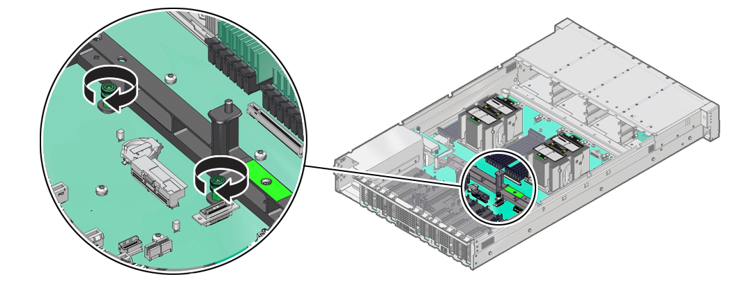

- Using a Torx T25 screwdriver, tighten the two captive screws to secure the
motherboard mid-wall to the chassis.

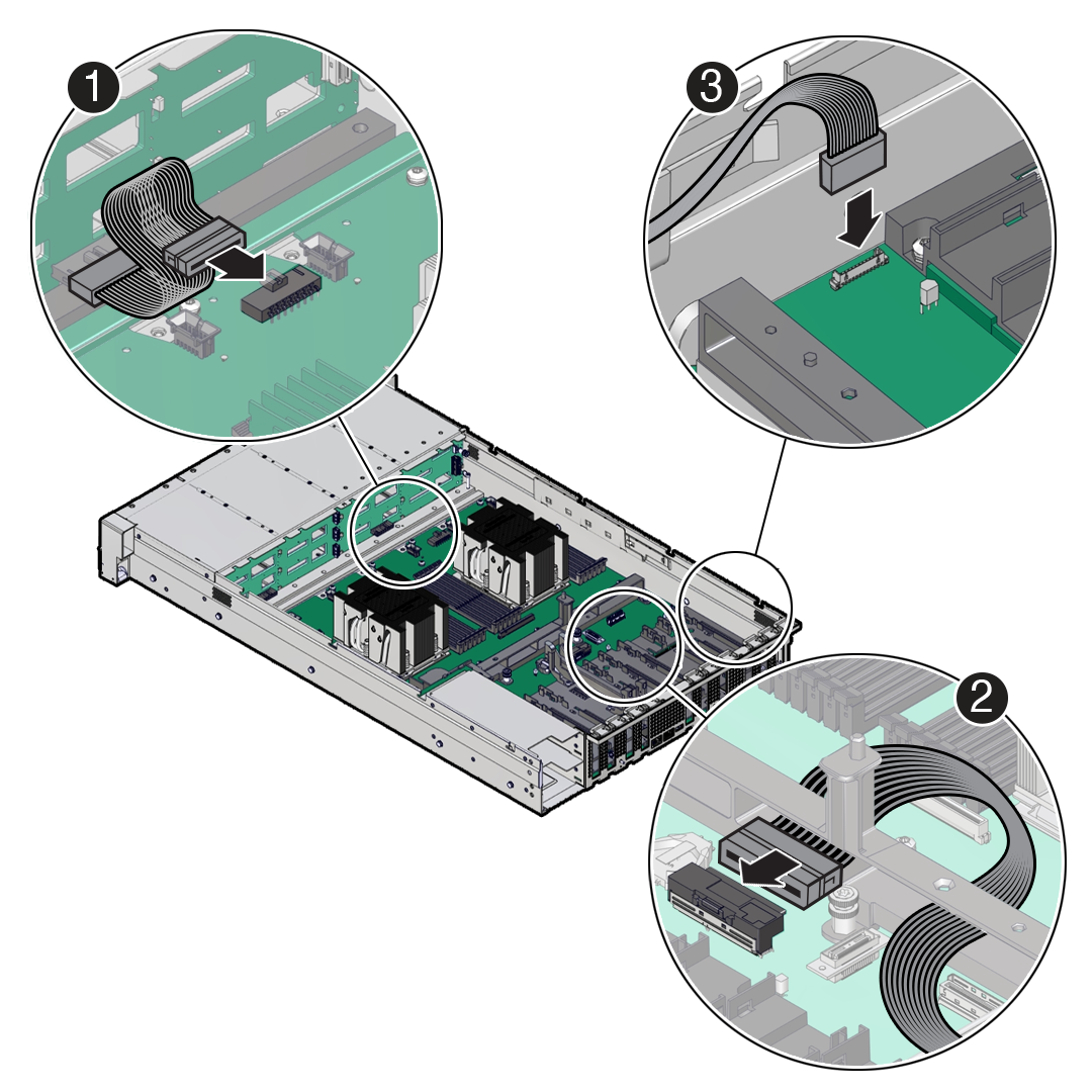

Reconnect the following cables to the motherboard:
Disk backplane power (DBP PWR) cable
Reconnect the power cable to the motherboard and the disk backplane. Reinstall the cable guide holding the cables
NVMe four-disk backplanes use single power cables. SAS twelve-disk backplanes use two power cables. -
Disk backplane auxiliary signal (DBP SIG) cable
Front LED indicator module (FIM) ribbon cable
Callout Description 1
2
3
