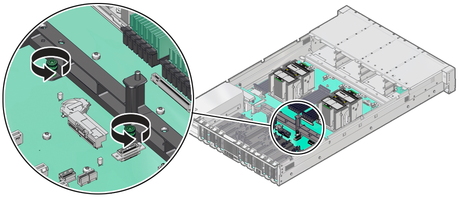

- Using a Torx T25 screwdriver, fully loosen the two captive screws that secure the
motherboard mid-wall to the chassis.
If you are not able to remove the motherboard, loosen the third screw in the midwall motherboard handle. After removing the motherboard, tighten the same screw.

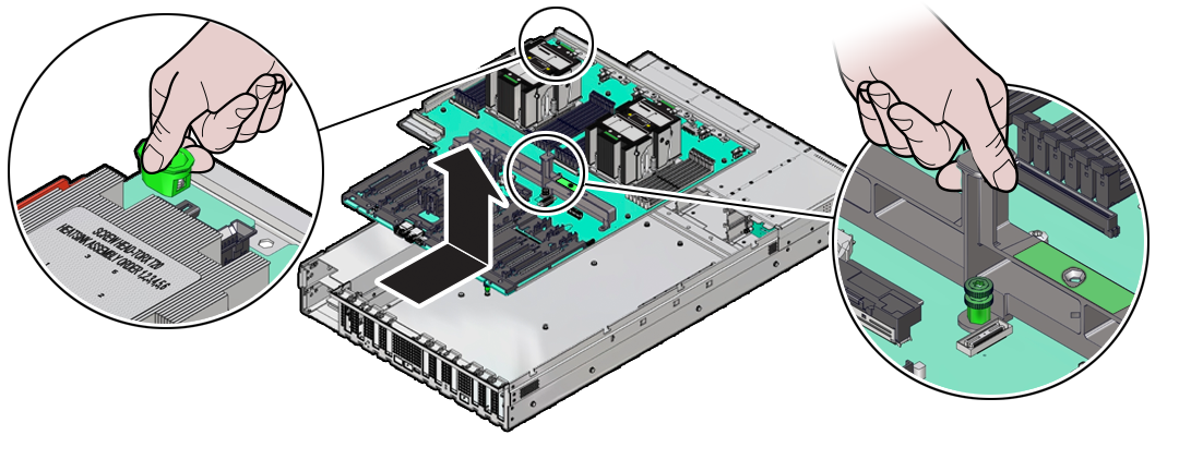

- With the server in the extended maintenance position, remove the motherboard from
the server with all reusable components that populate the motherboard in place.
Move all cables out of the way so they do not interfere with the procedure. Be careful not to damage or break off the rear Locate light pipe LED indicator.
- Grasp the midwall motherboard handle labeled MB Handle.
Hold the motherboard with the midwall motherboard handle and the small plastic motherboard handle.
- Carefully slide the motherboard forward, and while holding the motherboard
mid-wall handle and small plastic motherboard handle, lift it out of the
chassis.
- Place the motherboard assembly on an antistatic mat, and next to the replacement motherboard.

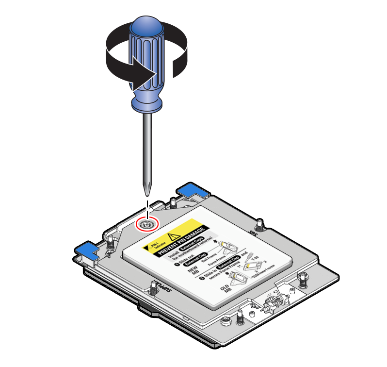

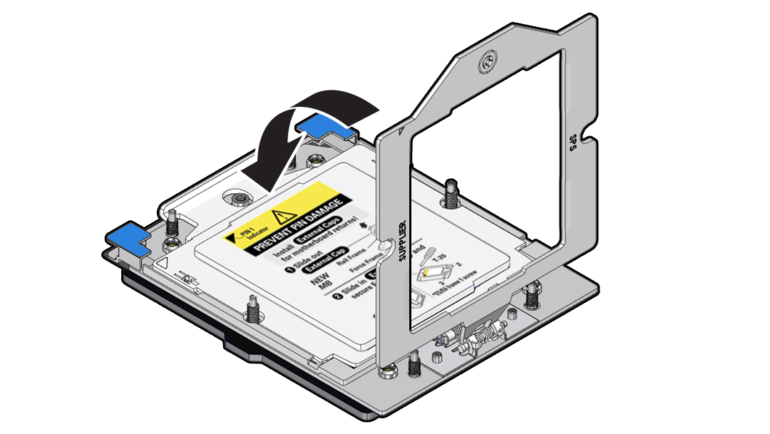

On the new replacement motherboard:- Unscrew the socket Force Frame.
Using a Torx T20 screwdriver, fully loosen the captive Force Frame Retention Screw that secures the Force Frame to the socket. Apply counter-pressure to the force frame when opening.
- Lift the force frame to the open position.

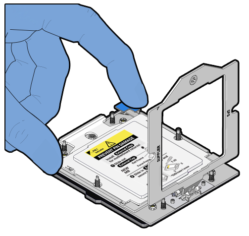

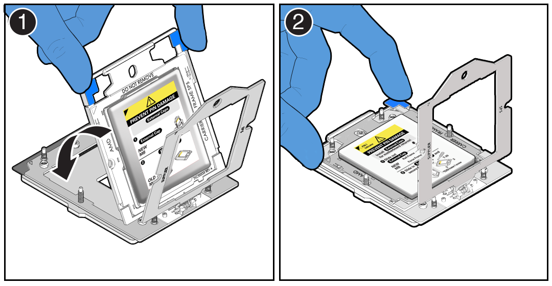

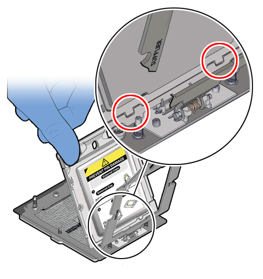

- On the socket, open the Rail Frame.
Squeeze the blue tabs to release the rail frame.
Lift the processor rail frame by holding its lift tabs and rotating the rail frame to its near vertical position.
The rail frame is spring-loaded. Hold on to the rail frame as it releases from the socket frame, when rotating it to the vertical position.

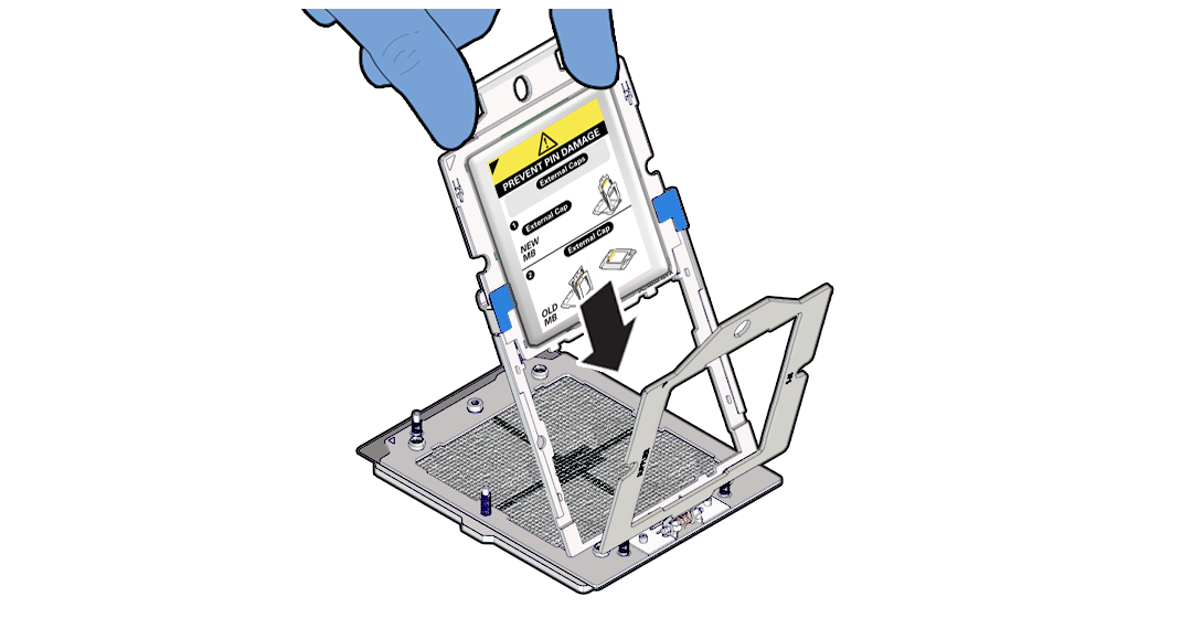

- Remove the External Cap by its handle.
Do not re-install the socket External Cap.
Caution:
Return the motherboard if the pins are damaged. The processor socket pins are very fragile. A light touch can bend the processor socket pins beyond repair.Holding the socket cover external cap by its handle, slide the External Cap up and out of the Rail Frame.
Retain the external cap to be placed on the processor socket (in the Rail Frame) of the motherboard being replaced. This will prevent damage during shipping back to the Service Center for motherboard failure analysis.

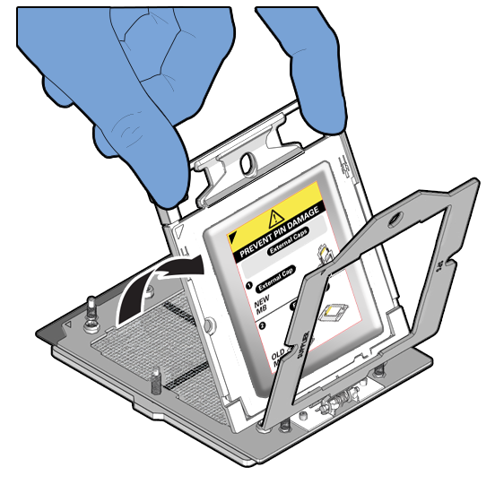

- Install an External Cap on a Processor 0 or Processor 1 socket for
motherboard returns. Install the protective lid by sliding it in the rail frame and pressing down.
Holding the External Cap you removed from the new motherboard by its handle, slide it into the processor rail frame on the old motherboard.
Slide the External Cap until the two insertion tabs at the bottom of the External Cap are inserted into the slots in the rail frame.
- Grasping the rail frame edge [1], rotate the rail frame to the closed
position [2].

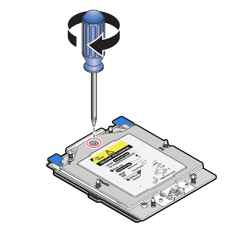

- Rotate the force frame to its closed position on the socket stiffener frame.
- Using a 12 in-lb (inch-pound) (1.35 Nm/13.5 kg-cm) driver with a Torx T20
bit, fully tighten the captive screw that secures the force frame to the socket
stiffener frame.
Use one hand to hold down the spring-loaded force frame until the screw is tightened.

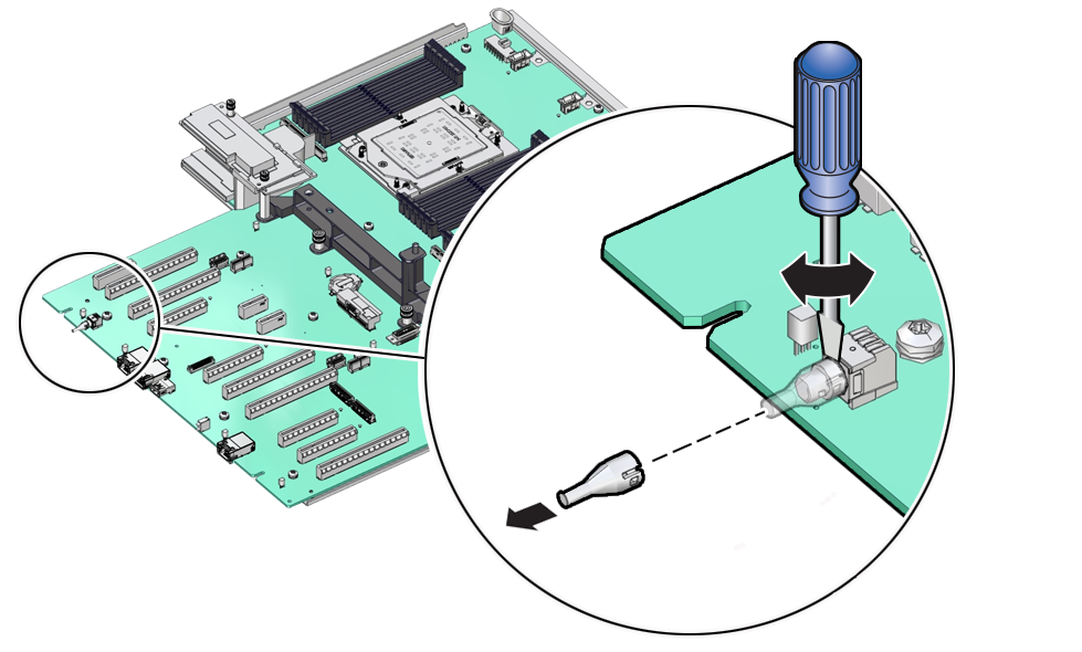

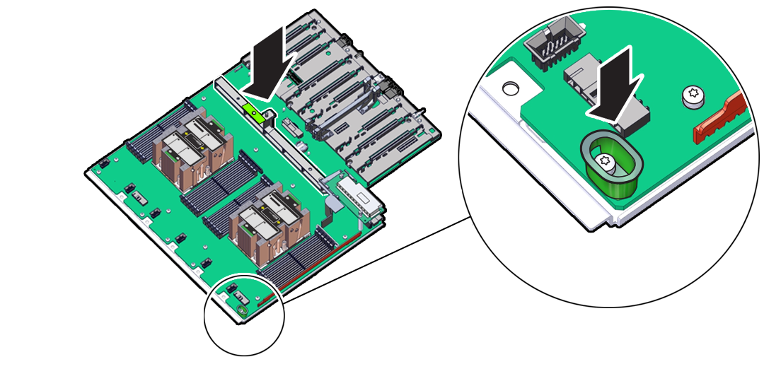

Check to see if the replacement motherboard has a locate light pipe installed.
If it does, no action is necessary.
If it does not, perform the following steps.
- Check to see if the replacement motherboard came with a light pipe. A
replacement light pipe would be in a separate plastic bag.
If you find a replacement light pipe, skip to Step 10.b.
If you do not find a replacement light pipe, perform the following steps to remove the light pipe from the faulty motherboard.
- Insert a flat tool such as a screwdriver or penknife blade
between the light pipe housing and the light pipe.
Caution:
Equipment damage. The light pipe is fragile. Handle it carefully.
- Twist the tool back and forth to release the light pipe from the housing.
- Pull the light pipe away from the housing.
Install the light pipe on the replacement motherboard.
- Match the rectangular holes on the outside of the light pipe
with the retaining clips on the housing.
- Push the light pipe onto the housing until the clips latch in the holes.
