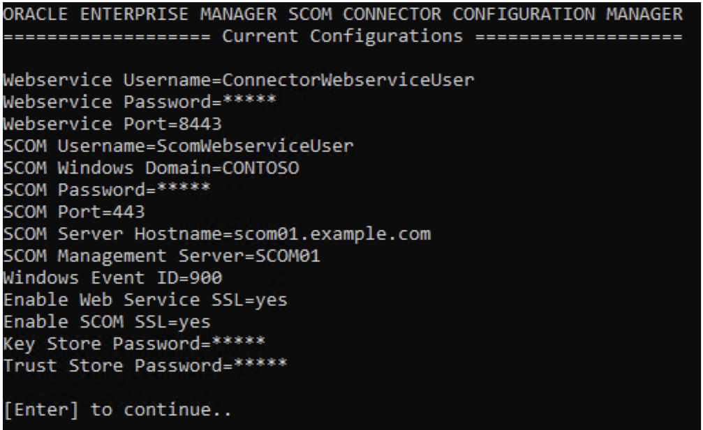

  5. On the main screen, select View current configurations to verify that the information provided is correct.
    Here's an example of the configuration:
    Event Connector Web Service Configuration
If any of the information is incorrect, select Update current configurations on the main screen. After verifying that the configuration details are correct, select Exit. You can modify the configuration at any time by executing the WebService.jar file with the -wsconfig flag. Note that if you forget or misplace the credentials created for the Event Connector Web Service, delete the configuration file at <ECWS_HOME>/config/WebServiceConfig.json and reconfigure the connector.

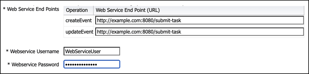

  3. From the Setup menu, select Extensibility, then select Management Connectors, and create a new SCOM REST Event Connector instance.
  4. On the configuration page, ensure that at least the following web service details are entered or updated:
    • In the createEvent and updateEvent fields, replace <hostname> with the resolvable host name that your Event Connector Web Service is running on.
    • In the createEvent and updateEvent fields, update the port number if you are not using the default 8080.
    • In the createEvent and updateEvent fields, replace http with https if secure communication is enabled.
    • Update the Webservice Username and Webservice Password with the credentials created for authenticating to the Event Connector Web Service.
    • Configure proxy settings only if using a proxy (optional).
    This configuration page information applies only to communication between Oracle Enterprise Manager and the Event Connector Web Service. These fields do not apply to communication between the Event Connector Web Service and the Microsoft SCOM Web Service.
    Here's an example that shows the minimal configuration requirements:
    Minimal Configuration Requirements
  5. Click OK to save the configuration.
