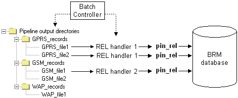

Figure 1-1 shows an example of three RE Loader batch handler and pin_rel utility processes running to load EDR files. Each utility loads one file into the BRM database:
Figure 1-1 Example of Three Batch Handlers and pin_rel Utilities
The following actions are performed when multiple RE Loader processes are configured:
  1. Batch Controller starts an RE Loader batch handler for each new file it detects in the output directory, up to the maximum number of RE Loader batch handler processes configured.
  2. Each RE Loader batch handler process starts an RE Loader utility process.
  3. The RE Loader utility processes the events in the file in three phases:
    • Preprocessing
    • Loading
    • Account balance, bill item, and journal updates
    During the loading phase, the database tables are locked so that only one RE Loader process can load events at one time.
  4. Each RE Loader process polls the other processes to see whether they are currently in the loading phase and waits its turn to load events. When the first process is loading, the second process performs prepreprocessing tasks while waiting its turn. When the first process finishes loading, the second process loads while the first process performs account balance, bill item, and journal updates for the events it loaded:
  5. When an RE Loader process has completed all three phases, it is free to process another file.
The files are loaded in sequence, one directory at a time. If the number of RE Loader processes is set to 3, only three handler processes can run at one time for all directories.
