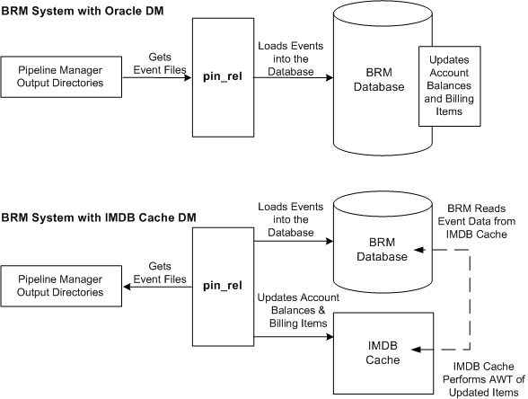

About Running RE Loader Manually with Pipeline Manager
When you run RE Loader manually from a command line, you specify the location of the pipeline output file in the command line.
Figure 6-1shows the RE Loader work flow when you run it manually from a command line:
Figure 6-1 Work Flow of Manual Execution of RE Loader
Description of Figure 6-1 follows
Description of "Figure 6-1 Work Flow of Manual Execution of RE Loader"

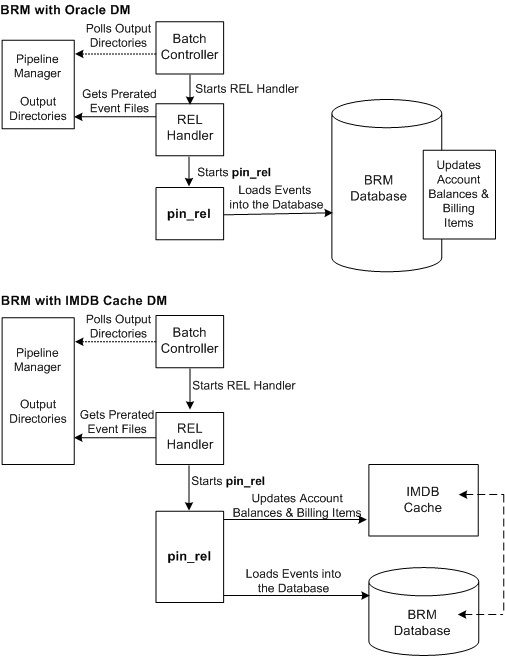

About Running RE Loader Automatically Using the Batch Controller with Pipeline Manager
To schedule RE Loader to run automatically, you must set up the following components:
  • Batch Controller, which detects when an EDR file is present in the pipeline output directory and starts the RE Loader batch handler.
  • RE Loader batch handler, which moves the EDR file from the pipeline output directory to the RE Loader processing directory and starts the RE Loader utility (pin_rel).
Figure 6-2 shows the RE Loader work flow when you schedule loading of events:
Figure 6-2 Workflow of Scheduled Execution of RE Loader
The following actions are performed when RE Loader is scheduled to run automatically:
  1. Batch Controller detects an EDR file in a pipeline output directory and starts the RE Loader batch handler.
  2. The RE Loader batch handler moves the EDR file from the pipeline output directory to the RE Loader processing directory and starts the RE Loader utility (pin_rel).
  3. RE Loader processes the file, loads the events into the BRM database, and updates the account balances, billing items, and journals. For more information, see "Pipeline Manager RE Loader Process Overview".
  4. RE Loader batch handler moves the original file to an archive directory if the records are successfully loaded or to a reject directory if the records are not successfully loaded.

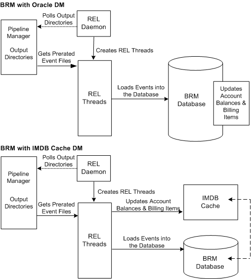

About Running the RE Loader Daemon with Pipeline Manager
When you run the RE Loader daemon, the daemon creates RE Loader threads to load EDR files. Each RE Loader thread loads one EDR file. The number of threads that the RE Loader daemon creates depends on the maximum number of threads that you configure to run simultaneously at a particular time. Because you can configure multiple threads that can run at a time, you can load more than one EDR file simultaneously. This helps in increasing loading performance.
For example, if you configure 10 threads to run simultaneously at peak time, the RE Loader daemon creates 10 threads, which means that 10 EDR files are loaded at the same time.
Running the RE Loader daemon is the preferable method if most of the EDR files that you want to load are of small size.
To run the RE Loader daemon, you must set up the following components:
You can also run the RE Loader daemon by using the pin_ctl utility.
Figure 6-3 shows the RE Loader work flow when you run the RE Loader daemon:
Figure 6-3 Workflow of RE Loader Daemon
The following actions are performed when you run the RE Loader daemon:
  1. The RE Loader daemon detects an EDR file in a pipeline output directory.
  2. The RE Loader daemon creates RE Loader threads up to the maximum number of threads configured.
  3. The RE Loader threads process the files, load the events into the BRM database, and update the account balances, billing items, and journals.
  4. The RE Loader threads move the original file to an archive directory if the records are successfully loaded or to a reject directory if the records are not successfully loaded. These directories are configured in the RE Loader Infranet.properties file.
