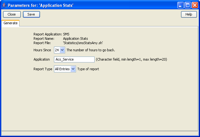

Adding Report Parameters
Use the Parameters screen to enter the parameters for reporting (that is, define the applications and statistics to report against).
Accessing the Parameters screen
Access this screen by clicking Parameters on the Report Schedule screen.
Parameters screen
Here is an example Parameters for: 'Report_Name' screen.
Description of smsparametersforgenerateex_3-1-0.jpg follows
Note: The screen displays different fields, depending on the report chosen.
Parameters fields
The table below describes the function of each field for the above example. Different reports display different fields.
Field Description
Report Application Name of application (display only).
Report Name Name of the report (display only).
Report File Name of the file used to generate the report (display only).
Applications Name of the applications to report. Report dependent.
Hours Since Hours to report. Report dependent.
Report Type Summary or detailed report. Report dependent.
Adding parameters
Follow these steps to add report parameters.
  1. Enter the applications to report. Separate each application with a white space.
  2. Enter the statistics to report. Separate each statistic with a white space.
  3. Enter the hours to report. Separate each hour with a white space.
  4. Click Save.
    Result: The details are saved to the database.
  5. Click Close.
    Result: You return to the Report Schedule screen.
