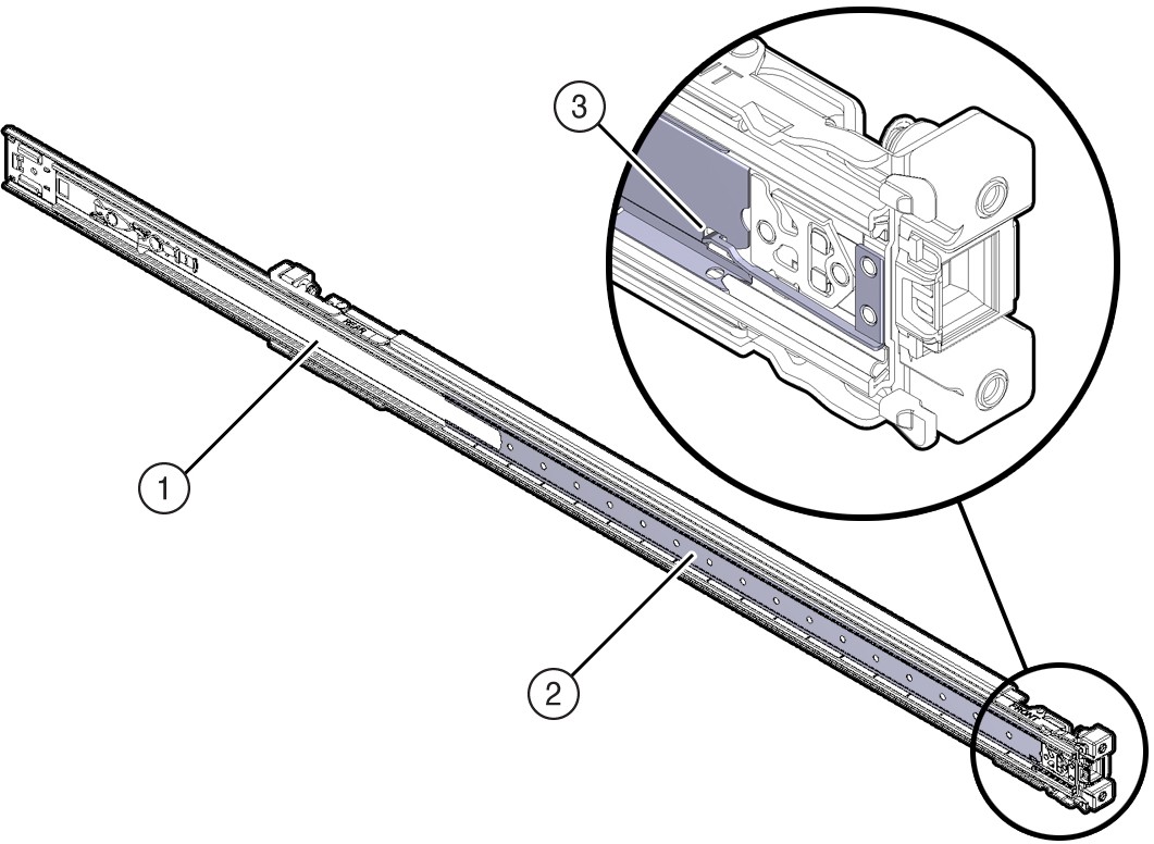

  1. Orient the slide-rail assembly so that the ball-bearing track is forward and locked in place.
    Figure 5-8 Orienting the Slide-Rail Assembly
    Orienting the slide-rail assembly so that the ball-bearing track is forward and locked in place
    Call Out Description
    1 Slide-rail
    2 Ball-bearing track
    3 Ball-bearing locking mechanism

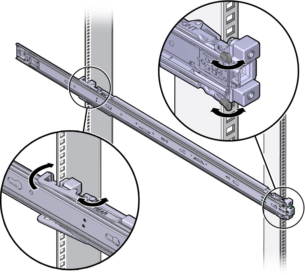

  2. Starting with either the left or right side of the rack, align the back of the slide-rail assembly against the inside of the back rack rail, and push until the assembly locks into place with an audible click.
    Figure 5-9 Aligning and Securing the Slide-Rail Assembly to the Rack
    Aligning and securing the slide-rail Assembly to the rack.
  3. Align the front of the slide-rail assembly against the outside of the front rack rail, and push until the assembly locks into place with an audible click.
  4. Repeat Step 1 through Step 3 to attach the slide-rail assembly to the other side of the rack.
