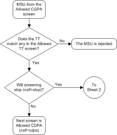

The allowed translation type (TT) screen is used to screen all SCCP messages which have the specified translation type value in the called party address. The gray shaded areas in Figure 5-4 shows the fields of the SS7 message that are checked by the TT screening function.
5.1.1 Gateway Screening Actions
If a match is not found, the message is discarded.
If a match is found, the nsfi is examined to determine the next step in the screening process. If the nsfi value is any value other than stop, the next screening reference (nsr) is identified and the screening process continues to the next screen identified by the nsfi and nsr parameter values.
If the nsfi is equal to stop, the screening process stops and the message is processed. If a gateway screening stop action set is specified with the screen, shown by the actname parameter value, the message is processed according to the gateway screening stop actions that are assigned to the gateway screening stop action set.

5.1.2 Allowed TT Screening Actions
Figure 5-1 through Figure 5-3 show the screening actions of the allowed TT screen.
Figure 5-1 Allowed TT Screening Actions - Sheet 1 of 3

Figure 5-9 Change an Allowed Translation Type Screen - Sheet 1 of 3
Figure 5-10 Change an Allowed Translation Type Screen - Sheet 2 of 3
Figure 5-11 Change an Allowed Translation Type Screen - Sheet 3 of 3
