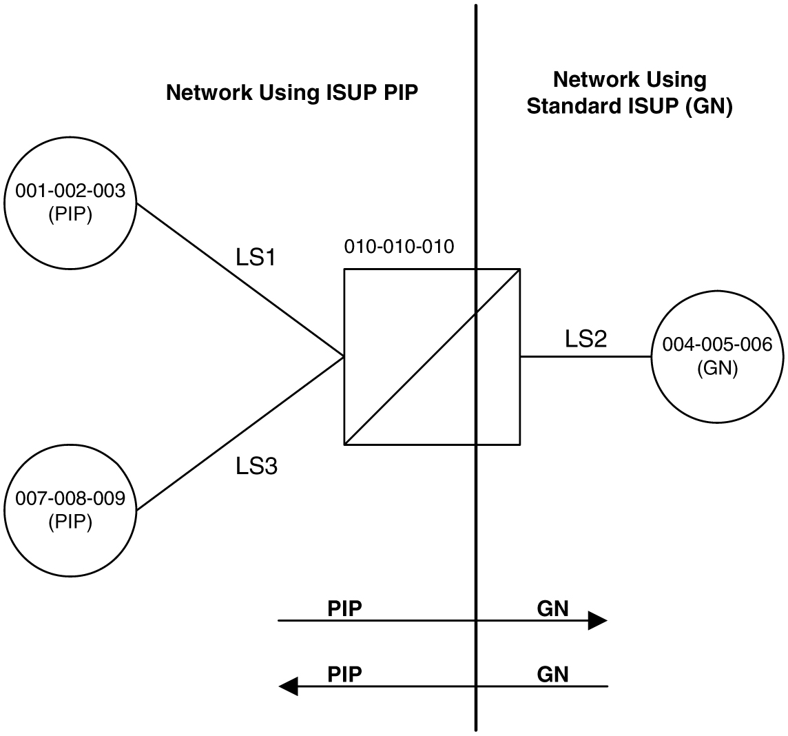

This feature provides a conversion of ISUP IAM messages using two versions of calling name identification presentation (CNIP) for calling name information delivery. One version of the CNIP uses the non-standard proprietary ISUP party information (PIP) parameter. The other version uses the ANSI standard ISUP generic name (GN) parameter. The conversion will either replace the PIP parameter with the GN parameter or the GN parameter with the PIP parameter in the ISUP IAM message.

Figure 14-1 shows an example network which contains these two separate ISUP versions. Based on this example, Table 14-1 shows when the ISUP IAM message conversion by the CNCF feature occurs.
Figure 14-1 PIP/GN Parameter Conversion

Great care must be taken when configuring the gateway screening rules for this feature. The CNCF feature has no way to validate the gateway screening rules to detect errors in converting messages between compatible networks. For example, using the example network in Figure 14-1, the ISUP IAM message traffic from node 001-002-003 to node 007-008-009 does not need to be converted because they are using the same calling name delivery parameter, PIP. If the gateway screening rules are not carefully configured, these messages could be converted when they do not need to be.

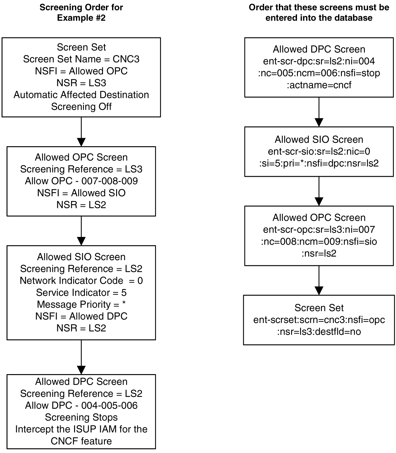

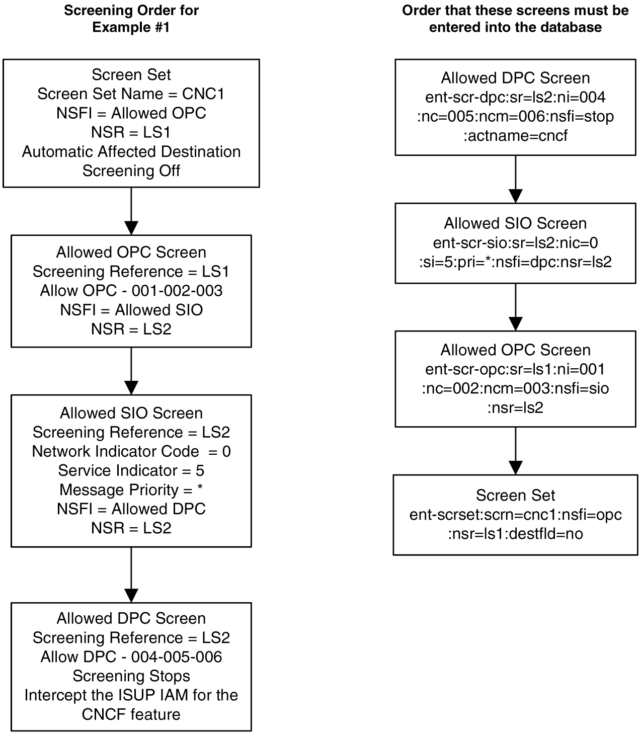

To configure the EAGLE for the CNCF feature, gateway
screening rules for Allowed OPC, Allowed DPC, and the Allowed SIO entities must
be configured in the database for this feature. The last entity in the
screening process (nsfi=stop) must have a
gateway screening stop action set containing the
CNCF gateway screening stop action.
The allowed OPC screening rules must contain the OPCs that the ISUP IAM messages are being sent from.
The allowed DPC screening rules must contain the DPCs that the ISUP IAM messages are being sent to.
The allowed SIO screening rules must contain the ISUP
message type, defined by the
si=5 parameter.

Figure 14-2 CNCF Gateway Screening Configuration - Example 1
Figure 14-3 CNCF Gateway Screening Configuration - Example 2
