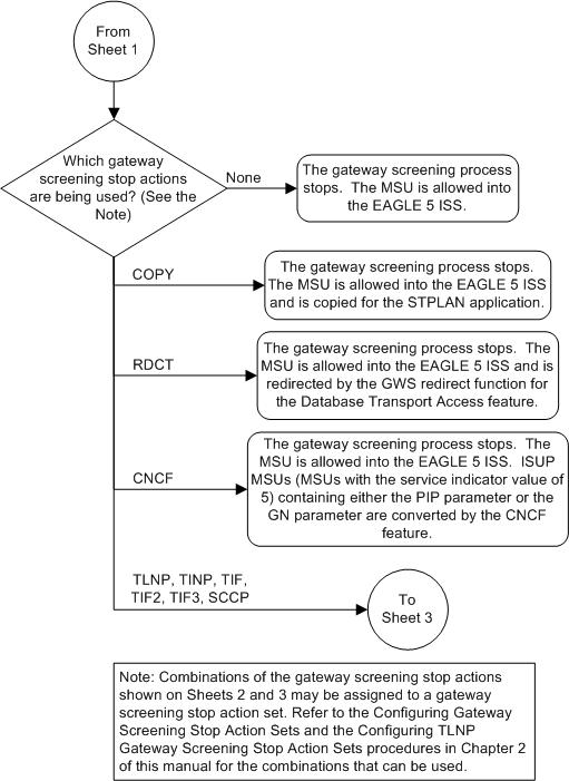

15.1.1 Gateway Screening Actions
The Gateway Screening process stops with this screen. The nsfi
parameter value can only be stop
If a match is not found, the message is discarded.
actname
parameter value, the message is processed according to the gateway screening stop actions that are assigned to the gateway screening stop action set.
- If the
rdct
(redirect) gateway screening stop action is specified, the message is diverted from the original destination and sent to another destination with the Database Transport Access feature, specified by global title translation, for further processing. - If the
cncf
gateway screening stop action is specified, the PIP parameter in the incoming ISUP IAM message is converted to the GN parameter. The GN parameter in the incoming ISUP IAM message is converted to the PIP parameter. The message is then sent to the node specified by the DPC in the routing label in the message. For more information on the Calling Name Conversion Facility feature, see Calling Name Conversion Facility (CNCF) Configuration. - If the
tlnp
gateway screening stop action is specified, ISUP IAMs that pass gateway screening are processed either by the ISUP NP with EPAP feature (if the ISUP NP with EPAP feature is enabled and turned on) or by the Triggerless LNP feature (if the Triggerless LNP feature is turned on). The ISUP NP with EPAP feature is discussed in more detail in G-Port User's Guide. The Triggerless LNP feature is discussed in more detail in ELAP Administration and LNP Feature Activation Guide. - If the
tinp
gateway screening stop action is specified, ISUP IAMs that pass gateway screening are intercepted by the Triggerless ISUP based Number Portability (TINP) feature and converted to include the routing number (RN) if the call is to a ported number. The TINP feature is discussed in more detail in G-Port User's Guide. - If the
tif
,tif2
, ortif3
gateway screening stop actions are specified, TIF processing is applied to the message. - If the
sccp
gateway screening stop action is specified, MTP routed SCCP UDT/XUDT are forwarded to the service modules for further processing.

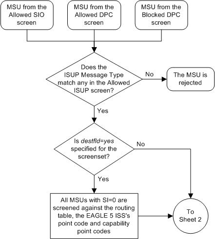

Figure 15-1 through Figure 15-3 show the screening actions of the allowed ISUP message type screen.
Figure 15-1 Allowed ISUP Message Type Screening Actions - Sheet 1 of 3
Figure 15-2 Allowed ISUP Message Type Screening Actions - Sheet 2 of 3
Figure 15-3 Allowed ISUP Message Type Screening Actions - Sheet 3 of 3
