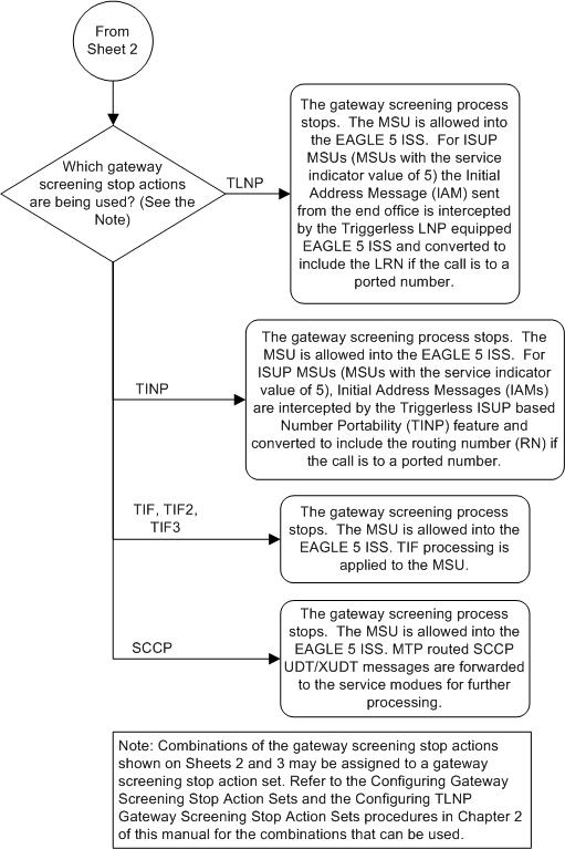

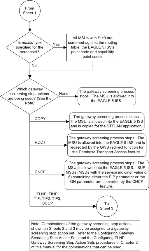

If a match is found, the nsfi is examined to determine the next step in the screening process. If the nsfi value is any value other than stop, the next screening reference (nsr) is identified and the screening process continues to the next screen identified by the nsfi and nsr parameter values.
nsfi is equal to stop, the screening process stops and the message is processed. If a gateway screening stop action set is specified with the screen, shown by the actname parameter value, the message is processed according to the gateway screening stop actions that are assigned to the gateway screening stop action set.
- If the
rdct(redirect) gateway screening stop action is specified,the message is diverted from the original destination and sent to another destination with the Database Transport Access feature, specified by global title translation, for further processing. - If the
cncfgateway screening stop action is specified, the PIP parameter in the incoming ISUP IAM message is converted to the GN parameter. The GN parameter in the incoming ISUP IAM message is converted to the PIP parameter. The message is then sent to the node specified by the DPC in the routing label in the message. For more information on the Calling Name Conversion Facility feature, see Calling Name Conversion Facility (CNCF) Configuration. - If the
tlnpgateway screening stop action is specified, ISUP IAMs that pass gateway screening are processed either by the ISUP NP with EPAP feature (if the ISUP NP with EPAP feature is enabled and turned on) or by the Triggerless LNP feature (if the Triggerless LNP feature is turned on). The ISUP NP with EPAP feature is discussed in more detail in G-Port User's Guide. The Triggerless LNP feature is discussed in more detail in ELAP Administration and LNP Feature Activation Guide. - If the
tinpgateway screening stop action is specified, ISUP IAMs that pass gateway screening are intercepted by the Triggerless ISUP based Number Portability (TINP) feature and converted to include the routing number (RN) if the call is to a ported number. The TINP feature is discussed in more detail in G-Port User's Guide. - If the
tif,tif2, ortif3gateway screening stop actions are specified, TIF processing is applied to the message. - If the
sccpgateway screening stop action is specified, MTP routed SCCP UDT/XUDT are forwarded to the service modules for further processing.

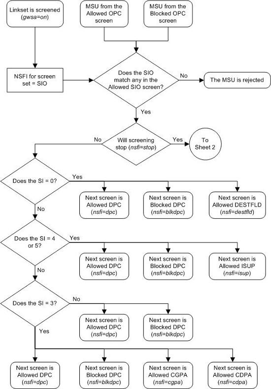

10.1.2 Allowed SIO Screening Actions
The value of the
nsfi parameter is based on the value of
the service indicator (si) parameter.
Table 10-1
shows the valid combinations of
nsfi values and service indicator
values.
Table 10-1 Valid Parameter Combinations for the Allowed SIO Screening Function
| Service Indicator (SI) Values | Nest Screening Function Identifier (NSFI) Values |
| 0 | DPC, BLKDPC, DESTFLD |
| 3 | DPC, BLKDPC, CGPA, CDPA |
| 4, 5 | DPC, BLKDPC, ISUP |
| All other values (1, 2, 6-15) | DPC, BLKDPC |
Messages containing the service indicator value 4 are TUP messages, and messages containing the service indicator value 5 are ISUP messages. Both types of messages are screened using the allowed ISUP screen. TUP messages can be screened for point codes, after the SIO screen, with the allowed and blocked DPC screens. However, if the screen set does not contain an allowed SIO screen that screens for TUP messages (messages with the service indicator value of 4), the message will be treated by the allowed ISUP message type screen as an ISUP message, even if the message contains the service indicator value of 4.
Figure 10-1 through Figure 10-3 shows the screening actions of the allowed SIO screen.
Figure 10-1 Allowed SIO Screening Actions - Sheet 1 of 3
Figure 10-2 Allowed SIO Screening Actions - Sheet 2 of 3
Figure 10-3 Allowed SIO Screening Actions - Sheet 3 of 3

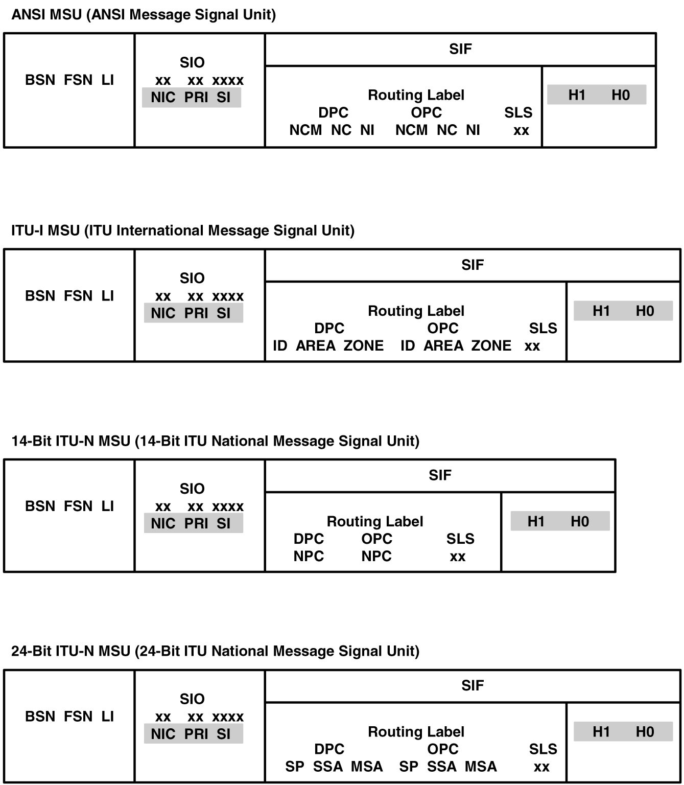

Specifying H0 and H1 Values
The
h0 and
h1 values must be specified if the
si value is 0, 1, or 2. If the
si value is 3 through 15, the
h0 and
h1 parameters cannot be specified.
The
h0 and
h1 parameters must be specified if
either parameter is specified.
The H0 and H1 heading code values can be a single value,
a range of values with the beginning and end of the range separated by double
ampersands (for example, a range of values from 2 to 9, 2&&9), or with
an asterisk (*). The asterisk specifies all possible values for the
h0 and
h1 parameters.
