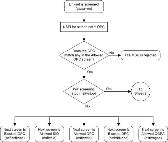

12.1.2 Allowed OPC Screening Actions
Figure 12-1 through Figure 12-3 show the screening actions of the allowed OPC screen.
Figure 12-1 Allowed OPC Screening Actions - Sheet 1 of 3
img/allowed_opc-1_231.jpg

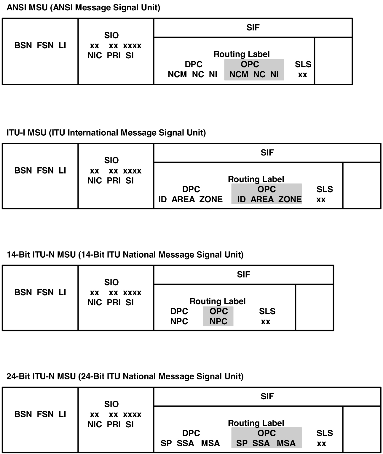

Figure 12-4 Allowed OPC Screening Functions
img/c_introduction_10_dbags-fig5.jpg
