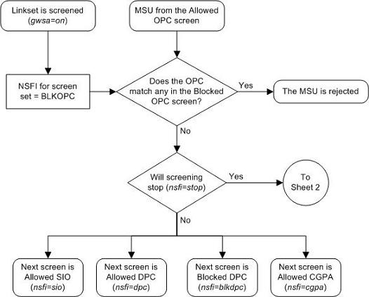

11.1.2 Blocked OPC Screening Actions
Figure 11-1 through Figure 11-3 show the screening actions of the blocked OPC screen.
Figure 11-1 Blocked OPC Screening Actions - Sheet 1 of 3

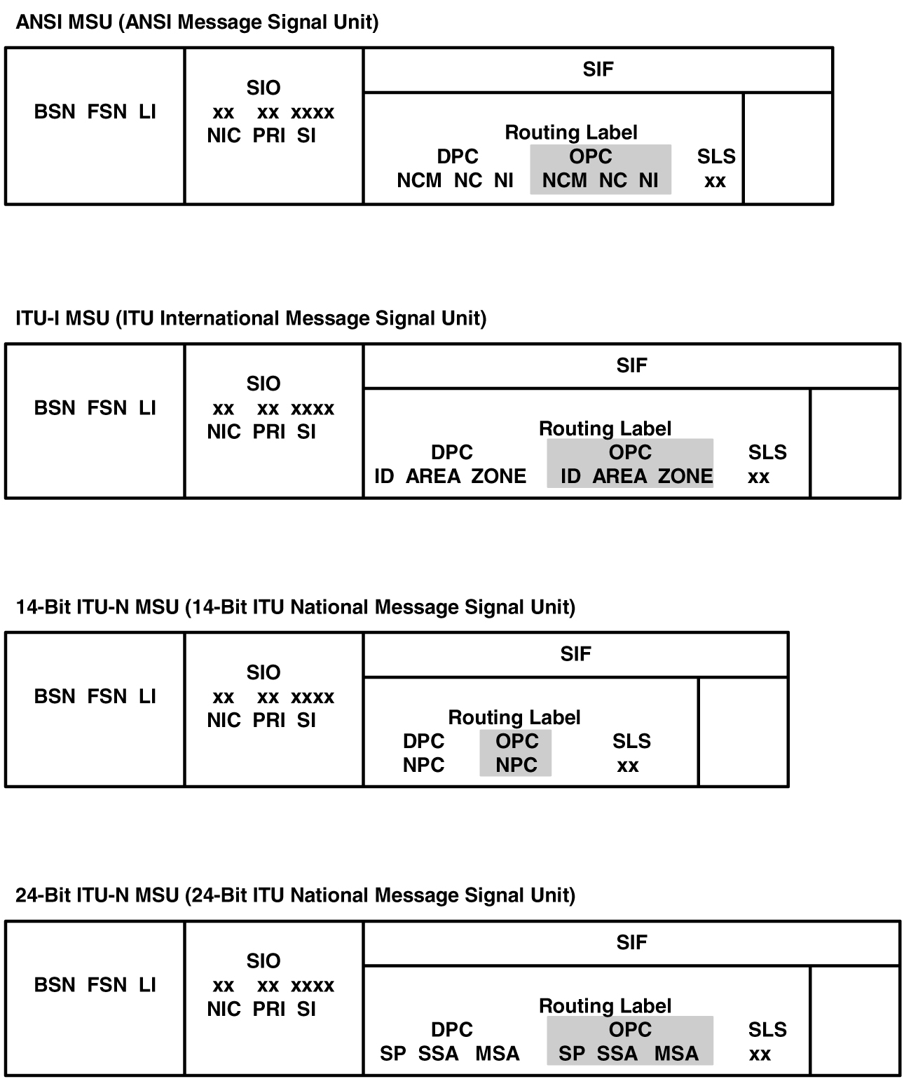

Figure 11-4 Blocked OPC Screening Functions
img/c_introduction_9_dbags-fig5.jpg
