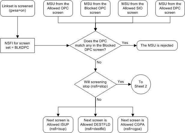

The blocked DPC screen identifies DPC's that are not allowed to receive SS7 messages from another network. The gray shaded areas in Figure 8-4 shows the fields of the SS7 message that are checked by the blocked DPC screening function.
8.1.1 Gateway Screening Actions
If a match is found, the nsfi is equal to fail, the message is discarded and no further screening takes place.
If a match is not found, the nsfi is examined to determine the next step in the screening process. If the nsfi value is any value other than stop, the next screening reference (nsr) is identified and the screening process continues to the next screen identified by the nsfi and nsr parameter values.
If the nsfi is equal to stop, the screening process stops and the message is processed. If a gateway screening stop action set is specified with the screen, shown by the actname parameter value, the message is processed according to the gateway screening stop actions that are assigned to the gateway screening stop action set.
  • If the rdct (redirect) gateway screening stop action is specified,the message is diverted from the original destination and sent to another destination with the Database Transport Access feature, specified by global title translation, for further processing.
  • If the cncf gateway screening stop action is specified, the PIP parameter in the incoming ISUP IAM message is converted to the GN parameter. The GN parameter in the incoming ISUP IAM message is converted to the PIP parameter. The message is then sent to the node specified by the DPC in the routing label in the message. For more information on the Calling Name Conversion Facility feature, see Calling Name Conversion Facility (CNCF) Configuration.
  • If the tlnp gateway screening stop action is specified, ISUP IAMs that pass gateway screening are processed either by the ISUP NP with EPAP feature (if the ISUP NP with EPAP feature is enabled and turned on) or by the Triggerless LNP feature (if the Triggerless LNP feature is turned on). The ISUP NP with EPAP feature is discussed in more detail in the Feature Manual - G-Port. The Triggerless LNP feature is discussed in more detail in the ELAP Administration and LNP Feature Activation manual.
  • If the tinp gateway screening stop action is specified, ISUP IAMs that pass gateway screening are intercepted by the Triggerless ISUP based Number Portability (TINP) feature and converted to include the routing number (RN) if the call is to a ported number. The TINP feature is discussed in more detail in the Feature Manual - G-Port.
  • If the tif, tif2, or tif3 gateway screening stop actions are specified, TIF processing is applied to the message.
  • If the sccp gateway screening stop action is specified, MTP routed SCCP UDT/XUDT are forwarded to the service modules for further processing.
8.1.2 Blocked DPC Screening Actions
Figure 8-1 through Figure 8-3 show the screening actions of the blocked DPC screen.

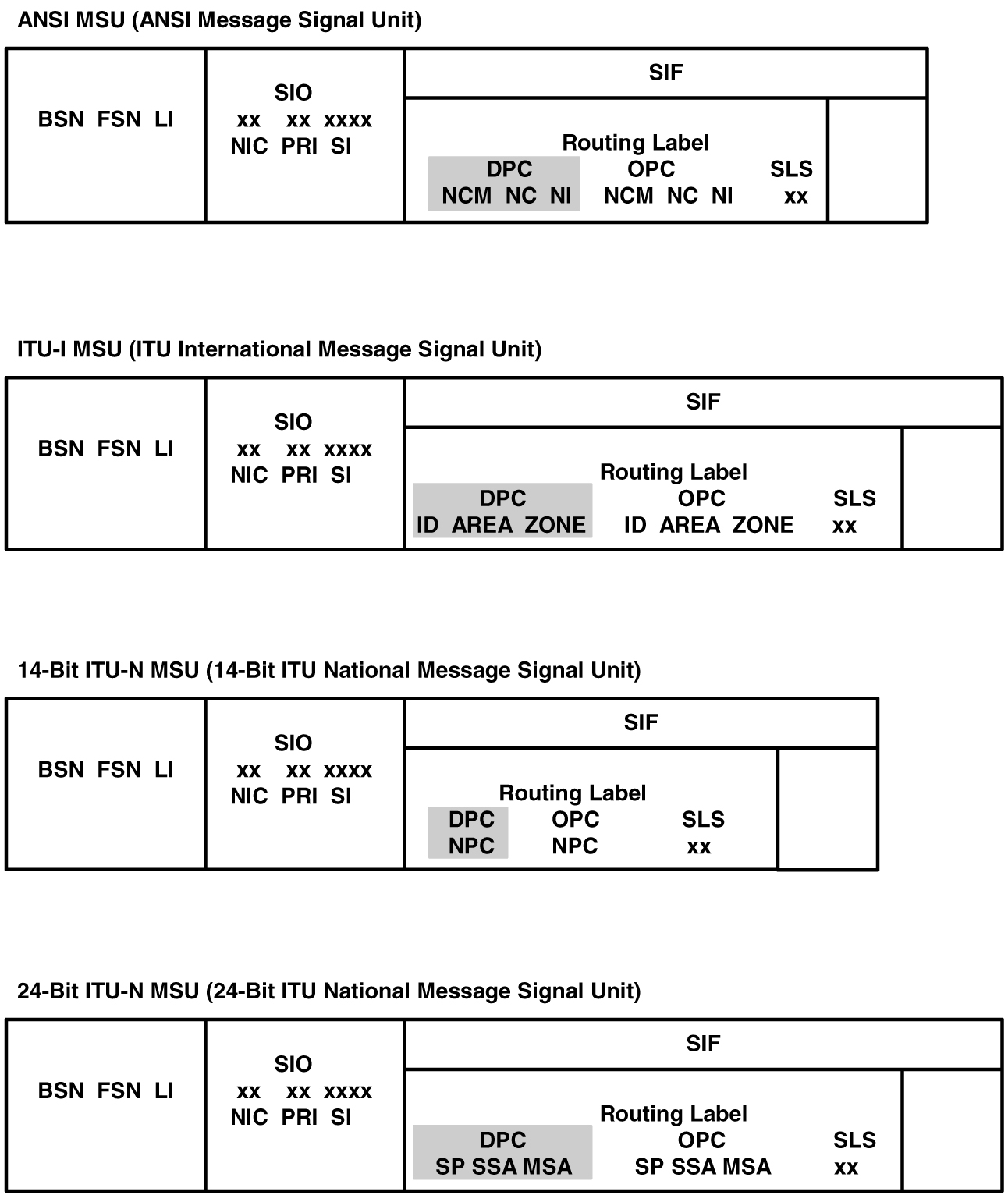

The ANSI point code parameter values can be specified as a single value, a range of values, or with an asterisk (*). The asterisk specifies all possible values for the ni, nc, and ncm parameters. Table 8-2 shows the valid combinations of these parameter values.
Table 8-2 Valid Value Combinations for ANSI Point Code Parameters
NI NC NCM
Single Value Single Value Single Value
Single Value Single Value Range of Values
Single Value Single Value Asterisk
Single Value Range of Values Asterisk
Single Value Asterisk Asterisk
Range of Values Asterisk Asterisk
Asterisk Asterisk Asterisk
A range of values can also be specified for an ITU-I or 24-bit ITU-N point code parameter using a combination of asterisks (*) and single values for the point code parameters. Table 8-3 shows the valid combinations of the ITU-I parameter values. Table 8-4 shows the valid combinations of the 24-bit ITU-N parameter values.
Table 8-3 Valid Value Combinations for ITU-I Point Code Parameters
ZONE AREA ID
Table 8-4 Valid Value Combinations for 24-Bit ITU-N Point Code Parameters
MSA SSA SP
