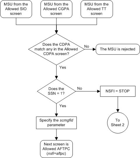

Figure 4-1 through Figure 4-3 show the screening actions of the allowed CDPA screen.
Figure 4-1 Allowed CDPA Screening Actions - Sheet 1 of 3
Figure 4-2 Allowed CDPA Screening Actions - Sheet 2 of 3

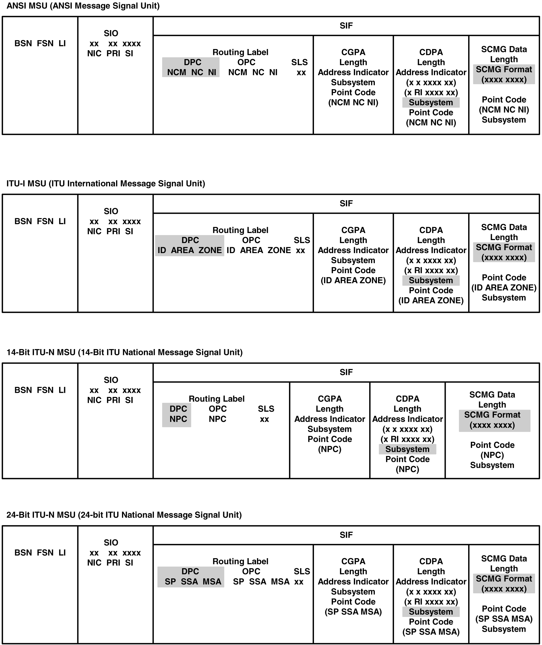

Figure 4-4 Allowed Called Party Address Screening Function
