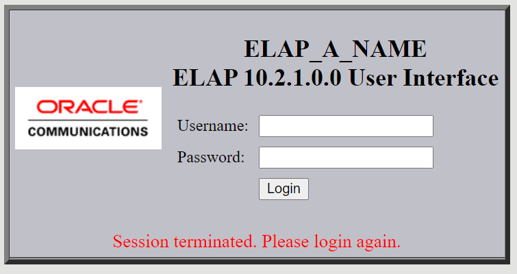

Accessing the ELAP GUI Interface
ELAP employs a web-based user interface. It uses the typical client-server paradigm. The front end appears on an Internet browser. The back end operates on the platform. The front end is officially supported on Microsoft® Internet Explorer, versions 8.0 or 9.0, and on Mozilla® Firefox®, version 3.0.0 or later.:
CAUTION: The User Interface may not function correctly with the browser you are using.
Microsoft® Internet Explorer, versions 8.0 and 9.0, have been certified for this application Use the following procedure to access the main screen of the ELAP GUI interface.

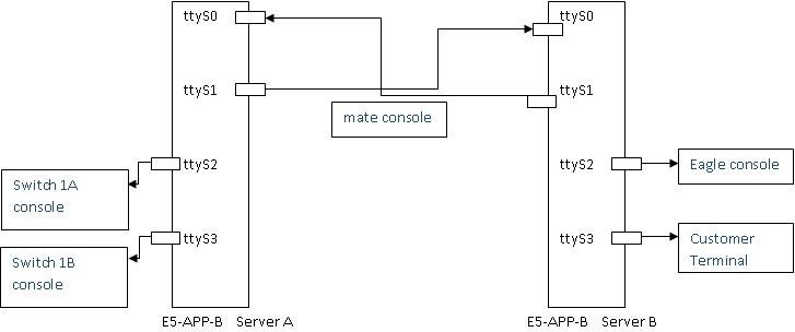

ssh) utility to connect to either server’s IP address. This connection will be made through the port that is identified as eth01 on the ELAP E5-APP-B Interconnect and is identified as eth91 by the software. For more information, see Using ssh to Connect to the Server Command Line. - Use a secure shell (ssh) utility to accessible ELAP server. Use command
minicom mateto log on to the mate ELAP server's command line. - If access to the MPS server is not available through an IP network, connect to the E5-APP-B card via the serial port:
For connecting the E5-APP-B A card, disconnect the console cable from the serial port on the E5-APP-B card's adapter. The cable should be disconnected at the point where it connects to the serial port labeled 'S1' on the E5-APP-B card's adapter and use it for serial access. Cable part numbers - 830-1220-xx.
Connect a cable, Part Number 830-0058-xx (xx represents the cable length), to serial port ttyS0 on either the A or B server (see Connecting a Local Access Terminal to Server’s Serial Port).

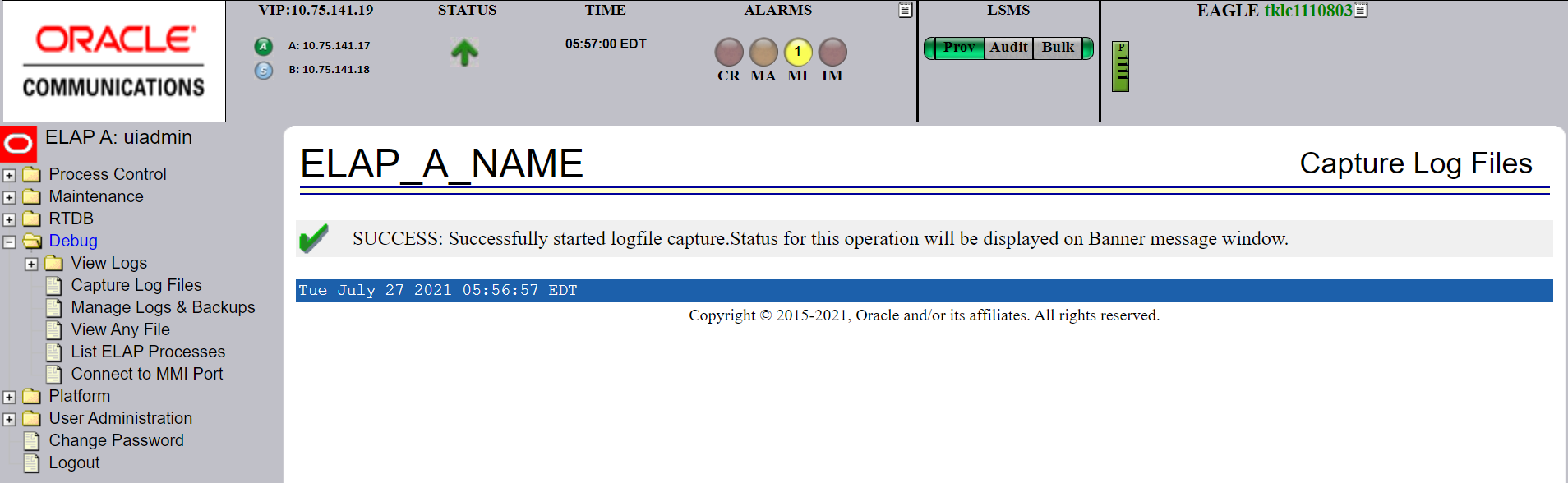

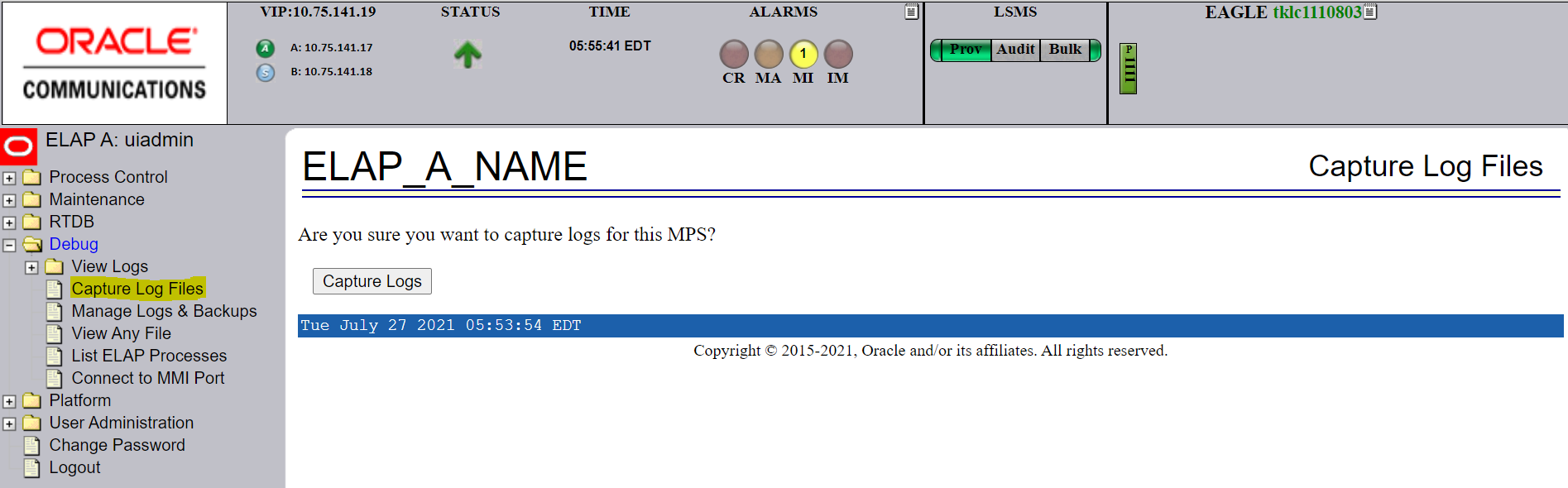

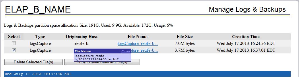

Saving Logs Using the ELAP GUI
During some corrective procedures, it may be necessary to provide Oracle with information about the ELAP for help in clearing an alarm. These log files are used to aid unresolvable-reference.html#GUID-A2C37E16-F0BA-4FB6-9D93-1D4A95A40DC7 when troubleshooting the ELAP.
Use the following procedure to save logs using menu selections from the ELAP GUI.
