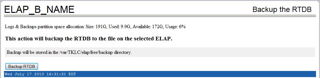

  2. From the ELAP menu, select RTDB, and then Maintenance, and then Backup RTDB.
    The window in Figure 2-1 is displayed.
    Figure 2-1 Backup the RTDB
    img/capture_backup_rtdb_elap.jpg

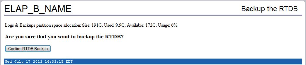

  3. Click Backup RTDB.
    The window in Figure 2-2 displays a request for confirmation.
    Figure 2-2 Backup the RTDB Confirmation
    img/capture_backup_rtdb_confirm_elap.jpg
  4. Click Confirm RTDB Backup.
    If the backup starts successfully, the following message will scroll through the GUI banner:
    Backup RTDB in progress.
    After the backup completes successfully, the success window is displayed.
  5. The RTDB backup procedure is complete.

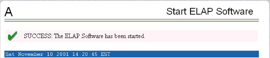

  6. Select Process Control, and then Start Software from the ELAP Menu.
  7. On the Start ELAP Software screen as shown in Figure 2-3, click Start ELAP Software.
    Figure 2-3 Start ELAP Software
    img/t_daily_maintenance_mps_maintenance_t1100mps_maintmanual-fig11.jpg
    After the ELAP software has started successfully, the screen in Figure 2-4 is displayed.
    Figure 2-4 Start ELAP Software - Success
    img/t_daily_maintenance_mps_maintenance_t1100mps_maintmanual-fig12.jpg

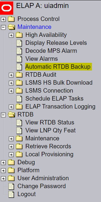

User Interface
The menu item circled in **INTERNAL XREF ERROR** is available on the ELAP GUI of the Active ELAP server only:
Figure 2-7 Automatic RTDB Backup Menu Item
Clicking Automatic RTDB Backup opens the page shown in Figure 2-8.
Figure 2-8 Automatic RTDB Backup GUI Screen
img/automatic-rtdb-backup-gui.jpg

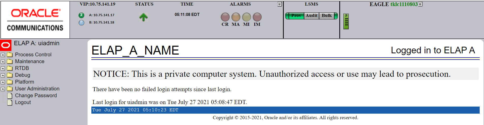

  1. Log in to the User Interface of the ELAPGUI (see Accessing the ELAP GUI Interface).
  2. Check the banner information above the menu to verify that the ELAP about which system health information is sought is the one that is logged into.
    Figure 2-9 Login Window
    Login Window
  3. If it is necessary to switch to the other ELAP, click the Select Mate menu item.
  4. When the GUI shows you are logged into the ELAP about which you want system health information, select Platform>Run Health Check. as shown in the following window.
