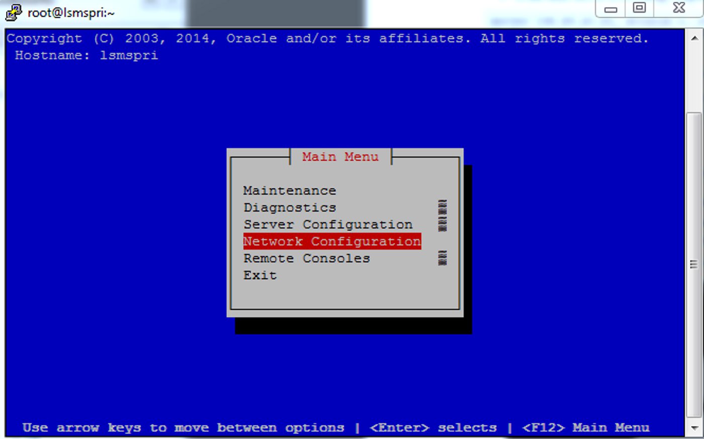

  1. Log in to the active server with username lsmsmgr.
    (For more information about logging into a server, refer to Using Login Sessions.)

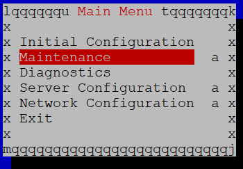

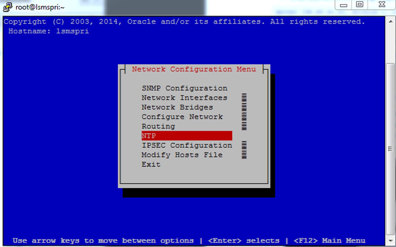

  2. From the Main Menu, select Network Configuration and press Enter.
    Figure 5-1 Selecting the Network Configuration Menu
    img/t_configuring_the_lsms_to_use_an_ntp_server_config_fig1.jpg
  3. From the Network Configuration Menu, select NTP and press Enter to select the network time protocol screen.
    Figure 5-2 Selecting the NTP Menu

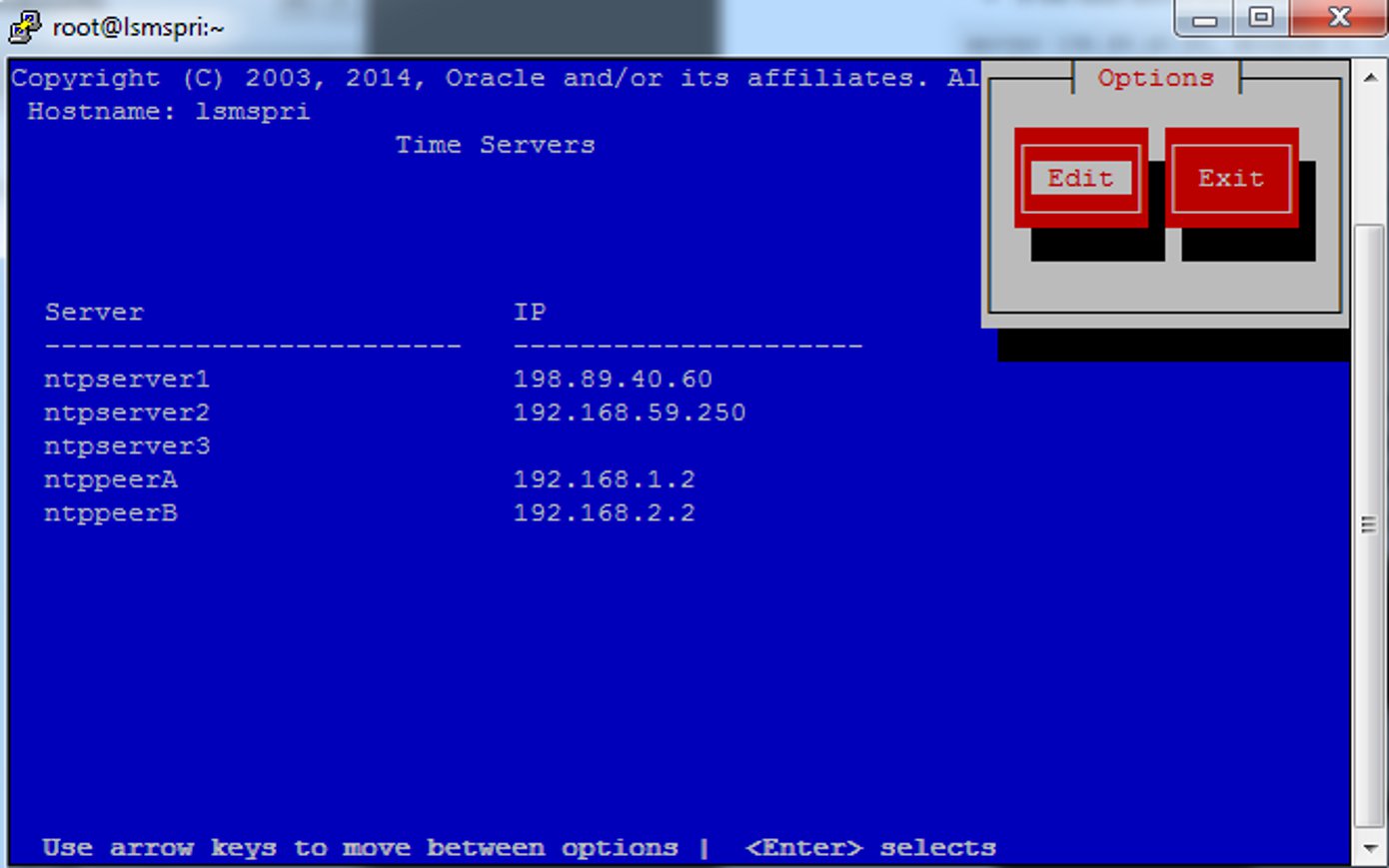

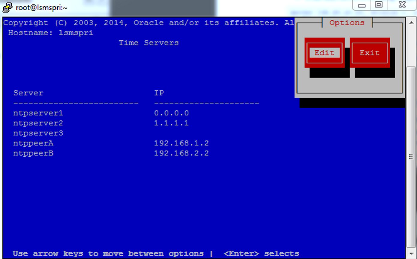

  4. The Time Servers screen displays the NTP servers available to the LSMS.
    Examine the screen for available NTP servers. In the sample figure, ntpserver2 is available as the NTP server to select. Click the Edit button to define an NTP server for this LSMS.
    Do not change any netpeer address.
    Figure 5-3 Displaying NTP Time Servers Screen
    img/t_configuring_the_lsms_to_use_an_ntp_server_config_fig3.jpg

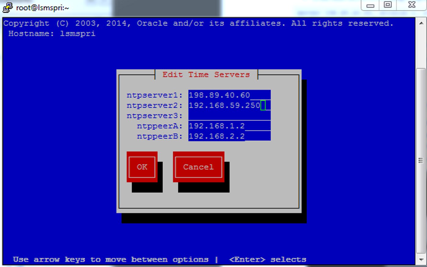

  5. To add an NTP server to the LSMS configuration, type the IP address for the available NTP server to use for your LSMS.
    Choose the server with the lowest number, which provides the highest stratum of quality of time, and press the OK button.
    Figure 5-4 Assigning an NTP Server to the LSMS
    img/t_configuring_the_lsms_to_use_an_ntp_server_config_fig4.jpg
  6. The Time Server screen now reappears to confirm your entry for netserver2 as assigned to the LSMS port you specified.
    You can now Edit the existing routes or Exit back to the Network Configuration Menu.

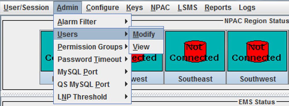

If this feature is disabled, all configurable permission groups created and users' assignments to them are retained. The ability to create, modify and delete permission groups and user assignments will no longer be permitted.

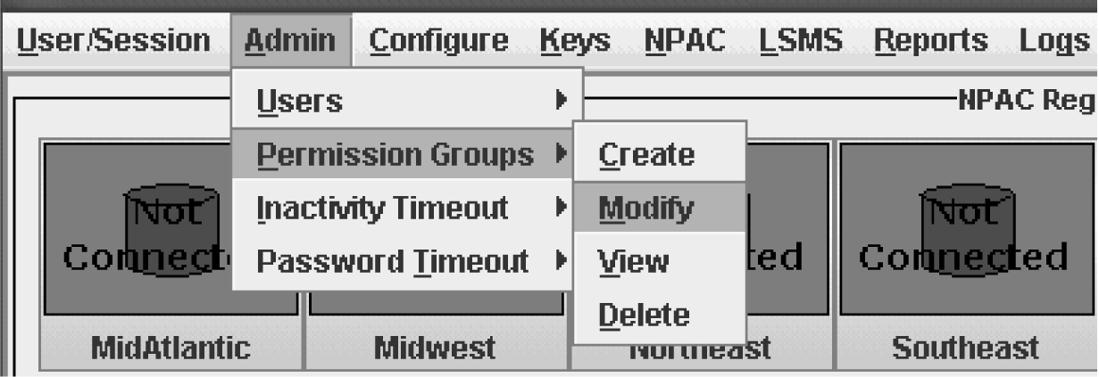

5.6 Admin Menu Component Information
The Admin menu, which consists of the following submenu items:
  • Alarm Filter - When activated, the Alarm Filter feature enables the system administrator to filter unwanted alarms from being sent to remote alarm surveillance management systems.
  • Users - Enables the system administrator to modify or view existing users' permission group assignment.
  • Permission Groups - Enables the system administrator to create, modify, view, or delete permission groups.
  • Inactivity Timeout - When activated, the Automatic Inactivity Logout feature logs out LSMSGUI and Linux users after a preset period of inactivity occurs.

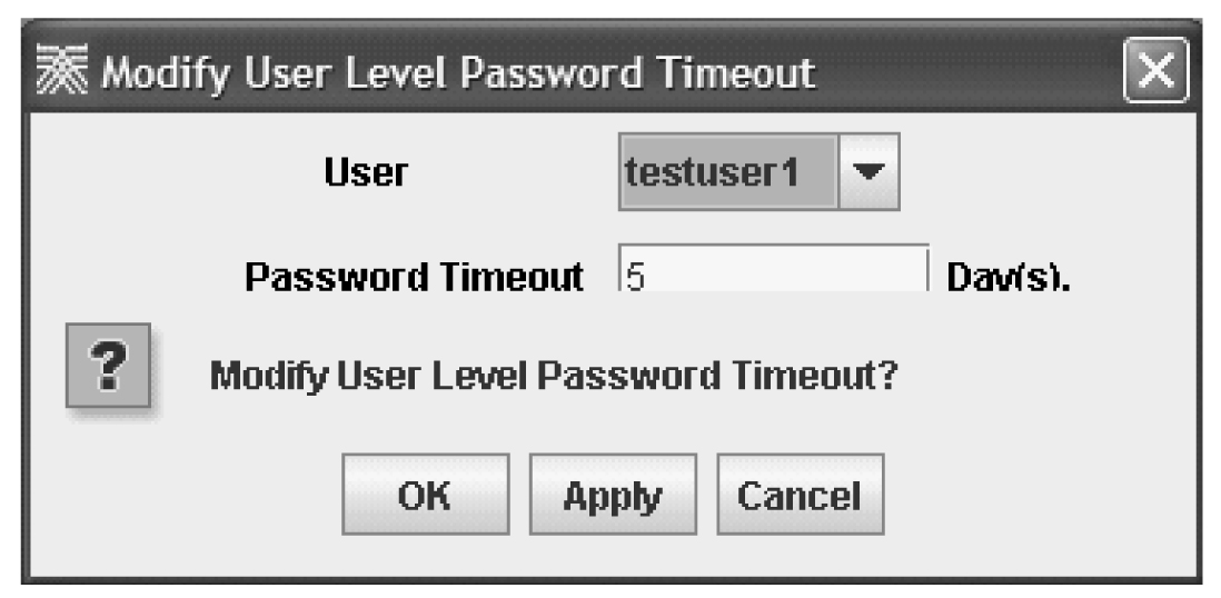

  • Password Timeout - Enables the system administrator to modify password timeout intervals that are specific to individual users or user groups.
  • MySQL Port - Enables the system administrator to configure the MySQL port to any port between 34000 and 34099.

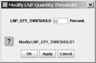

  • LNP Threshold - Enables the system administrator to configure the LNP quantity threshold.
To access the Admin menu functions, you must log in as lsmsadm or lsmsall group.
Figure 5-7 Admin Menu
img/c_admin_menu_component_information_config-fig1.jpg
The User dialog is used to modify and view permission group assignment for existing users.
When a user is initially created, the system administrator assigns that user to one of the non-configurable, default permission groups. After being initially assigned to a default permission group, the system administrator can assign a user to a different default permission group or to a configurable permission group. The permission group to which a user is assigned depends on the type of account it is and what it is to be used for. A user can only be assigned to a single permission group.
Default users of default permission groups cannot be re-assigned to another permission group. For example, an “lsmsadm” user assigned to the “lsmsadm” permission group cannot be re-assigned to the “lsmsview” permission group.
The permission group to which a user is assigned can be modified or viewed using the Modify (see Modify Users) or View User (see View Users) dialog, respectively.
Configurable permission groups can be created, modified, viewed, and deleted using the Permission Groups dialogs (see “Permission Groups Submenu”).
Permission group assignments will only effect new logins. Users that are currently logged in will retain their current group permissions until their next login.
Although the LSMS application does not impose a limit on the number of LSMS users that can be created on the system, a maximum of 128 users can be displayed in the Combo Box list of the LSMSGUI User Dialogs (when using LSMS local GUI). There is no limitation when running the LSMSGUI remotely on a Windows platform.

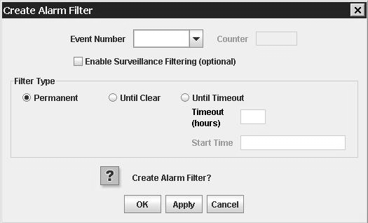

5.6.1.2 Create Alarm Filter
  1. Log in as a user in the lsmsadm or lsmsall group.
  2. From the main menu, select Admin, and then Alarm Filter , and then Create.
    The Create Alarm Filter dialog appears.
    Figure 5-8 Create Alarm Filter
    img/alarm_threshold_create.jpg
  3. Enter an Event Number.
  4. Select Enable Surveillance Filtering (optional). This step is optional
  5. Select one of the Filter Type radio buttons.
  6. Click Apply to save the changes and remain in the current window, or skip to 7
    When the Update Successful dialog appears, click OK.
  7. Click OK to save the changes and return to the LSMS Console.
    Table 5-4 Create Alarm Filter Dialog - Field Constraints
    Field Type Constraints
    Event Number
    Text field
    Range: 1 to 4 numeric characters
    Checkbox
    None
    Filter Type Radio buttons None
    Table 5-5 Create Alarm Filter Dialog - Field Descriptions
    Field Description
    Event Number
    The event number for which you want to create a filter.
    When selected, the alarm will not be sent to the console/serial port.
    Filter Type
    • Permanent - Filter the alarm permanently.
    • Until Clear - Filter alarm until it clears.
    • Until Timeout - Filter alarm until timeout.

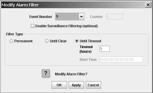

5.6.1.3 Modify Alarm Filter
  2. From the main menu, select Admin, and then Alarm Filter, and then Modify.
    The Modify Alarm Filter dialog appears.
    Figure 5-9 Modify Alarm Filter
    img/modify_alarm_dialog.jpg
  3. Select an Event Number from the pulldown menu.
  4. Select or deselect Enable Surveillance Filtering (optional).
  5. Make the necessary changes to the Filter Type.
  6. Click Apply to save the changes and remain in the current window, or skip to 7.
    An Update Successful dialog appears. Click OK.

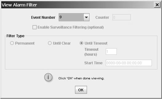

5.6.1.4 View Alarm Filter
  2. From the main menu, select Admin, and then Alarm Filter, and then View.
    The View Alarm Filter dialog appears.
    Figure 5-10 View Alarm Filter
    img/view_alarm_dialog.jpg
  3. Select an Event Number from the pulldown menu to view its details.
  4. Click OK to return to the LSMS Console.

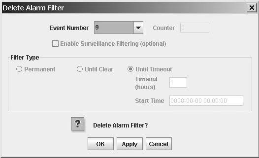

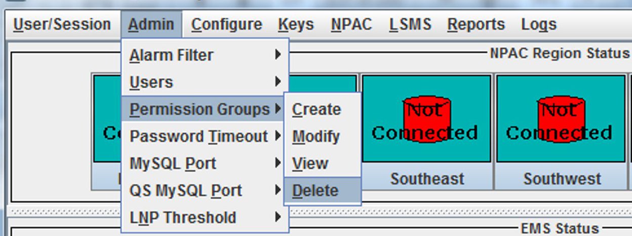

5.6.1.5 Delete Alarm Filter
  2. From the main menu, select Admin, and then Alarm Filter, and then Delete.
    The Delete Alarm Filter dialog appears.
    Figure 5-11 Delete Alarm Filter
    img/delete_alarm_dialog.jpg
  4. Click Apply to delete the Event Number and remain in the current window, or skip to 5.
    A Confirm Delete dialog appears.
    1. Click Yes to delete the Event Number.
    2. Click OK.
  5. Click OK to delete the Event Number and return to the LSMS Console.
    2. Click OK.
5.6.2 Users Submenu
The Users submenu consists of a Modify and a View function.

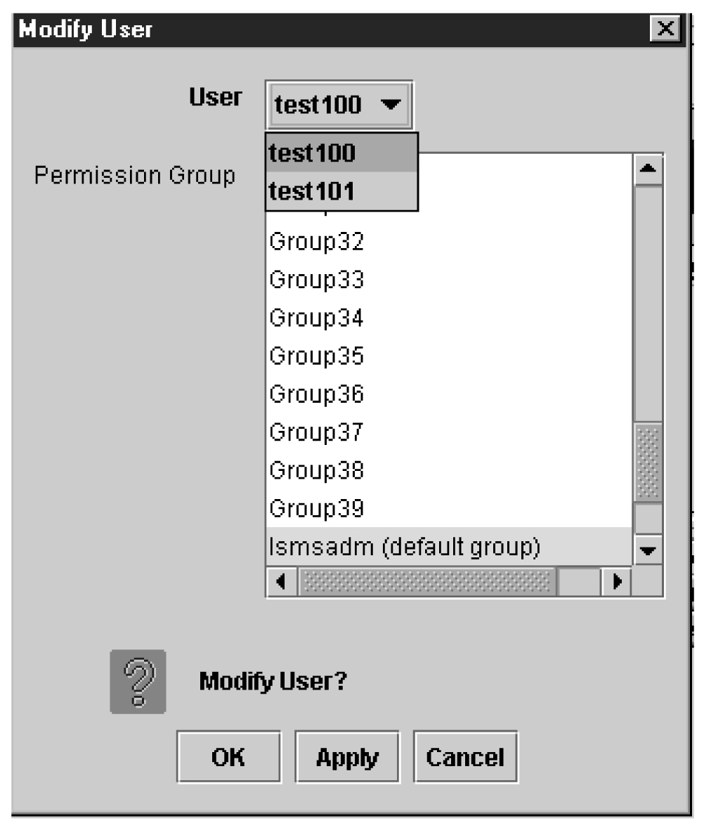

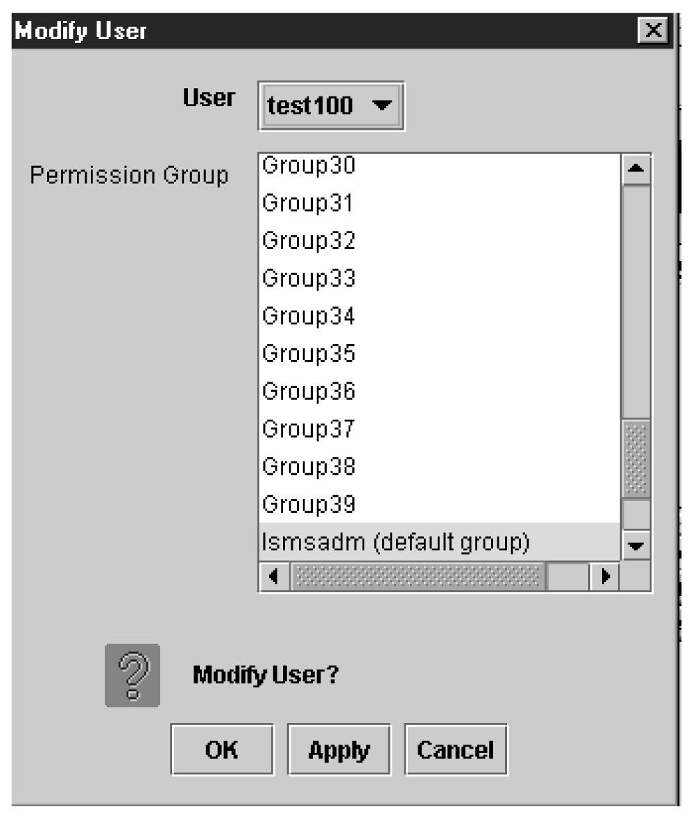

5.6.2.1 Modify Users
The Modify User dialog is used to modify the group assignment for an existing user, as described in the following procedure.
  2. From the main menu, select Admin, and then Users, and then Modify.
    Figure 5-12 Select Admin, and then Users, and then Modify
    img/t_users_submenu_config_fig1.jpg
  3. Click Modify, and the Modify User dialog displays.
    Figure 5-13 Modify User Dialog
    img/t_users_submenu_config_fig2.jpg
  4. Select a User, and the associated permission group is automatically selected in the Permission Group list.
    See Table 5-6 and Table 5-7 for information about the Modify User dialog field constraints and descriptions, respectively.
    Figure 5-14 Select a User
    img/t_users_submenu_config_fig3.jpg

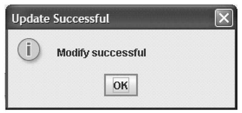

  5. To modify the permission group assignment for another user, click Apply.

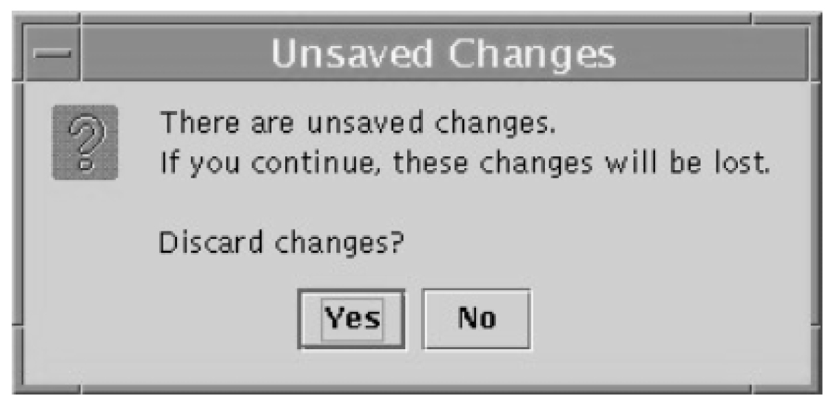

    If you try to modify permission group assignment for another user while there are unsaved changes for the current user, a confirmation dialog is displayed asking you to save the changes.
    When you click OK or Apply to modify a user's permission group assignment, the permission group selection is checked to ensure that a permission group has been selected. If a permission group is not selected, an error dialog is displayed.
    Figure 5-15 Confirmation Dialog
    img/t_users_submenu_config-fig4.jpg
    Table 5-6 Modify User Dialog - Field Constraints
    Field Type Modifiable? Constraints
    User
    Combo Box
    No
    Single selection only
    Permission Group
    List
    Yes
    Table 5-7 Modify User Dialog - Field Description
    Field Description
    User
    Login name used to access the LSMS.
    Permission Group
    List of previously defined permission groups (see Permission Groups Submenu). The user is a member of the selected permissions group.
  6. When you are done, click OK .
You have now completed this procedure.

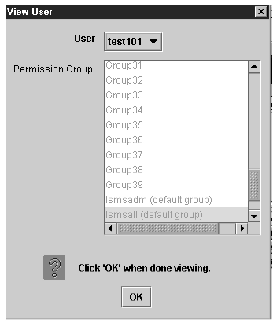

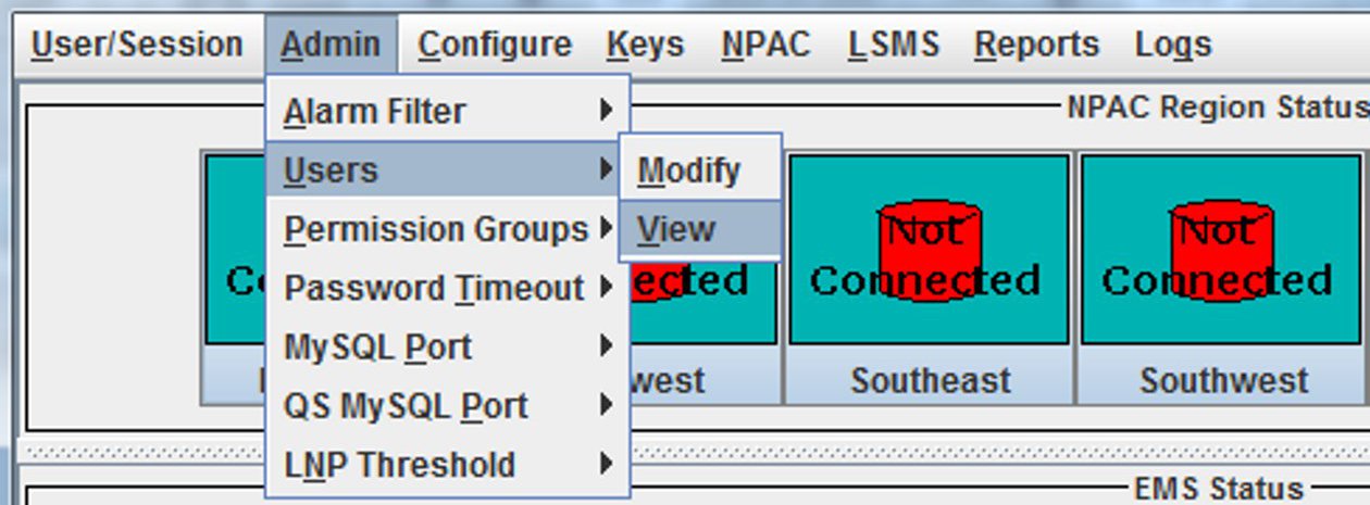

5.6.2.2 View Users
The View User dialog is used to view the permission group assignment for existing users, as described in the following procedure.
  2. From the main menu, select Admin, and then Users, and then View.
    Figure 5-16 Select Admin, and then Users, and then View
    img/t_view_users_config-fig1.jpg
  3. Click View, and the View User dialog displays.
    Figure 5-17 View User Dialog
    img/t_view_users_config-fig2.jpg
  4. Select a user, and the associated permission group is automatically selected in the Permission Group list.
  5. When you are done, click OK .

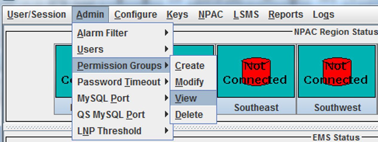

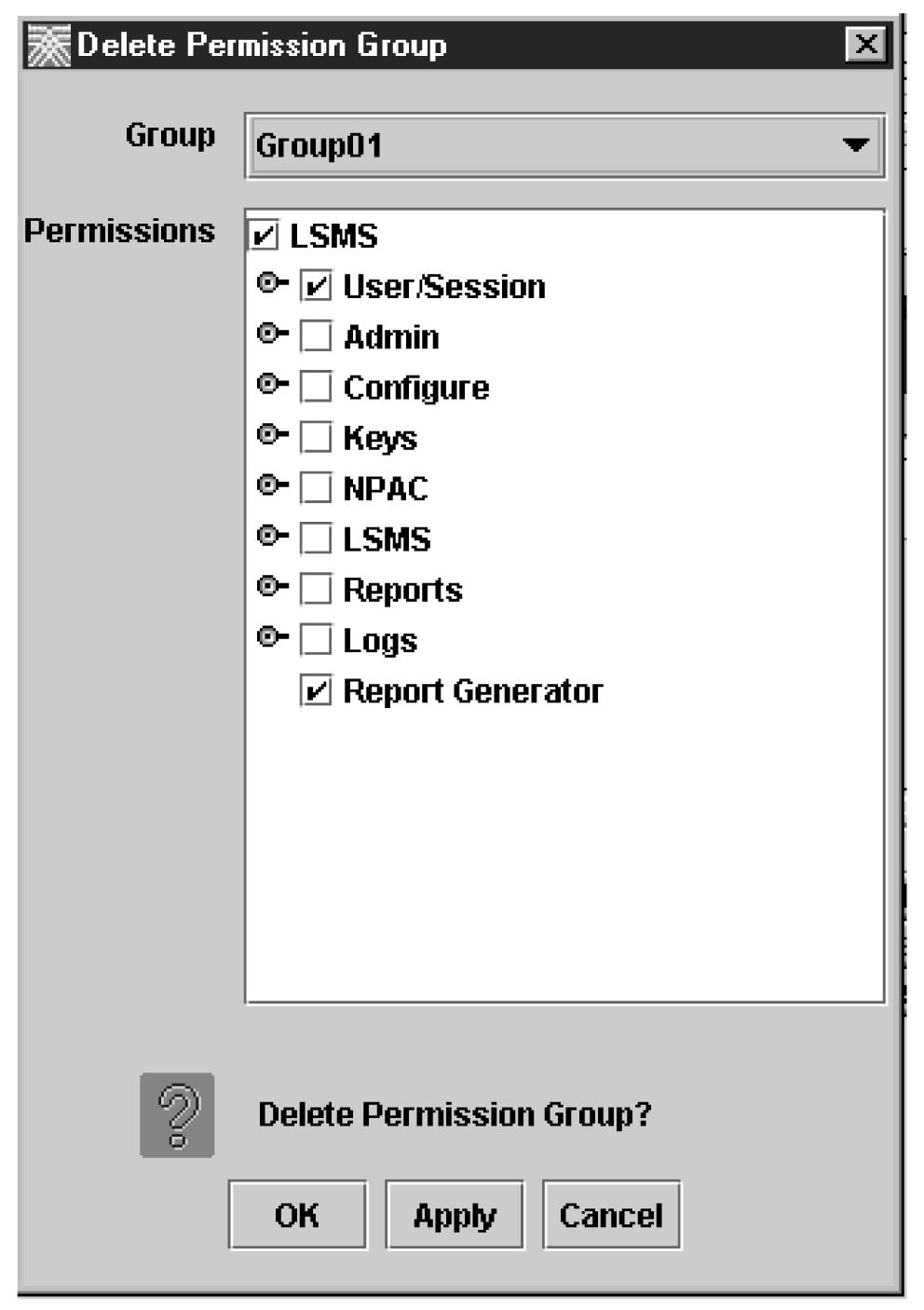

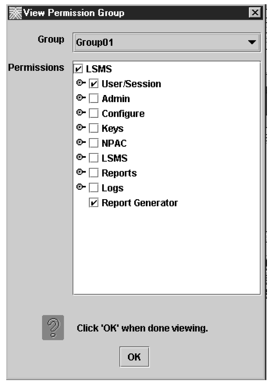

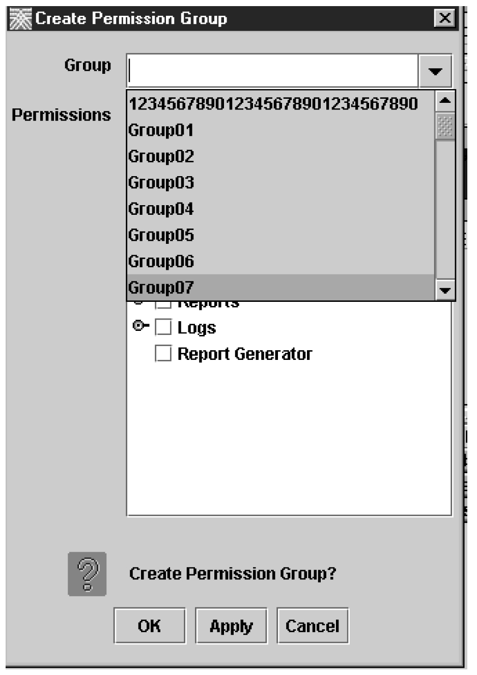

5.6.3 Permission Groups Submenu
The Permission Groups dialog is used to manage configurable permission groups. A configurable permission group is a way for the system administrator to grant a group of users access privileges for a defined set of LSMS GUI and CLAA (Command Line Administration Application) equivalent functions.
The access privileges of the five default permission groups (lsmsadm, lsmsuser, lsmsview, lsmsall, and lsmsuext) are not configurable.
The system administrator users may grant or deny command access privileges to members of a configurable permission group by selecting or deselecting menus and functions in the permissions hierarchical list by clicking on the checkbox or on its corresponding descriptive text.
  • A checked checkbox indicates that users assigned to that permission group will be granted access privileges for the corresponding GUI menus and/or functions and CLAA equivalent commands.
  • An unchecked (empty) checkbox indicates that users assigned to that permission group will not be granted access privileges for the corresponding GUI menus and/or functions and CLAA equivalent commands.
  • Sub-menus and functions are only available for selection when their higher-level menu's checkbox is checked.
  • Access privileges can be granted or revoked for every GUI menu and/or functions and CLAA equivalent commands with the exception of the User/Session menu and menu items.

5.6.3.1 Create Permission Group
The Create Permission Group dialog is used to create a new configurable permission group. You must enter a unique name for the group and select the commands that users of the group will be authorized to access. The hierarchical list of LSMS menus and command permissions is initially unselected (no access privileges granted).
To create a permission group, use the following procedure.
  2. From the main menu, select Admin, and then Permission Groups , and then Create.
    Figure 5-18 Select Admin, and then Permission Groups , and then Create
    img/t_create_permission_group_config_fig1.jpg
  3. Click Create, and the Create Permission Group dialog displays.
    Figure 5-19 Create Permission Group Dialog
    img/t_create_permission_group_config_fig2.jpg
  4. Type in a Group Name, and then select the items in the Permissions list that the users in that group will have access to.
    See Table 5-8 and Table 5-9 for information about the Create Permission Group dialog field constraints and descriptions, respectively.
  5. If you plan to create an additional permission group, click Apply.
    If not, click OK .
    When you click OK or Apply to create a configurable permission group, the group name is checked to ensure that another group has not already been defined with the same name. If the group name has already been defined, the operation will fail, and an error dialog is displayed.

5.6.3.2 Modify Permission Group
The Modify Permission Group dialog is used to modify the access privileges for existing configurable permission groups. To modify the access privileges for an existing permission group, select the group name from the group list.
To modify a permission group, use the following procedure.
  2. From the main menu, select Admin, and then Permission Groups, and then Modify.
    Figure 5-20 Select Admin, and then Permission Groups, and then Modify
    img/t_modify_permission_group_config_fig1.jpg
  3. Click Modify and the Modify Permission Group dialog displays.
    Figure 5-21 Modify Permission Group Dialog
    img/t_modify_permission_group_config_fig2.jpg

  5. If you plan to modify the access privileges for an additional Permission Group, click Apply. If not, click OK.
    If you try to modify another Permission Group's access privileges while there are unsaved changes to the access privileges for the current group, a confirmation dialog is displayed asking you to save the changes.

5.6.3.3 View Permission Group
The View Permission Group dialog is used to view access privileges for existing permission groups.
To view a permission group, use the following procedure.
  2. From the main menu, select Admin, and then Permission Groups, and then View.
    Figure 5-22 Select Admin, and then Permission Groups, and then View
    img/t_view_permission_group_config-fig1.jpg
  3. Click View, and the View Permission Group dialog displays.
    Figure 5-23 View Permission Group Dialog
    img/t_view_permission_group_config-fig2.jpg
  4. Select a Permission Group.
    The access privileges of the selected group are automatically shown in the Permissions area.
    See Table 5-12 and Table 5-13 for information about the View Permission Group dialog field constraints and descriptions, respectively.
  5. If you plan to view the access privileges for an additional Permission Group, click Apply.
    If not, click OK .

5.6.3.4 Delete Permission Group
The Delete Permission Group dialog is used to delete an existing configurable permission group.
To delete a configurable permission group, use the following procedure.
  2. From the main menu, select Admin, and then Permission Groups, and then Delete.
    Figure 5-24 Select Admin, and then Permission Groups, and then Delete
    img/t_delete_permission_group_config_fig1.jpg
  3. Click Delete, and the Delete Permission Group dialog displays.
    Figure 5-25 Delete Permission Group Dialog
    img/t_delete_permission_group_config_fig2.jpg
    See Table 5-14 and Table 5-15 for information about the Delete Permission Group dialog field constraints and descriptions, respectively.
  5. To delete an existing configurable permission group, select the name from the group list.
    If you plan to delete an additional Permission Group, click Apply. If not, click OK .
    When you click OK or Apply to delete a configurable permission group, the users' data is checked to ensure that there are no users currently assigned to the group. If one or more users are currently assigned, the operation will fail, and an error dialog is displayed.
    Default permission groups cannot be deleted.

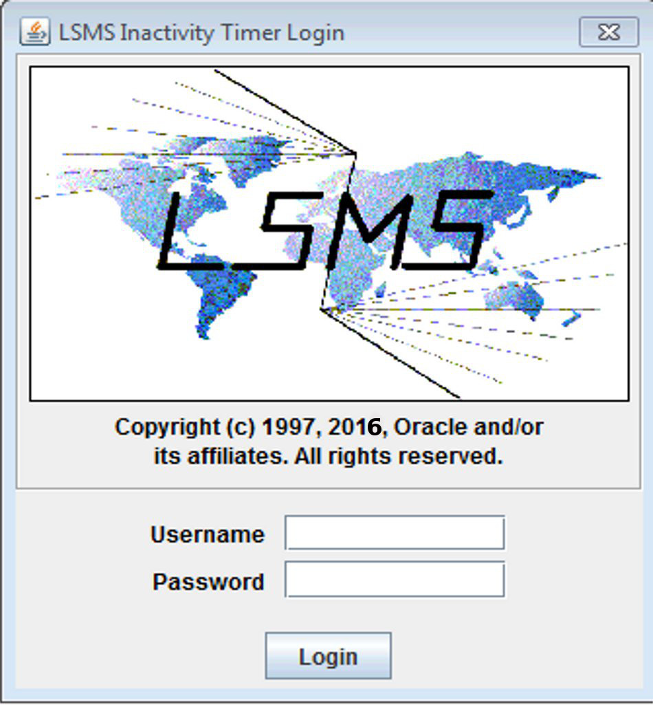

5.6.4.2 System Timer
The system timer provides an easy way to specify the same inactivity logout period, in minutes, for each LSMS GUI or Linux user. The default inactivity logout period is 15 minutes, but this logout period is configurable via the GUI.
The User Inactivity Timeout value, if set, will override the System Inactivity Timeout.
When the inactivity timer is activated, the LSMS Inactivity Timer Login window is displayed. It will accept only the username and password for the user that was last logged in.
Figure 5-26 LSMS Inactivity Timer Login Screen
img/t_system_timer_config_fig1.jpg

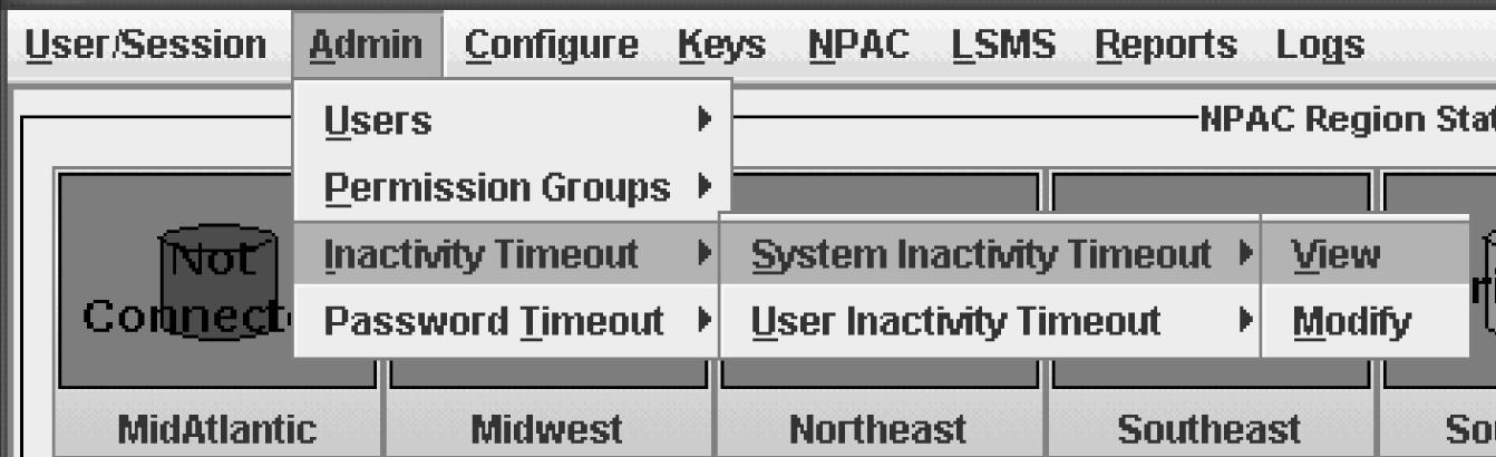

  1. Log in as a user in the lsmsadm or lsmsall group, or as a user of an authorized configurable permission group.
  2. From the LSMS Console window, select the Admin menu item.
  3. Select Inactivity Timeout, and then System Inactivity Timeout, and then View.
    Figure 5-27 Select Timeout, and then System Inactivity Timeout, and then View
    img/t_system_timer_config_fig2.jpg

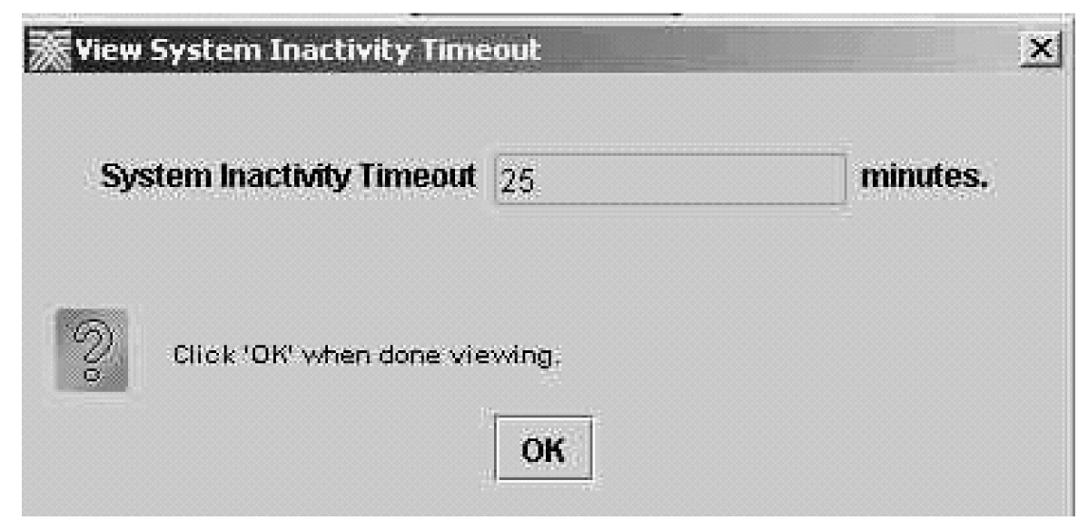

  4. Click View, and the View System Inactivity Timeout window displays.
    Figure 5-28 View System Inactivity Timeout Window
    img/t_system_timer_config_fig3.jpg
  5. Click OK when you are done viewing.

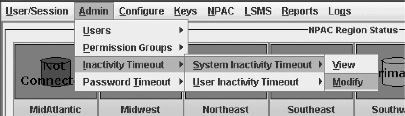

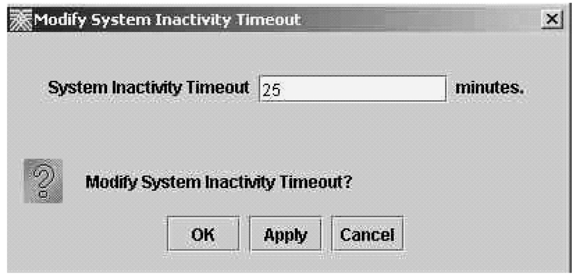

5.6.4.2.2 Modify System Inactivity Timeout
To access the Modify System Inactivity Timeout window perform the following steps:
  2. From the LSMS Console window, select theAdmin menu item.
  3. Select Inactivity Timeout, and then System Inactivity Timeout, and then Modify.
    Figure 5-29 Select Inactivity Timeout, and then System Inactivity Timeout, and then Modify
    img/t_system_timer_config_fig4.jpg
  4. Click Modify, and the Modify System Inactivity Timeout window displays.
    Figure 5-30 Modify System Inactivity Timeout Window
    img/t_system_timer_config_fig5.jpg

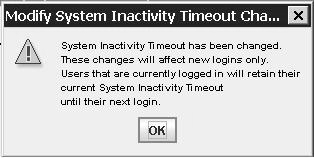

  5. Specify the number of minutes.
    A value of 0 (zero) means the timer will never expire and the user will never be logged out.
  6. Click Apply then click OK when you are done, and a window similar to the one shown in Figure 5-31 displays.
    (Click Cancel if you do not want to make or accept any changes.)
    Figure 5-31 Modify System Inactivity Timeout Change Notification Window
    img/system_inactivity_timeout.jpg

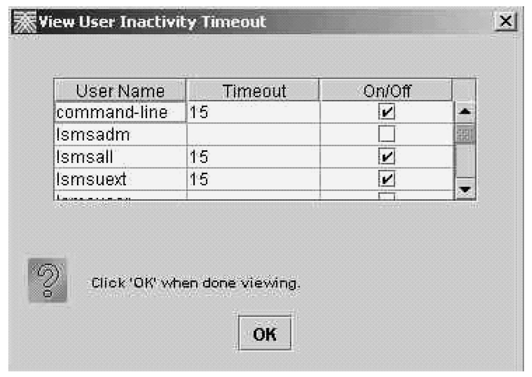

5.6.4.3 User Timer
The user timer provides an easy way to specify different inactivity logout periods, in minutes, for individual LSMS GUI and Linux users. The inactivity logout period is configurable via the GUI.
When the inactivity timer is activated, the GUI Inactivity Timer Login Screen is displayed. It will accept only the user name and password for the user that was last logged in.
5.6.4.3.1 View User Timer Inactivity Timeout

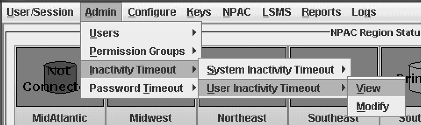

To access the View User Inactivity Timeout window, perform the following steps:
  3. Select Inactivity Timeout, and then User Inactivity Timeout, and then View.
    Figure 5-32 Select Inactivity Timeout, and then User Inactivity Timeout, and then View
    img/t_user_timer_config_fig1.jpg
  4. Click View, and the View User Inactivity Timeout window displays.
    Figure 5-33 View User Inactivity Timeout Window
    img/t_user_timer_config_fig2.jpg

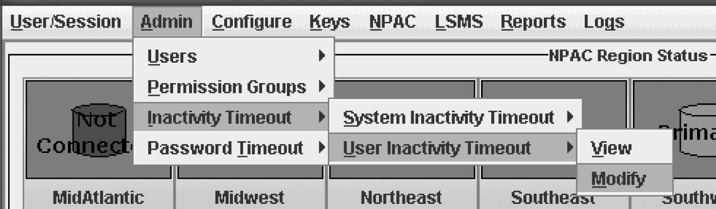

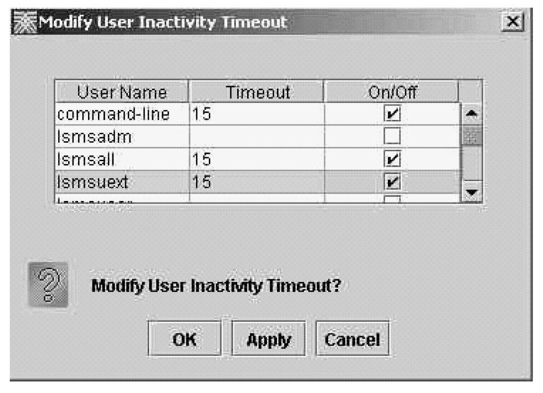

5.6.4.3.2 Modify User Inactivity Timeout
To access the Modify User Inactivity Timeout window, perform the following steps:
  3. Select Inactivity Timeout, and then User Inactivity Timeout, and then Modify.
    Figure 5-34 Select Inactivity Timeout, and then User Inactivity Timeout, and then Modify
    img/t_user_timer_config_fig3.jpg
  4. Click Modify, and the Modify User Inactivity Timeout window displays.
    Figure 5-35 Modify User Inactivity Timeout Window
    img/t_user_timer_config_fig4.jpg
  5. Do the following to make changes to the table:
    • To add a timeout entry for the first time, click the On-Off checkbox (a check appears).
      A default timeout value of 15 minutes is automatically entered in the Timeout field. To change this value, double-click the value, delete it, and type in the new value.
    • To change an existing timeout entry, double-click the timeout value, delete the existing value, and type in the new value.
    • To deactivate an existing entry, click the On/Off checkbox (the check disappears).
  6. Click Apply then click OK when you are done, and a window similar to the one shown below displays.
    Figure 5-36 Modify User Inactivity Timeout Change Notification Window
    img/user_inactivity_timeout.jpg

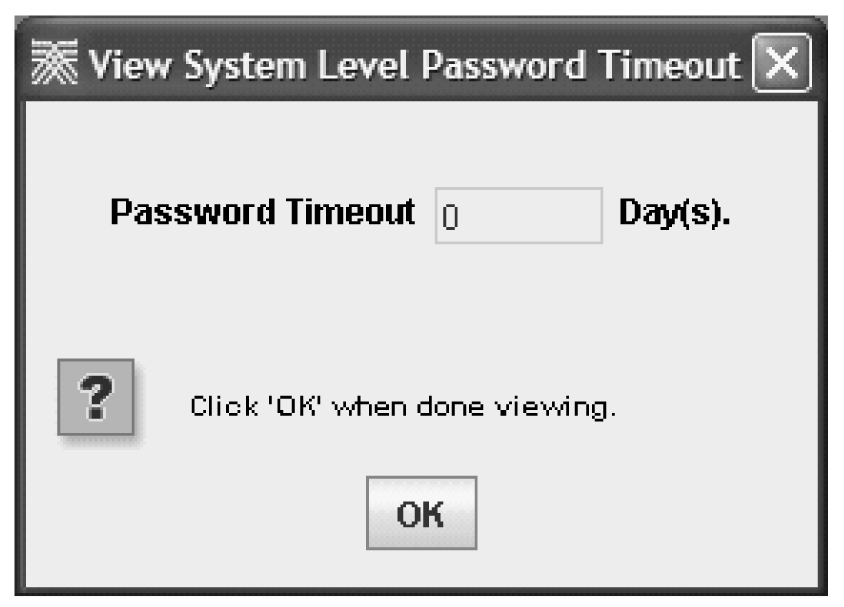

  3. Click View, and the View System Level Password Timeout dialog displays.
    Figure 5-38 View System Level Password Timeout
    img/t_view_system_level_password_timeout_config-fig2.jpg
    A password timeout value of 0 indicates the password is valid for an indefinite period of time. A password timeout value of -1 indicates the password timeout has not been configured.
  4. Click OK when you are done viewing.

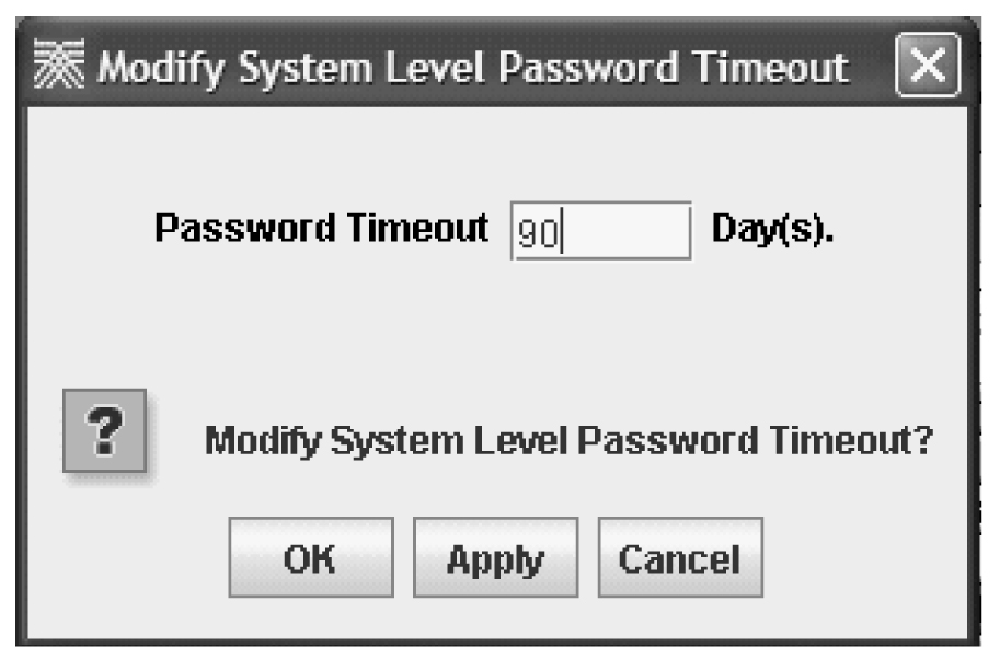

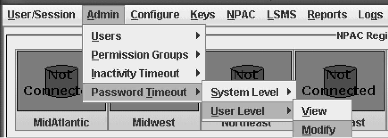

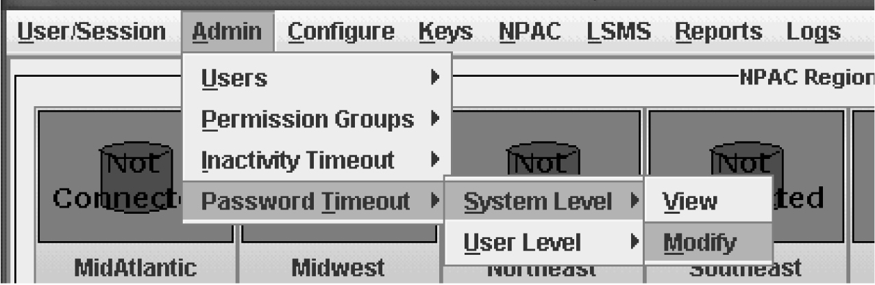

5.6.5.2 Modify System Level Password Timeout Interval
The Modify System Level dialog is used to modify the system level password timeout interval.
To modify the password timeout interval at the system level, use the following procedure:
  1. Log in to the LSMS Console as a user in the lsmsadm or lsmsall group.
  2. From the main menu, select Admin, and then Password Timeout, and then System Level, and then Modify.
    Figure 5-39 Select Admin, and then Password Timeout, and then System Level, and then Modify
    img/t_modify_system_level_password_timeout_interval_config_fig1.jpg
  3. Click Modify, and the Modify System Level Password Timeout dialog displays.
    Figure 5-40 Modify System Level Password Timeout
    img/t_modify_system_level_password_timeout_interval_config_fig2.jpg
  4. Type in the number of days for the password timeout interval, then click OK .
    If you have successfully modified the password timeout, then the Update Successful dialog displays.
    Figure 5-41 Update Successful
    img/t_modify_system_level_password_timeout_interval_config_fig3.jpg
  5. Click OK .
5.6.5.3 View User Level Password Timeout
The View User Level dialog is used to view the user level password timeout interval.
To view password timeout intervals at the user level, use the following procedure:
  2. From the main menu, select Admin, and then Password Timeout, and then User Level, and then View.
    Figure 5-42 Select Admin > Password Timeout > User Level > View

5.6.5.4 Modify User Level Password Timeout Interval
The Modify User Level dialog is used to modify the user level password timeout interval.
To modify password timeout intervals at the user level, use the following procedure:
  2. From the main menu, select Admin, and then Password Timeout, and then User Level, and then Modify.
    Figure 5-44 Select Admin, and then Password Timeout, and then User Level, and then Modify
    img/t_modify_user_level_password_timeout_interval_config_fig1.jpg
  3. Click Modify, and the Modify User Level Password Timeout dialog displays.
    Figure 5-45 Modify User Level Password Timeout
    img/t_modify_user_level_password_timeout_interval_config_fig2.jpg
  4. Select a User whose password timeout interval you want to modify.
  5. Type in the number of days for the password timeout interval, then click OK .
    Figure 5-46 Update Successful
    img/t_modify_user_level_password_timeout_interval_config_fig3.jpg
  6. Click OK .

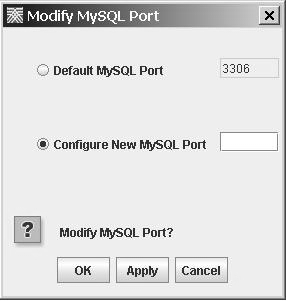

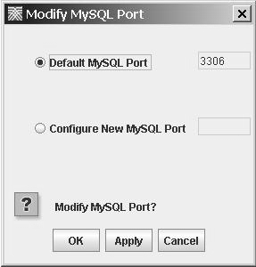

5.6.6.2 Modify MySQL Port
  2. From the main menu, select Admin, and then MySQL Port, and then Modify.
    The Modify MySQL Port dialog appears.
    Figure 5-47 Modify MySQL Port
    img/modify_mysql_port.jpg
    The default MySQL port is 3306. If the port has not been modified from the default setting, the Default MySQL Port radio button will be selected when the dialog appears.
  3. Select the Configure New MySQL Port radio button to configure a new port.
    img/modify_mysql_port_config_new.jpg
  4. Enter a new MySQL Port number.
  5. Click Apply to save the changes and remain in the current window, or skip to 6.
    A Confirm Modify dialog appears.
    1. Click Yes to modify the MySQL port.
      A dialog box appears with the message: These changes will not be effective until the LSMS application has been stopped and restarted on both LSMS servers.
      See Stopping the Node, Starting the Node, and Updating MySQL Port on MySQL Server for more information.
    2. Click Cancel to close the dialogue box. Your changes have been saved.
  6. Click OK to save the changes and return to the LSMS Console.
    2. Click OK.

5.6.6.2.1 Stopping the Node
After you modify the MySQL port, you must stop and restart the LSMS application on both LSMS servers for the changes to take effect.
Perform this procedure on the ACTIVE LSMS server first, then on the STANDBY LSMS server.
  1. Log in as lsmsmgr user. See Logging In to LSMS Server Command Line for more information.
    The lsmsmgr text interface appears.
  2. Select Maintenance and press Enter.
  3. Select Stop Node and press Enter.
  4. Select Yes to confirm the node stop and press Enter.
  5. Select Exit and press Enter to return to the Main Menu.
  6. Select Exit and press Enter to exit the lsmsmgr text interface.

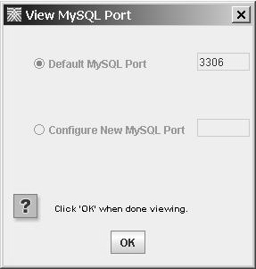

5.6.6.3 View MySQL Port
  2. From the main menu, select Admin, and then MySQL Port, and then View.
    The View MySQL Port dialog appears.
    Figure 5-48 View MySQL Port
    img/view_mysql_port.jpg
  3. Click OK to return to the LSMS Console.
5.6.7 LNP Threshold Submenu
The LNP quantity threshold is an alarm that is raised when the database storage capacity has been reached. LNP quantity threshold can be modified or viewed through the LSMS GUI.
5.6.7.1 Modify LNP Threshold
  2. From the main menu, select Admin, and then LNP Threshold, and then Modify.
    The Modify LNP Quantity Threshold dialog appears.
    Figure 5-49 Modify LNP Threshold
    img/modify_lnp_threshold.jpg
  3. Enter the LNP_QTY_THRESHOLD percentage.
    The LNP threshold is a configurable percentage of database storage capacity. An alarm is raised when the database storage capacity has been reached.
  4. Click Apply to save the changes and remain in the current window, or skip to 5.
    1. Click Cancel to close the dialogue box. Your changes have been saved.
  5. Click OK to save the changes and return to the LSMS Console.
    Table 5-17 Modify LNP Threshold - Field Constraints
    LNP_QTY_THRESHOLD
    Text field
    Range: 1 to 99 percent

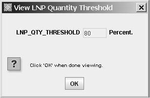

5.6.7.2 View LNP Threshold
  2. From the main menu, select Admin, and then LNP Threshold, and then View.
    The View LNP Quantity Threshold dialog appears.
    Figure 5-50 View LNP Threshold
    img/view_lnp_threshold.jpg

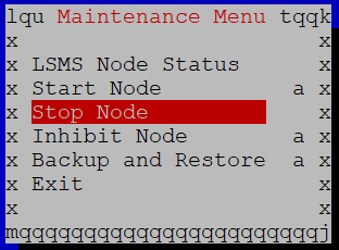

  2. Shutdown both the LSMSPRI and LSMSSEC nodes.
    1. Login to LSMSMGR menu on LSMSPRI and go to Maintenance Menu and then Stop Node.
      Figure 5-51 Main Menu
      Main Menu
      Figure 5-52 Stop Node
      Stop Node
    2. Repeat the same steps to stop the node on LSMSEC server. Login to LSMSMGR menu and then go to the Maintenance Menu and then Stop Node.

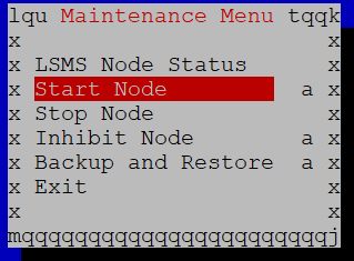

  6. Start both LSMSPRI and LSMSSEC nodes.
    1. Login to LSMSMGR menu on LSMSPRI and go to Maintenance Menu and then Start Node.
      Figure 5-53 Maintenance
      Maintenance
    2. Select Start Node from the menu.
      Figure 5-54 Start Node
      Start Node
    3. Repeat step 6 to start node on the LSMSSEC server.
      Figure 5-57 Maintenance
      Maintenance
      Figure 5-58 Start Node
      Start Node
