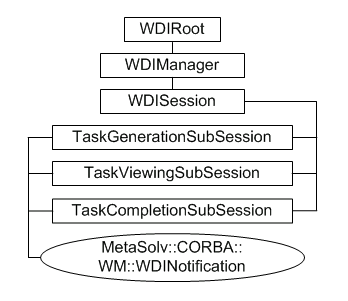

Figure 14-1 shows the relationship of the interfaces within the Work Management API.

See "Common Architecture" for more information on the WDIManager interface.WMSession Interfaces
Table 14-2 lists the three operations that comprise the WMSession in the WDIWM.IDL file.
