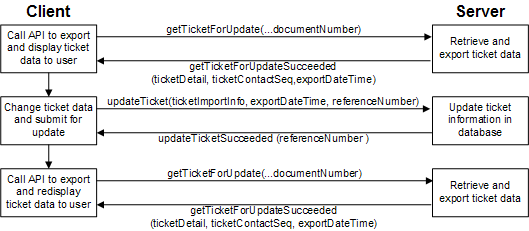

  • updateTicket
    Deprecated. Replaced by updateTicket_v2.
  • updateTicket_v2
    This operation updates attributes for an existing trouble ticket. This operation supports new service item types of Network Element, Network System, and Circuit/Connection. See "The updateTicket_v2 Operation" for more information.
  • getTicketForUpdate
    Deprecated. Replaced by getTicketForUpdate_v2.
  • getTicketForUpdate_v2
    This operation gets information for a ticket so that an update can be requested. It returns a structure of updateable ticket fields that may be modified and passed to the updateTicket_v2 operation. It also returns the date and time of the report, which must be passed to the updateTicket_v2 operation in order to verify that the ticket has not changed since the information was retrieved.

Process Flow for Updating a Trouble Ticket
This process flow demonstrates how your client application and the Trouble Management API server must interact to update a trouble ticket.
Figure 13-1 illustrates the process flow for updating a trouble ticket.
Figure 13-1 Process Flow for Updating a Trouble Ticket
The process flow for updating a trouble ticket is as follows:
  1. The client calls the getTicketForUpdate operation to retrieve trouble ticket information.
  2. The server calls the getTicketForUpdateSucceeded operation to return a TicketInfoForUpdate structure, which includes one structure of attributes that are updateable and another structure of attributes that are read-only. The structure also includes the date and time of the export.
  3. The client makes modifications to the updateable data and calls the updateTicket operation, passing it the modified UpdateableTicketInfo structure. In addition to the WDITransaction and WDINotification objects, the updateTicket operation is passed the following parameters:
    • The TicketImportInfo structure. This structure includes the ticket's document number and ticket ID.
      You must pass either document number or ticket ID. If document number is passed, ticket ID is ignored. If you pass neither, an exception is returned.
    • The UpdateableTicketInfo structure with any modifications.
    • A ServiceItemSeq sequence, which is populated only if the service item is changed. Only one ServiceItem structure can be passed. If more than one structure is passed, an exception is returned.
    • A LogNoteInfoSeq sequence, which is included if the update includes log notes.
    • A duplicateTicketAllowed Boolean that indicates whether a change to the service item is allowed if another open ticket is found for the same service item. Both the ticket found and the ticket being updated have a ticket type that identifies repeat and chronic trouble (as defined for the ticket type in the MetaSolv Solution Infrastructure). If it is set to false, an exception is returned if another open ticket exists. The client can initially set it to false, and if an exception is returned, present a message to the user asking if they wish to create the ticket anyway (similar to the functionality in MetaSolv Solution). If so, the UpdateTicket operation can be called again with duplicateTicketAllowed set to true.
    • The export date and time that was returned from the export. The Trouble Management API server uses this date and time to throw an exception if the ticket was updated by some other process since the ticket information was first exported.
  4. The Trouble Management API server processes the update and indicates success or failure by calling either the updateTicketSucceeded operation or the operationFailed operation on WDINotification object.
  5. Upon the successful update of the ticket, the client application should refresh its user interface by again retrieving the ticket attributes using the getTicketForUpdate operation. This action resets the export date and time.
This section provides information about the updateTicket_v2 operation.
Updateable Ticket Attributes
When the getTicketForUpdate_v2 opeationis run successfully, the operation returns a TicketInfoForUpdate structure which contains an UpdateableTicketInfo structure and a ReadOnlyTicketInfo structure. The trouble ticket attributes you can change through the updateTicket_v2 operation are contained in the UpdateableTicketInfo structure. For each ticket attribute that is changed, a log entry is created with an audit note.
The updateTicket_v2 operation also accepts an unlimited sequence of log notes. Each note can be up to 2,000 characters long. The Trouble Management subsystem displays log notes along with any audit notes that are generated by the Trouble Management API.
In the Trouble Management subsystem, when the Responsible Org, Resp Org Assigned To, Administrative Org, or Admin Org Assigned To are changed on a ticket, a log note is required. The Trouble Management API does not require a log note when these fields are changed through the updateTicket_v2 operation. If necessary, this may be enforced by the client.
ExportDateTime Field is Used to Check Concurrency
The export date and time (aExportDateTime) returned by the getTicketForUpdate_v2 succeeded notification (getTicketForUpdateSucceeded)is in the database server's time zone. You passed this information back unchanged in the updateTicket _v2 operation and the API uses it to verify that the ticket has not been updated since the read operation in the getTicketForUpdate_v2. If the ticket has been updated after the getTicketForUpdate_v2 read, then an exception is returned.

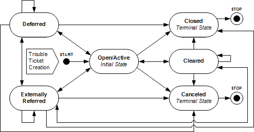

Permitted Trouble Ticket State Changes
MetaSolv Solution users can change the ticket state of trouble tickets through menu selections within the Trouble Management subsystem.
Figure 13-2 illustrates the ticket state changes permitted by the Trouble Management subsystem.
Figure 13-2 Ticket State Changes Permitted By The Trouble Management Subsystem
The rules that govern ticket state changes through the Trouble Management subsystem are listed below:
  • Tickets are created in the Open/Active state.
  • Open Active tickets can be changed to any ticket state except Open Active.
  • Deferred tickets can be changed to any ticket state except Cleared.
  • Externally Referred tickets can be changed to any ticket state.
  • Cleared tickets can be changed to any ticket state except Deferred.
  • Closed and Canceled tickets cannot change state.
Closed and canceled are terminal states. Once a trouble ticket is placed in one of these states, the ticket state can never be changed again. Non-reporting details for a closed or canceled trouble ticket can be added or edited. Reportable details cannot be added or edited, except as permitted by the setting of the Allow Editing of Task Completion Date Within the Grace Period preference.

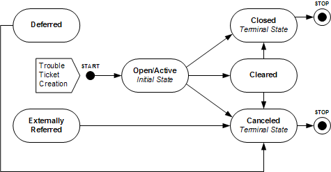

The Trouble Management API enables you to use the updateTicket_v2 operation to change trouble ticket statuses, but only for a subset of the status changes possible through MetaSolv Solution.
Figure 13-3 illustrates the ticket state changes permitted by the Trouble Management API.
Figure 13-3 Ticket State Changes Permitted by The Trouble Management API
The rules that govern ticket state changes through the Trouble Management API are listed below:
  • Tickets are created in the Open/Active state using the createTicket_v3 operation.
  • Open Active tickets can be changed to Cleared, Closed, and Canceled.
  • Deferred and Externally Referred tickets an only be changed to Canceled.
  • Cleared tickets can be changed to Closed and Canceled.
  • Closed and Canceled tickets cannot change state The updateTicket operation does not permit changes to closed or canceled tickets.
