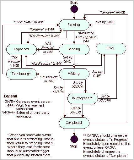

Figure 2-1 provides a view of the lifecycle of event statuses from the point of view of the MetaSolv Solution, and illustrates the function of the Gateway Event server.
Figure 2-1 State Transition Diagram for Gateway Events
Description of Figure 2-1 follows
Description of "Figure 2-1 State Transition Diagram for Gateway Events"
See "Parameters for gateway.ini File" for descriptions of these parameters. Table 2-4 lists the server processes.

Gateway Events Through Integration Server
Gateway Events through integration server continuously check the MSS database for events that are ready to be sent to an external application. The integration server also monitors the external application for updates to the status of a gateway event. When an external application sends a status update, the integration server records the new status in the MSS database.
In case of a cluster environment, Oracle recommends that you copy the integration.xml file (with added integration events) to any CORBA gateway event server (EVENTPROC) appserver to ensure that the CORBA gateway event server does not pick up the integration gateway events.
The following sections describe how to create a gateway event for communication between MSS and an external application.
Creating a Gateway Event
To create a gateway event:
  1. Create a new gateway event.
    For example: xxx_order_event.
    This is done in the Gateway window in MSS. MSS creates a gateway event and assigns an event ID.
