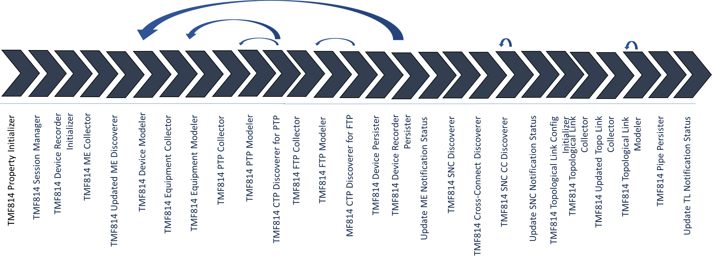

Figure 2-1 illustrates the processors workflow of the Discover Abstract TMF814 action.
Figure 2-1 Discover Abstract TMF814 Action Processors
The Abstract TMF814 action is configured with the isIncrementalScanEnabled condition. When this condition is met, the corresponding processors will run.

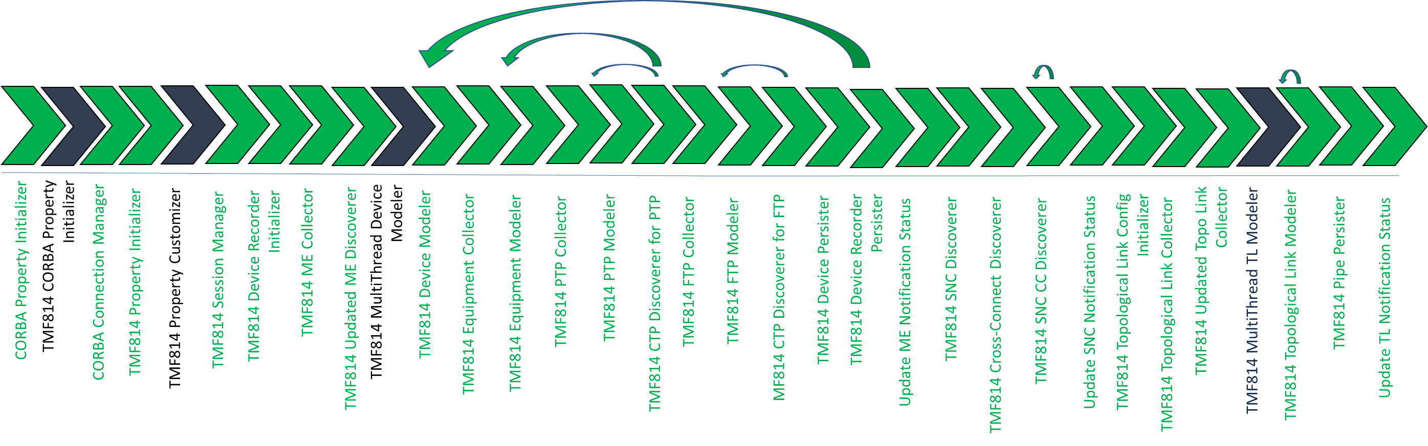

Discover TMF814 Action
This action, which extends the Discover Abstract TMF814 actions, is a complete and deployable action, configured using scan parameters, so you have full control over what is and is not discovered. This action can be extended to add new scan parameters, but the original scan parameters must remain. This action can also be extended to discover additional types of network and connectivity objects.
This discovery action inherits all the processors from the following actions:
The Discover Abstract CORBA action
For information about the inherited processors in this action, see Network Integrity CORBA Cartridge Guide.
The Discover Abstract TMF814 action
For information about the inherited processors in this action, see "Discover Abstract TMF814 Action".
The Discover TMF814 action contains the following processors run in the following order:
CORBA Property Initializer (inherited)
CORBA Connection Manager (inherited)
TMF814 Property Initializer (inherited)
TMF814 Session Manager (inherited)
TMF814 Device Recorder Initializer (inherited)
TMF814 ME Collector (inherited)
TMF814 Updated ME Discoverer (inherited)
TMF814 Device Modeler (inherited)
TMF814 Equipment Collector (inherited)
TMF814 Equipment Modeler (inherited)
TMF814 PTP Collector (inherited)
TMF814 PTP Modeler (inherited)
TMF814 CTP Discoverer for PTP (inherited)
TMF814 FTP Collector (inherited)
TMF814 FTP Modeler (inherited)
TMF814 CTP Discoverer for FTP (inherited)
TMF814 Device Persister (inherited)
TMF814 Device Recorder Persister (inherited)
Update ME Notification Status (inherited)

Figure 2-2 illustrates the processors workflow of the Discover Abstract TMF814 action.
Figure 2-2 Discover TMF814 Action Processors
TMF814 CORBA Property Initializer
This processor reads the ORBProperties and ORBArguments parameters from the UI and passes them to the CORBA Connection Manager processor through the corbaSeed. ORBProperties and ORBArguments are used during ORB initialization.
See Network Integrity CORBA Cartridge Guide for information about ORBProperties and ORBArguments.
TMF814 Property Customizer
This processor takes scan parameters for a specific scan and assigns them to properties in the TMF814 Property Initializer processor. See Table 7-3 for a list of available scan parameters.
TMF814 MultiThread Device Modeler
This processor models logical and physical device entities, collects and models equipments, collects and models PTPs and respective CTPs, and collects and models FTPs and the corresponding CTPs. It creates logical and physical device entities and persists to the result.
This processor verifies whether a scan is configured with the Parallel Process option enabled. If not enabled, the processor skips the process.
This processor uses WebLogic's ManagedExecutorService work-manager concept to process it in parallel. For more information, see Working with Application Context Work-Managers in NI Developer's Guide.
TMF814 MultiThread TL Modeler
This processor models topological link objects according to the Optical Model for Network Integrity, and adds it to the result group and persists the results.
This processor verifies whether a scan is configured with the Parallel Process option enabled. If not enabled, it skips the process.
This processor uses WebLogic's ManagedExecutorService work-manager concept to process it in parallel. For more information, see the Working with Application Context Work-Managers section in NI Developer's Guide.
