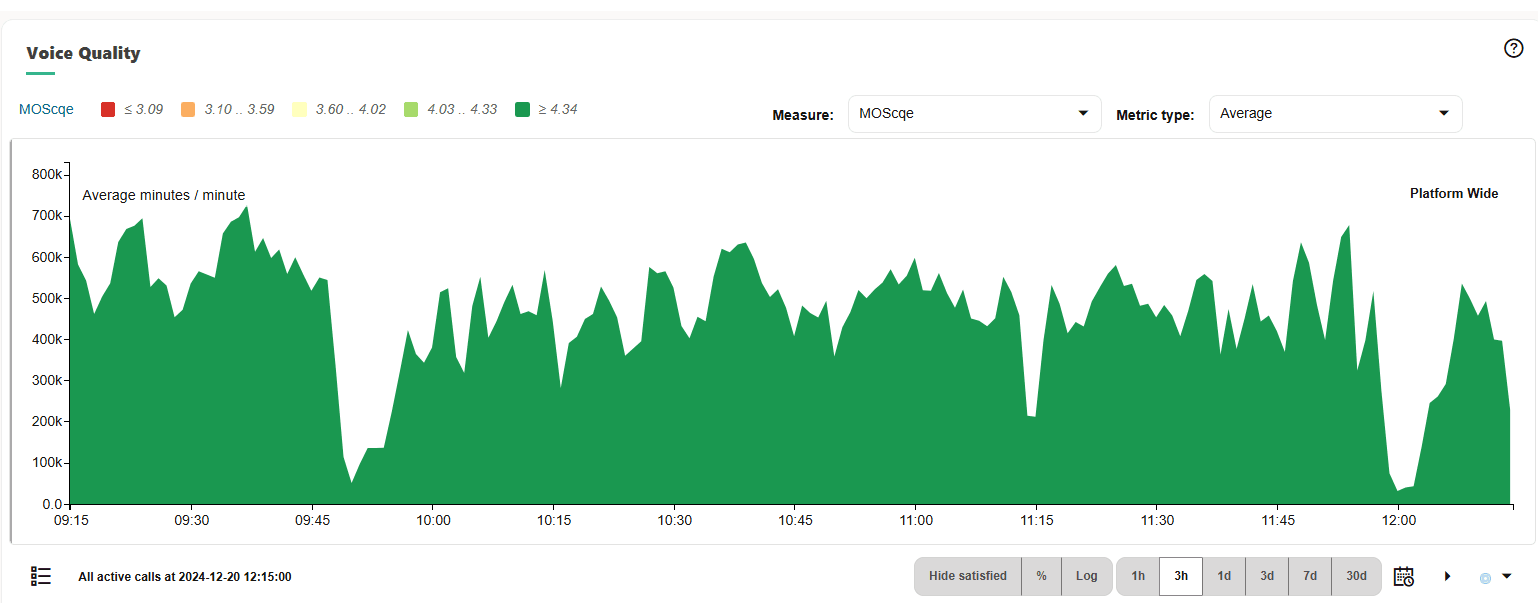

Voice Quality Chart for MOS
The Voice Quality page shows a stacked area chart for the MOS measure. Five series are displayed, each based the levels of user satisfaction as specified by ITU recommendation G.107.
  • Very satisfied: MOS >= 4.34
  • Satisfied: 4.03 <= MOS <= 4.33
  • Some users dissatisfied: 3.60 <= MOS <= 4.02
  • Many users dissatisfied: 3.10 <= MOS <= 3.59
  • Nearly all users dissatisfied: MOS <= 3.09
We analyze the quality of a media stream over a time interval of either one or 15 minutes (determined by the Voice Quality Chart Scale in Minutes/Minute system setting) and determine how many minutes and seconds were spent in each of the above MOS ranges. For more information, see "Voice Quality Chart Scale in Minutes/Minute" .
Over a minute a stream may have had 40 seconds with a MOS of >= 4.34, 10s between 4.34 and 4.03, and another 10s between 3.60 and 3.10. If using a 15 minute interval, the values are normalized accordingly to project the average minute and seconds over a 15 minute time period.
In this case, with 40 seconds over one minute of MOS of >= 4.34 is 00:40 minutes, but normalized over a 15 minute interval it is 10:00 minutes.
We sum up all the minutes of MOS >= 4.34 across all active media streams. This determines the height of the area labeled >= 4.34 at T=12:01.
The chart's resolution and range can be controlled with the toolbar directly below it.
Figure 4-44 Voice Quality Chart for MOS
Voice quality chart for MOS

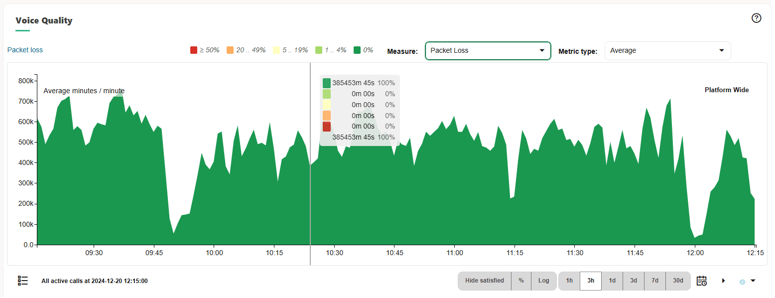

Voice Quality chart for Packet Loss
The Voice Quality page shows a stacked area chart for the Packet Loss measure. Five series are displayed, each based on the levels of packet loss rated computed based on the raw RTP traffic.
  • Very satisfied: PL <=0%
  • Satisfied: 1% <= PL <= 4%
  • Some users dissatisfied: 5% <= PL <= 19%
  • Many users dissatisfied: 20% <= PL <= 49%
  • Nearly all users dissatisfied: PL >= 50%
We analyze the quality of a media stream over a time interval of either one or 15 minutes (determined by the Voice Quality Chart Scale in Minutes/Minute system setting) and determine how many minutes and seconds were spent in each of the above Packet Loss ranges. ranges. For more information, see "Voice Quality Chart Scale in Minutes/Minute"
Figure 4-45 Voice Quality Chart for Packet Loss

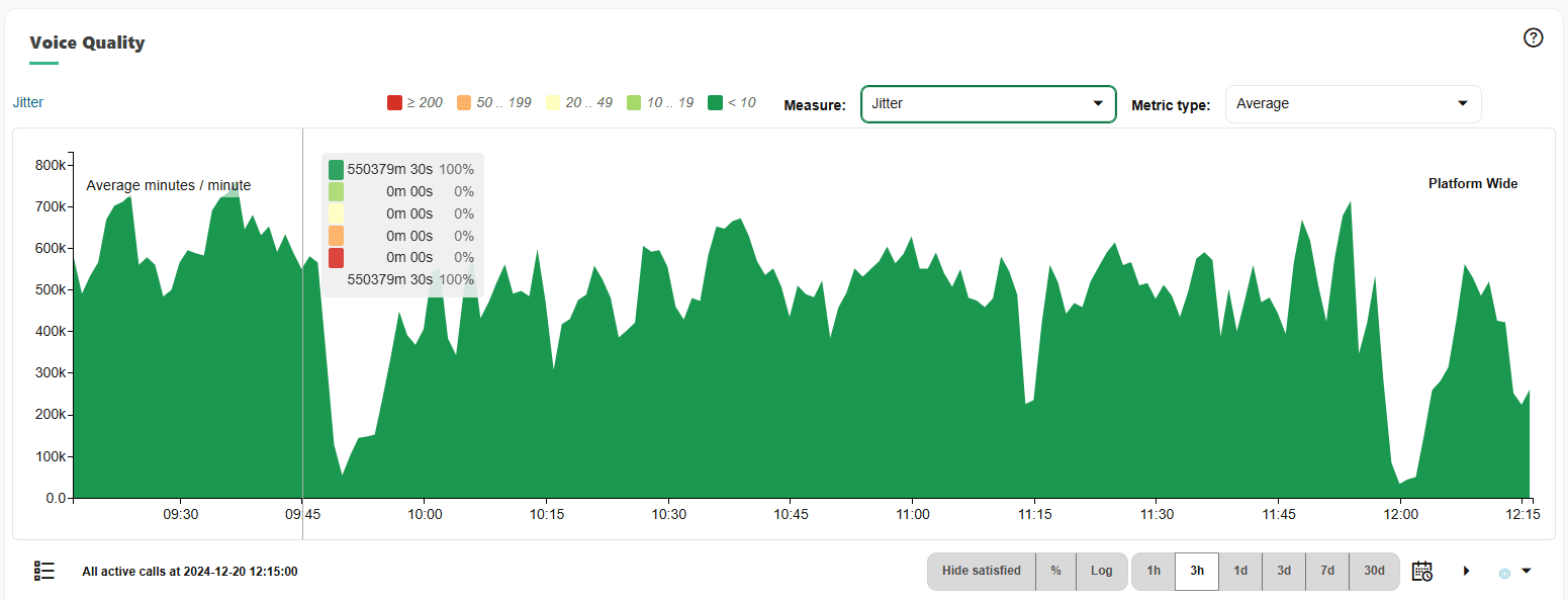

Voice Quality Chart for Jitter
The Voice Quality page shows a stacked area chart for the Jitter measure. Five series are displayed, each based the levels of Jitter computed based on the raw RTP traffic.
  • Very satisfied: Jitter < 10 msec
  • Satisfied: 10 msec <= Jitter <= 19 msec
  • Some users dissatisfied: 20 msec <= Jitter <= 49 msec
  • Many users dissatisfied: 50 msec <= Jitter <= 199 msec
  • Nearly all users dissatisfied: Jitter >= 200 msec
We analyze the quality of a media stream over a time interval of either one or 15 minutes (determined by the Voice Quality Chart Scale in Minutes/Minute system setting) and determine how many minutes and seconds were spent in each of the above Jitter ranges. For more information, see "Voice Quality Chart Scale in Minutes/Minute".
The chart's resolution and range can be controlled with the toolbar directly below.
Figure 4-46 Voice Quality chart for Jitter
Voice quality chart for Jitter

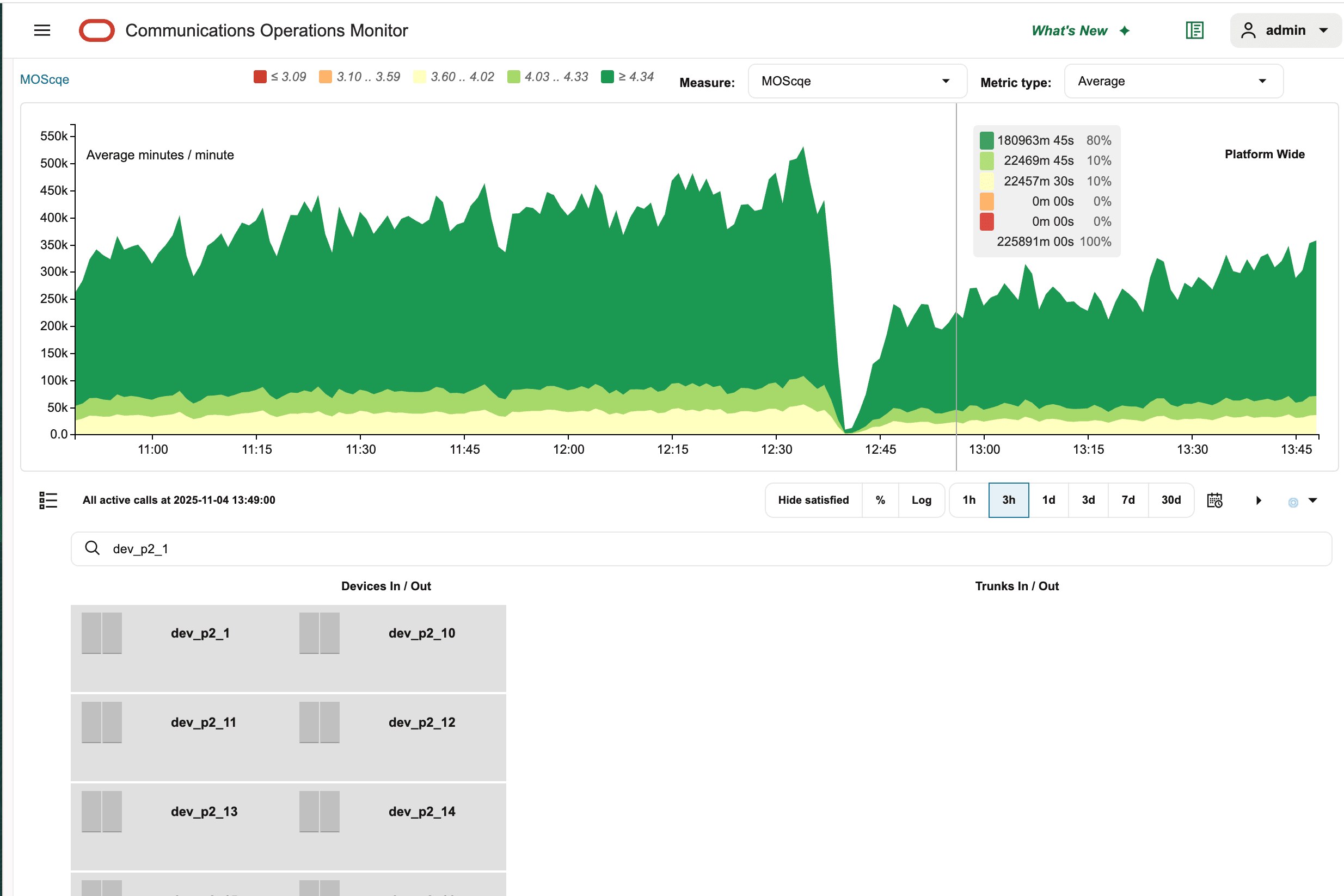

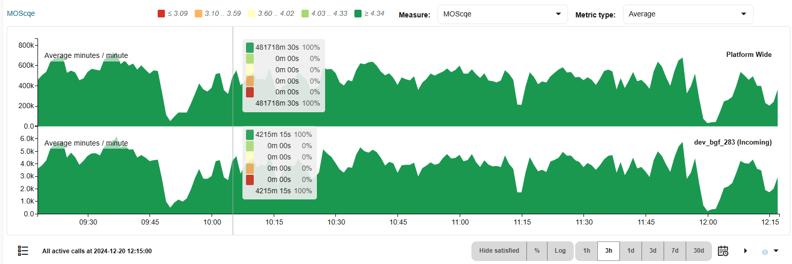

Voice Quality Charts Per Device
To help diagnose areas of particularly bad MOS, clicking on the main chart at time T loads the Voice Quality data for all platform devices at that time. The MOS stats for a device are displayed next to it. The devices are sorted by MOS quality, those with bad quality at the selected time are listed first.
Clicking on a device augments the main chart with a second chart displaying the Voice Quality for the currently active time resolution and range.
Figure 4-47 Voice Quality per Device
Voice Quality Chart Per Device
The following two voice quality charts are available for each device, trunk, and IP tag:
  • Distribution of incoming calls by MOS ranges, packet loss ranges, and Jitter ranges over the time.
  • Distribution of outgoing calls by MOS ranges, packet loss ranges, and Jitter ranges over the time.
