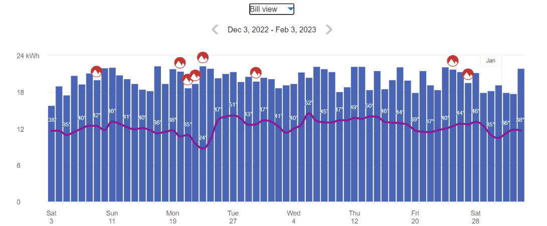

  • Bill view: Energy use by each day in a bill period, as well as the day with the highest demand. AMI data is required for this view.

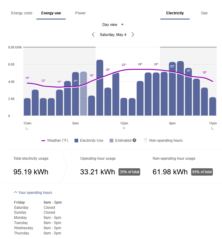

  • Day view: Energy use by each hour of a day, as well as the interval with the highest demand. AMI data is required for this view.

In the bill and day views, an icon is displayed over the day or interval when demand was at its peak. Demand refers to the rate at which a business consumes electricity, not the actual amount that is consumed. This means that the day or interval with the peak demand icon may not always be the same as the day or interval with the highest amount of energy use. See Demand Versus Energy Use for more information about the difference between these units of measure.
The peak demand icon can also be shown in the Power View of the Data Browser to indicate the highest demand interval within a specific day. Additionally, there are cases when Multiple Peak Demand Icons can be displayed.

Operating Hours
For business customers who have subdaily smart meter (AMI) data, an additional insight about operating hours displays below the bar graph when the Day view is selected. The insight shows the total daily energy usage, operating hour usage, and non-operating hour usage. The operating hour and non-operating hour details are based on what is entered in the Business Profile. This information helps business customers understand how their energy usage is related to the times when they are open and closed for business.
This image shows an example of the operating hours insight below the energy use bar graph. The insight shows how much energy was used during operating hours and non-operating hours.
The bar graph displays extra background shading for non-operating hours of the day so that business customers have an additional visual reference point for their usage. At the bottom of the insight, an expandable menu displays the operating hours for quick reference.
If the business customer hasn’t added any operating hours yet, no data is displayed, and a link appears to prompt the customer to add the hours in their profile.
If the demand values for two or more days or subdaily intervals are the same, and these values technically represent the highest demand, then multiple peak demand icons are displayed in the Energy Use view.
Example screenshot of a graph showing daily electricity use as bars and weather as a line. Highest demand days are marked with icons, and a legend explains symbols for electricity use, weather, and demand days.
This may be the case, for example, at commercial or industrial locations where a specific set of high-power machinery or equipment needs to be turned on at regular points in time, resulting in a demand spike that consistently reaches the same amount multiple times in the same bill period.

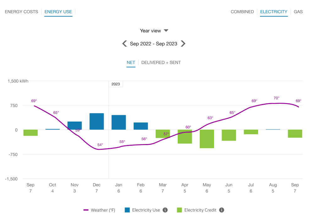

Net Tab: The Net tab displays the business customer’s final amount of energy consumption or energy generation for a given interval of time. It is determined by subtracting the business customer’s solar power generation amount from their energy consumption amount. If the business customer has a net usage amount, it is displayed as electricity use. If the business customer has a net generation amount, it is displayed as an electricity credit.
Example screenshot of a yearly energy use chart, showing electricity use as bars, electricity credits as negative bars, and weather as a line. The chart includes a legend for each data type.

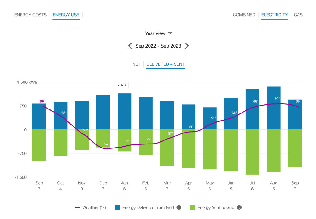

Delivered + Sent Tab: This tab displays the business customer’s energy consumption and production data in the same time interval on the horizontal axis of the graph. “Sent” refers to energy sent to the grid through solar technology. “Delivered” refers to energy delivered from the grid to the business customer’s premise.
Example screenshot of a yearly electricity usage chart with bars for energy delivered from the grid and energy sent to the grid, plus a weather trend line. The chart includes has a legend for each data type.
