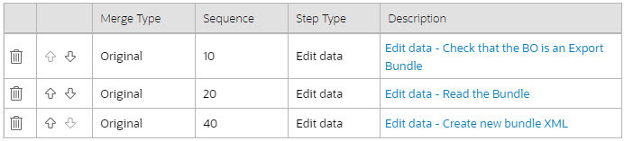

If you want to remove a record linked to the Original script, click the delete button to the left of the record.
For example, to remove the Reset existing bundle
XML step, click the
icon.
After removal, the grid displays:

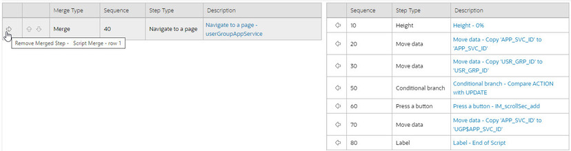

You can move any of the steps from the Merge From script to the Original Script by clicking the left arrow adjacent to the desired step. Once a record is moved it disappears from the Merge From information and appears in the Original information with the word Merge in the Merge Type column.
For example, to copy the Navigate to a page step, click the left arrow.
The step is moved to the left portion of the page.
