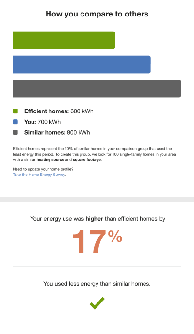

Progress Three-Bar Neighbor Comparison Graph
This image is an example of the Three-bar Neighbor Comparison module, which is a part of most standard report types.
Heading: The heading notifies the customer that the Three-Bar Neighbor Comparison gives them a comparison of their energy use to similar homes.
Bar Chart: The bar chart displays how much energy each group in the comparison used. Typically, the bar with the smallest value is on top and the bar with the largest value is on the bottom.
- You: This bar indicates how the customer is doing. This is often a color that corresponds to the utility brand color.
- Similar Homes: This bar indicates how all the customer's neighbors are doing. It is usually a gray or neutral color. The energy use data that is shown is the mean energy use value.
- Efficient Homes: This bar displays a usage value for the most efficient 20% of the customer's similar homes. It is usually colored green because green is commonly associated with energy efficiency. Note that the efficient homes value that appears in the module is not an average of the top 20% of similar homes. A threshold value—the 20th percentile of similar homes—is used to determine the efficient homes value. Efficient homes are not chosen in advance.
Legend: A legend included below the graph indicates what portions of the graph indicate the customer's home energy use , efficient homes, and similar homes.
Explainer Text: The explainer text indicates what data goes into the comparison graph and provides the customer with a way to improve or correct these details in the Home Energy Analysis.
- Great: Less than or equal to Efficient Homes.
- Great: Close to Efficient Homes.
- Good: About the same as Similar Homes.
- Good: Lower than Similar Homes.
- Fair: More than Similar Homes.
Top Insight: The top insight displays a percentage for either how much more or less the customer used compared to their "efficient homes. For example, "29% more electricity than efficient homes." The percentage color changes depending on where the customer's usage falls on the Benchmark Module gauge. If the customer's usage is "great" or "good" the percentage is green. If the customer's usage falls in the "fair" range, the percentage is orange. By default the percentage threshold for the top insight is >100%. When the threshold is exceeded, alternative insight statements are used to ensure that the insights have a material impact on the user. See the User Experience Variations for more information.
Bottom Insight: The bottom insight tells the customer how their usage compared to compared to "neighbors" (that is, all neighbors, including efficient neighbors). The insight states are related to the Benchmark Module states of Great, Good, and Fair.
Note: Occasionally, the customer's previous bills do not coincide exactly in time with the previous bills of the customer’s efficient homes. In order to arrive at the similar homes averages, it is necessary to align the similar homes energy use amounts with the customer's energy use amounts. In these scenarios, the application pro-rates, or "time-shifts," the similar homes bills to align with the customer bills by determining and adjusting for the amount of overlap. The time-shifted neighbor bills are then used to determine the neighbor averages.
