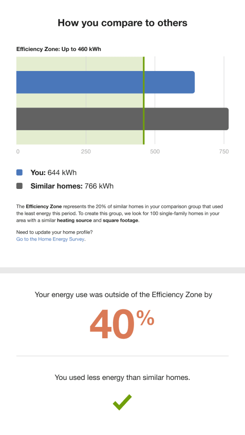

This image shows an example of the Efficiency Zone module.
Heading: The title reads, "How you compare to others." It invites the customer to explore their normative comparison and learn about their energy use in more detail.
Threshold: The label above the graph introduces the maximum Efficiency Zone threshold (for example, Up to 500 kWh). The threshold is the average use of the 20th percentile of similar homes during that bill period. A light green tinted rectangle and darker green vertical line indicate the range and threshold of the Efficiency Zone, enabling customers to quickly see whether they are in the zone. The threshold is recalculated and changes with each report.
Graph: The bar chart displays how much energy the customer (You) used in comparison with Similar Homes. The Similar Homes bar indicates the average use of the customer's neighbors.
Hero Insight: The hero insight is the large colored numeric percentage which displays the customer's status relative to the Similar Homes. The color of the large number and percent sign varies, depending on whether they are above or below similar homes. If the customer is within the Efficiency Zone, the large number is green to visually correspond with the "Great" state of the benchmark. If the customer is not within the Efficiency Zone, the large number is orange to signal warning to the customer visually correspond with the "Fair" state of the benchmark..

Explainer Text: The explainer text explains what data goes into the comparison graph and provides the customer with a way to improve or correct these details in the Home Energy Analysis.
Secondary Insight: The secondary insight is displayed below the hero metric and varies depending on the customer's energy use. If the customer is using less than similar homes or in the efficiency zone, the secondary insight will either display a green check. If the customer is not in the efficiency zone, the secondary insight will display an orange 'x' indicating that the. There are several possible states:
