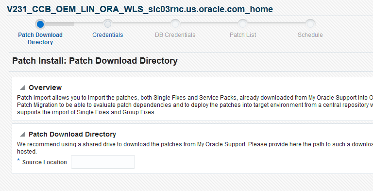

- Open the OUAF Home Target Home Page and click the Patch Install button.

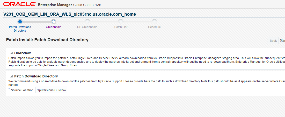

- The first page of the Patch Install walk-through appears. Enter the download directory used during patch import (relative to the target environment). After entering your selection, click Next to proceed.
Figure 2. Specifying the Install Directory

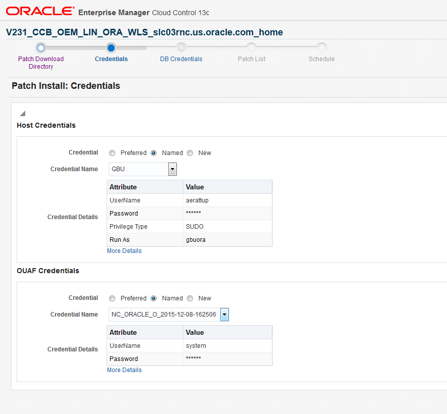

- On the Credentials page, choose a set of saved credentials or enter the user name and password for the environment, then click Next to proceed.
Figure 3. Specifying Install Credentials

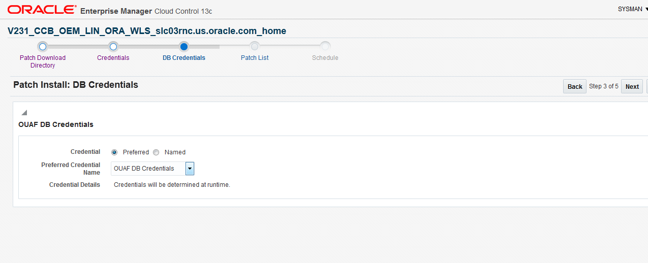

- Enter the ouaf database credentials on the next page. The credentials should have been created previously as a named credential (see the Patching Prerequisite topic for details). After entering the credentials, click Next to proceed.
Figure 4. Specifying Database Credentials

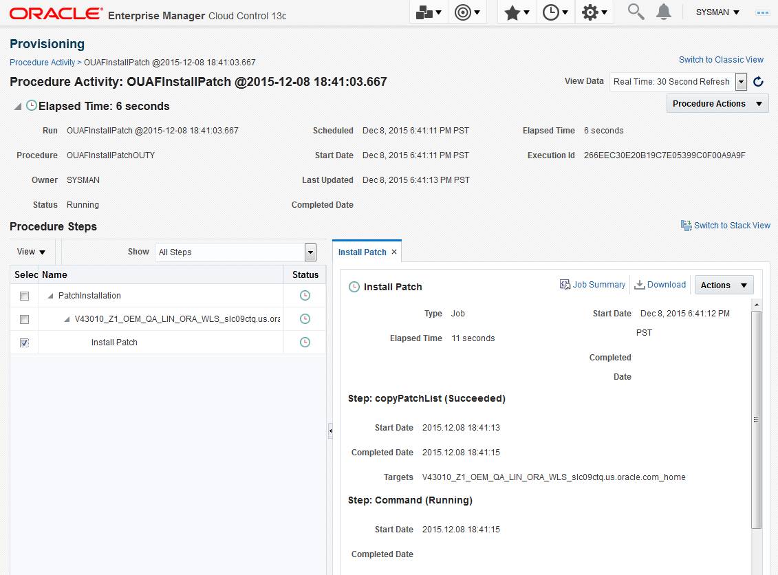

- As with the patch import procedure, check the output by going to On the Provisioning page, search for the appropriate run and click on the link. To view the output, expand the Procedure Steps on the left to view the output.
Figure 7. Install Patch Procedure Activity
