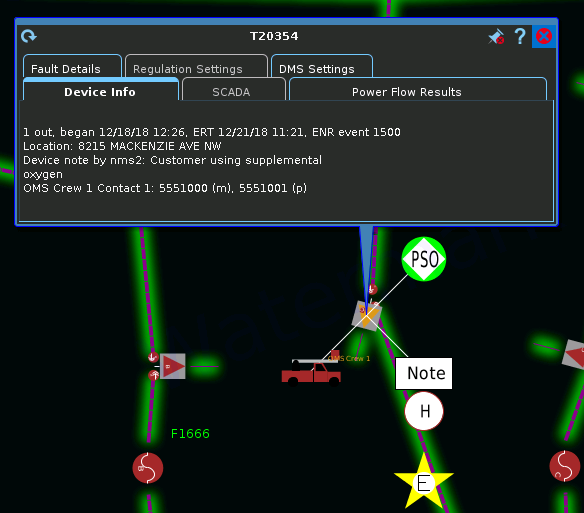

Adding Notes
The Control Tool allows you to place notes on devices. Notes may be created or opened by clicking the Control Tool Note... button, which will open the Notes dialog box. Existing notes for the selected device are listed in the Notes pane.
Note: Note text is also displayed in the Device Details balloon (see Displaying Device Details).
Notes Dialog Box
The Notes dialog box displays the following fields and buttons:
• Fields
• The Notes pane contains a table that lists existing notes.
• The Edit Log pane contains a table that lists any previous versions of the selected note that exist.
• The Note Text field displays the text of the selected note.
• Buttons
• The New button allows you to enter a new note.
• The Edit button allows you to edit the text of the selected note.
• The Delete button deletes the selected note.
• The Help button launches online help for the Notes dialog box.
• The Cancel button closes the Notes dialog box without saving changes.
Creating a Note
You can create one or more notes for a device using the Control Tool. Once you save a note, a note symbol displays in the Viewer next to the device. If you create multiple notes for a device, the number of notes is displayed in parentheses next to the note symbol.
To enter a note, complete these steps:
1. In the Viewer, open the Control Tool for the device.
2. Click the Control Tool's Note… button. The Notes dialog box opens.
3. Click the New button.
4. Click the Note Text field, and enter the note text.
5. Click Save. The note is saved and listed in the Notes pane. A note symbol appears in the Viewer next to the device. As notes are added to the device, the number of notes is displayed in parentheses next to the note symbol.

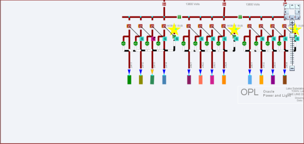

Tap Generators are used to add an energization point to the model. A Selection Required dialog box allows you to specify the tap location by clicking on the location in the Viewer.
Temporary Generator
Temporary Generators are similar to Tap Generators, but contain attributes needed to affect the power flow solution. The Add Temporary Generator... option opens the Add Temporary Regulation Device dialog box, which allows you to edit these attributes. See Adding a Temporary Generator for details.
Mobile Sub
Mobile Subs are similar to P-P Jumpers, but contain disconnect switches and a power transformer plus attributes needed to affect the power flow solution. The Insert Mobile Sub... option opens the Add Temporary Regulation Device dialog box, which allows you to edit these attributes.

• If you are placing an in-line jumper, the Model Edit in Progress dialog box will be displayed.
• If you are placing a point-to-point jumper or cross-phase jumper, you can optionally press and hold the Alt key while selecting coordinates in the Viewer for the jumper path. Continue selecting points until you have chosen your second conductor.
• To start over, right click to clear the point selections.
• If you are placing a P-P jumper or emergency cable, the Select Secondary dialog box opens. Select another conductor in the Viewer and click OK. The Model Edit in Progress dialog box will be displayed.
• If you are placing a point-to-point or an in-line cross phase, the Select Secondary dialog box will open. Select another conductor (in the Viewer), and click OK. The Cross Phase Selection dialog box opens. Select a phase for each device and click OK. The Model Edit in Progress dialog box will be displayed.

Repredicting Upstream/Downstream
You can force the system to manually repredict a predicted outage either upstream or downstream from the current system predicted device. This is typically done when a crew finds that the problem is not at the predicted device.
• If the device is energized, the problem is actually one or more downstream outages.
• If the device is de-energized, the problem will actually be upstream.
Clicking the Repredict Upstream button manually repredicts the outage to the next predictable upstream device. Clicking the Repredict Downstream button manually repredicts the outage to downstream devices based on outage prediction rules. When repredicting downstream, the system distributes the event to one or more devices. If a specific configuration rule (regroupAfterManualMoveDownstream) is disabled, then Repredict Downstream will manually repredict the outage to the next predictable downstream device(s) instead of using outage prediction rules. Once a predicted outage is manually repredicted upstream or downstream, it will be made stable (see Working with Stable Predictions). Specific configuration rules (movableAfterManualMove and stableAfterManualMove) can change whether the repredicted outages are made stable or non-movable.
Note: See Using the Event Management Rules Tab for information on how Administration users may set rules.
For example, a crew finds that a predicted service outage (indicated by the "PSO" symbol) at a transformer is not actually where the trouble is located. Using the Control Tool, you can repredict the outage upstream to the switch. When you repredict the outage, the switch displays a PDO (predicted device outage) symbol. The original predicted service outage displayed in one of Work Agenda's Trouble Events list windows changes to a predicted device outage located at the switch.
