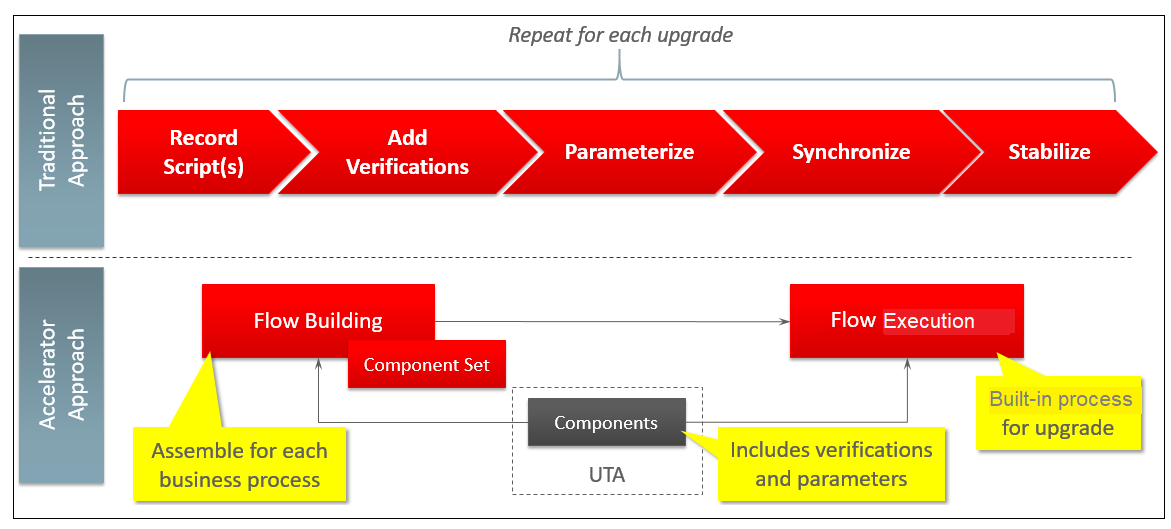

The metadata-driven automation development methodology provides solutions to such challenges.Metadata-driven automation development methodology
For the Oracle Utilities applications built on Oracle Utilities Application Framework, web service based automated testing is proven to be more robust, maintainable, and faster to develop and execute. Oracle Utilities Testing Accelerator comprises web services and UI based components that enable creation and running of test flows.

A flow design explains the order in which the components will be used to interact with each other in the flow. It also defines the test data combinations to use.
To design and develop an automated test flow:
1. Create/extend the required components that are identified in planning phase.
2. Create a test flow in Oracle Utilities Testing Accelerator that maps to the identified business test flow in the application.
For details about how to create a test flow, refer to the Creating Flows section in Appendix 5: Creating Test Flows.
For information about delivered sample flows to understand the flow creation, refer to the Sample Work Flows chapter in the respective product-specific reference guides. For a list of reference guides available in this release, refer to the Related Documents section in Preface. The sample flows are applicable to the on-premises releases of the Oracle Utilities Testing Accelerator packs.
3. Drag and drop the required components into the flow.
4. Add the test data for the flow.
The test data can be modified at the runtime using the standard Oracle Utilities Testing Accelerator databanks. For more details, refer to Appendix 5: Creating Test Flows.
Test Run
To run the automated test flow, execute the test flow in Oracle Utilities Testing Accelerator workbench.
For more details, refer to the Running Test Flows section in Appendix 5: Creating Test Flows.
The components and test flows developed using this approach are stored and components are version controlled (upto the previous approved version) in the Oracle Utilities Testing Accelerator database. It takes care of the challenges in configuration management of automated tests.
