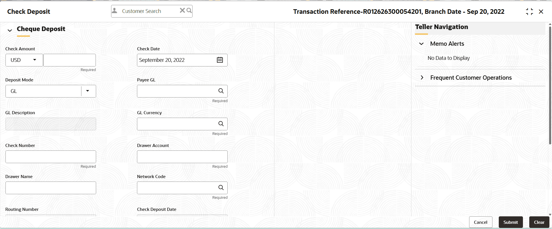

4.1.2 Check Deposit Against GL
The Teller can use the Check Deposit screen to carry out the Check deposit transaction for credit of a GL account.
To capture the check deposit request:
  1. On the Home screen, from Teller mega menu, under Clearing, click Check Deposit or specify Check Deposit in the search bar and select the screen.
    The Check Deposit screen is displayed.
  2. On the Check Deposit screen, specify the fields. For more information on fields, refer to the field description table.
    The fields marked as Required are mandatory.

  3. Specify the charge details. For information on the fields in the Charge Details segment, refer to Charge Details.
  4. Click Submit.
    A teller sequence number is generated, and the Transaction Completed Successfully information message is displayed.
    The transaction is moved to authorization in case of any warning raised when the transaction saves.
    When user submit, the transaction details are handed off to the Oracle Banking Payments system for Outward Clearing transaction processing with external system status as Pending.
    After the transaction is processed and responded from the Oracle Banking Payments with appropriate status, the Teller selects the transaction from Journal Log and completes the transaction.
