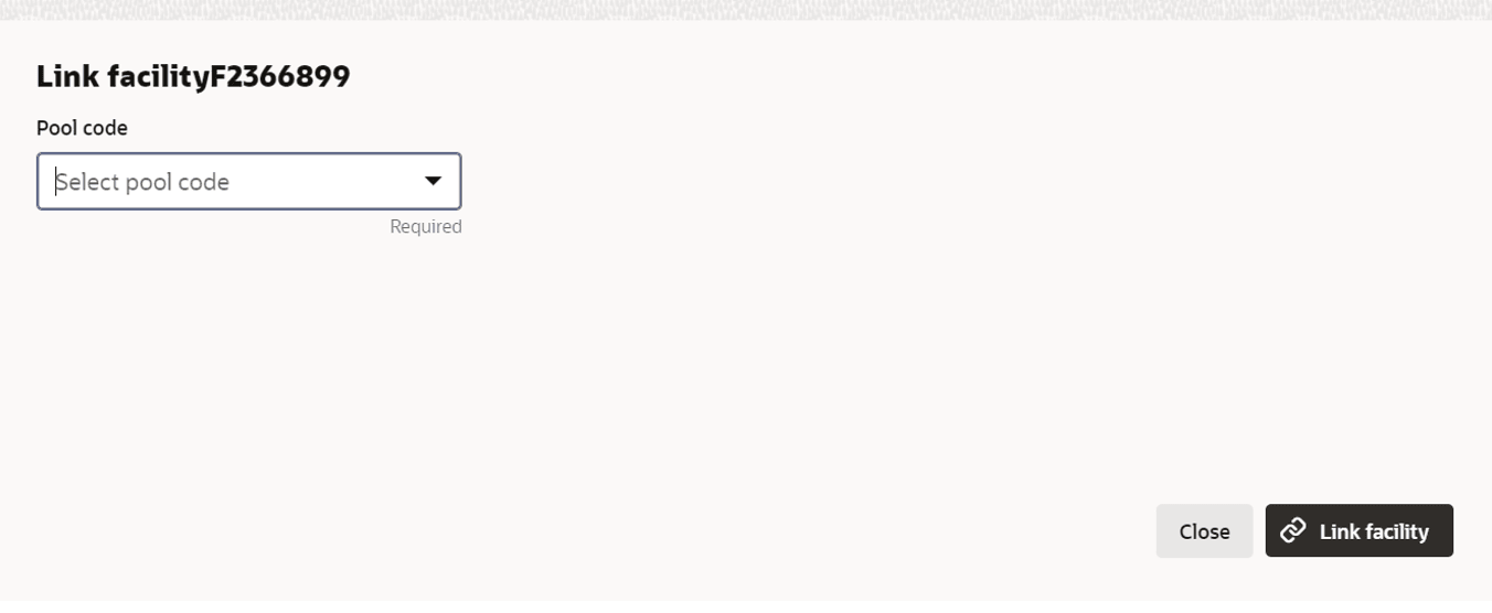

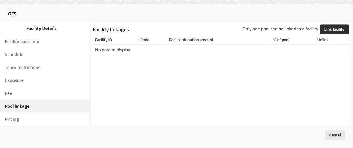

7.3 Linking Facility to the Pool
You can link facility to the collateral pools maintained in the system by selecting the pool code.
  1. Click Pool Linkage from the left menu.
  2. Click Link Facility. The following window appears:
    For Link Facility screen field level information refer the below table.
    Table 7-6 Link Facility
    Fields/ Icons Description
    Pool Code Select required Pool Code from the drop-down list.
    Link Facility Click Link Facility.

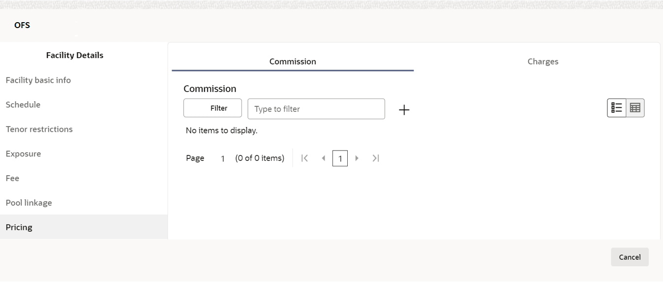

    Adding Pricing Detail
  3. Click Pricing from the left menu, to add pricing detail for the facility.
    • If Facility Type is selected as Non Funded, Commission and Charges can be added in the Pricing section.
    • If Facility Type is selected as Funded, Interest and Charges can be added in the Pricing section.

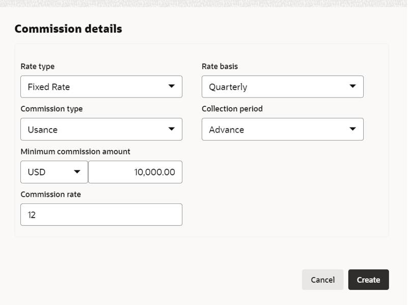

  4. Click + icon, to add commission details.
    The Commission Details window is displayed.
    For information on fields Commission Details screen refer the below table.
    Table 7-7 Commission Details
    Rate Type Select Rate Type from the drop-down list.
    Rate Basis Select the commission collection frequency from the Rate Basis drop-down list.
    Commission Type Select Commission Type from the drop down-list.
    Collection Period Select Collection Period from the drop-down list.
    Currency Search and select Currency in which the commission has to be collected from the party.
    Minimum Commission Amount and Commission Rate If Fixed Rate is selected as the Rate Type, specify the Minimum Commission Amount and the Commission Rate in the respective fields.
    Create Click Create. Commission details are added and listed in Commission tab.
    Cancel Click Cancel, to cancel the operation.

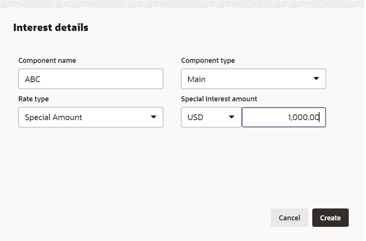

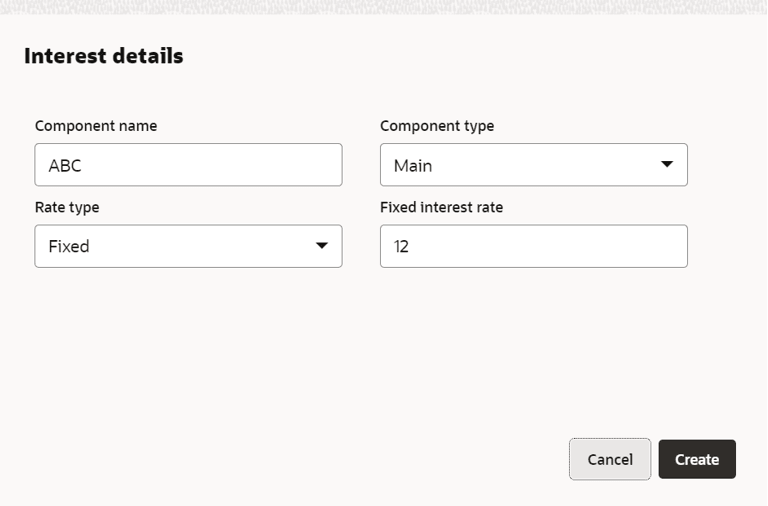

  5. Click + icon in Pricing - Interest section, to add interest details.
    The Interest Details window is displayed.
    For information on fields in Interest Details screen refer the below table.
    Table 7-8 Interest Details
    Component Name Enter a name for the interest in Component Name field.
    Component Type Select Component Type from the drop-down field.

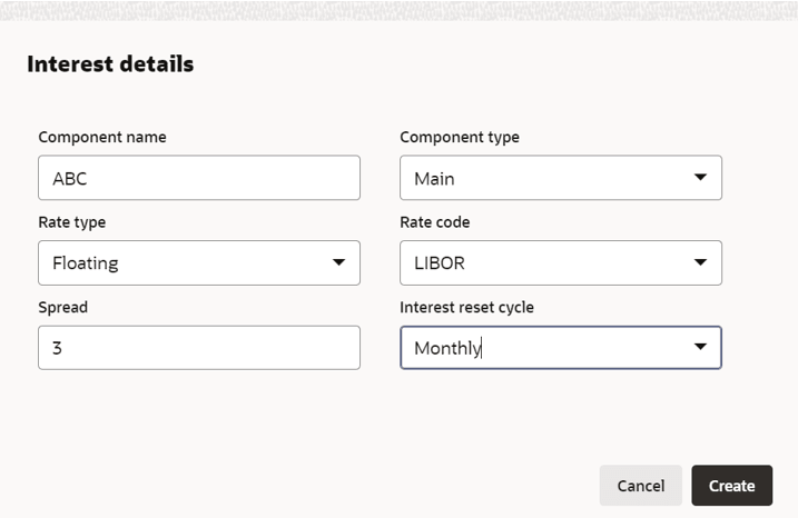

    Rate Type Select Rate Type from the drop-down field. The options available are:
    • Fixed
    • Floating
    • Special Amount
    Fixed Interest Rate Specify Fixed Interest Rate, if Rate Type is selected as Fixed.
  6. Enter or select the following details, if Rate Type is selected as Floating.
    • Rate Code
    • Spread
    • Interest Reset Cycle
  7. Search and select Currency and then specify the Special Interest Amount, if Rate Type is selected as Special Amount.

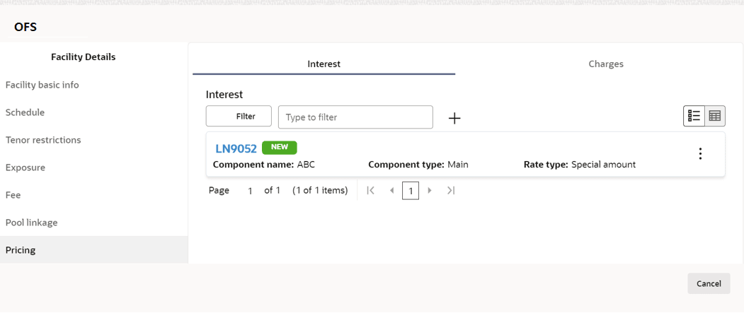

  8. Click Create. Interest details are added and listed as shown below:

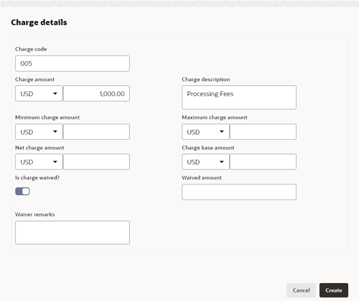

  9. Click Charges tab in Pricing section and then click +, to add the charge details.
    The Charge Details window is displayed.
    For field level information Charge Details screen refer the below table.
    Table 7-9 Charge Details
    Charge Code Enter Charge Code to mention the type of charge.
    Charge Currency Select Charge Currency from the left drop-down list given in respective fields.
    Charge Amount Specify Charge Amount for the facility.
    Charge Description Enter Charge Description.
    Is Charge Waived Enable Is Charge Waived option, if waiver can be claimed for this charge.
    Fields Enter the following details in respective fields:
    • Waived Amount
    • Minimum Charge Amount
    • Maximum Charge Amount
    • Net Charge Amount
    • Charge Base Amount
    • Waiver Remarks

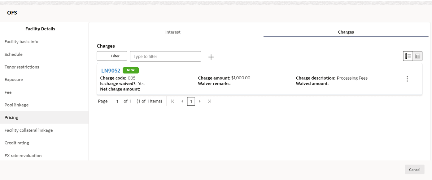

  10. Click Create. Charge details are added and listed as shown below:
    To add more charges for the facility, click + icon again and provide the charge details.
