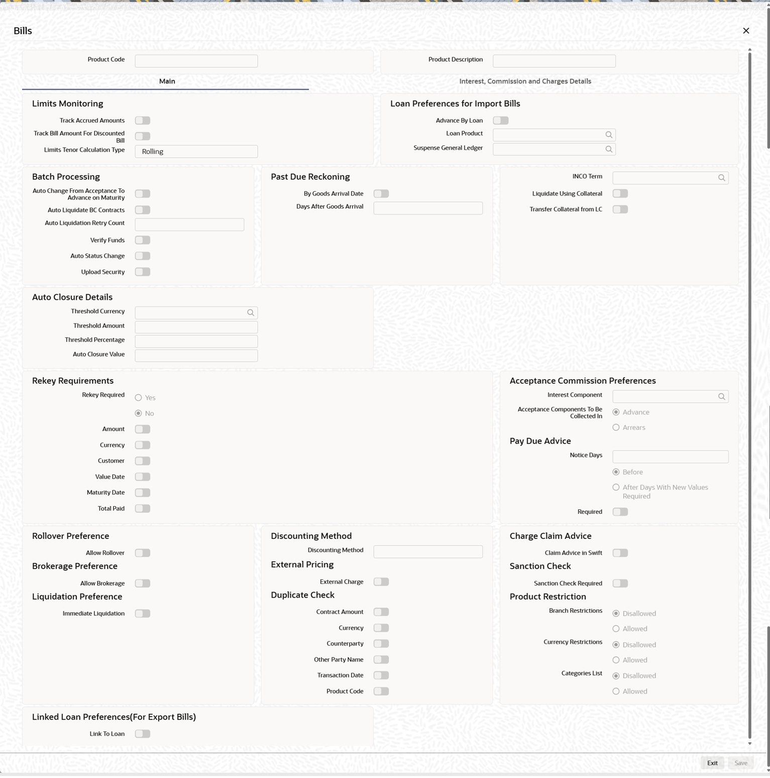

  1. On Bills and Collections Product Definition screen, click Preferences.
    Bills screen is displayed.
  2. On the Bills screen, specify the details as per the requirement.
  3. click Ok to save the details or click Exit to discard the details.

    Claim Advice in Swift Check this box to indicate that the Charge Claim Advice (CHG_CLAIM_ADV) that gets generated as part of LQ EOD batch should be in Swift MT799/MT499 Format.
    Brokerage Preference
    Specify the Brokerage Preferences as below.
    Allow Brokerage Check this box to indicate that brokerage should be applicable to all the contracts under this product.
    Sanction Check Provide the Sanction details
    Sanction Check Required Check this box to indicate that sanction check is applicable for the product. This indicates whether any transaction booked using the product is subject to Sanction Check or not. If Sanction Check Required flag is checked, then the event SNCK should be maintained.
    The system will check the MT400 message related maintenance is available at the product level. If the maintenance is not available and if the Sanction Check Required checkbox is enabled, then the system will throw an error.
    Sanction check is applicable only for Import Bills. If sanction check is enabled for other product categories, then the system will throw an error.
    Liquidation Preference For an import sight PAY product, specify the preference for bill liquidation on single stage.
    Immediate Liquidation Check this box to indicate that single stage bill liquidation should be applicable for the contracts under import sight PAY product.
    By default the flag will be disabled.
    Duplicate Check Specify the Duplicate check preferences as below:
    Contract Amount Check this box to indicate that system should check if same contract amount (along with other field, as applicable) exist in some other contracts’.
    It is a mandatory field to be checked, if duplicate check is required.
    Currency Check this box to indicate that system should check if same contract currency (along with other field, as applicable) exist in some other contracts’.
    Counter Party Check this box to indicate that system should check if there is an existing contract with same counterparty (along with other field, as applicable).
    Other Party Name Check this box to indicate that system should check if there is an existing contract with same other party name (along with other field, as applicable).
    Product Code Check this box to indicate that system should check if a contract with same product code (along with other field, as applicable) exist.
    Transaction Date Check this box to indicate that system should check if a contract with same transaction date (along with other field, as applicable) exist.
    System will sought an override message when it finds a duplicate contract with same details as ticked above. Also, If Duplicate check is not required, all the boxes should be unchecked.
    Product Restriction The Following are the Product Restriction details.
    Branch Restrictions Indicate whether you want to create a list of allowed branches or disallowed branches by selecting one of the following options:
    • Disallowed
    • Allowed
    Currency Restrictions Indicate whether you want to create a list of allowed currencies or disallowed currencies by selecting one of the following options:
    • Allowed
    • Disallowed
    Categories List Indicate whether you want to create a list of allowed customers or disallowed customers by choosing one of the following options:
    • Allowed
    • Disallowed
    External Pricing
    The following are the external Pricing details
    External Charge Check this box to indicate that external charges fetched from external pricing and billing engine for contracts created under this product.
    External Charge is enabled only when the system integrates with external pricing and billing engine (PRICING_INTEGRATION = Y at CSTB_PARAM level).
    Linked Loan Preferences for Export Bills Specify your preference for linked loans.
    Link to Loan Check this box if you want to link an export bill to a loan.
    This is enabled only for export type of bills.
