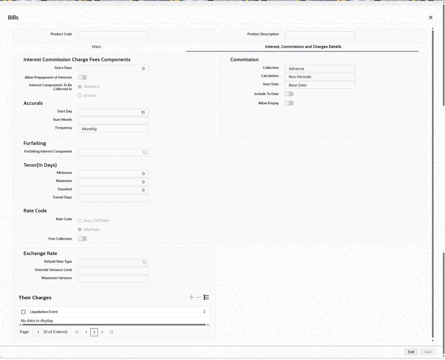

3.2.5.1 Interest, Commission and Charges Details Tab
This topic provides the systematic instructions to capture the interest and charge details.
Navigate to Preference screen under Bills and Collections Product Definition screen.
  1. On Preference screen, click Interest and Charge Details tab.
    Bills and Collections Product Definition screen with the Interest, Commission and Charges Details tab is displayed.
    Figure 3-5 Interest, Commission and Charges Details
    Description of Figure 3-5 follows
    Description of "Figure 3-5 Interest, Commission and Charges Details"
  2. On Interest, Commission and Charges Details screen, specify the details as required.
  3. Click Ok to save the details or Exit to close the screen.
    For information on fields, refer to: Table 3-16
