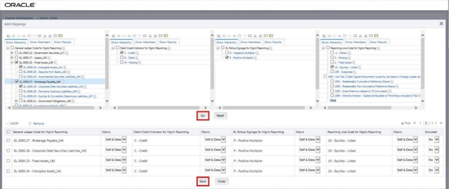

  2. The Add Mappings pop-up page appears. For illustration, select parent members of the General Ledger Code for Mgmt Reporting hierarchy, GL-3000-23 – Fixed Assets_140 and GL-3000-27 – Brokerage Payable_144, and their child members GL-3000-24 – Intangible Assets_141 and GL- 3000-28 – Corporate Debt Securities Liabilities_145 respectively, and the member of the Debit Credit Indicator for Mgmt Reporting hierarchy C - Credit to map to the member of the Reporting Line Code for Mgmt Reporting hierarchy 10 – Equities - Listed with the member of the GL Rollup Signage for Mgmt Reporting hierarchy P - Positive Multiplier.
    Figure 29-17 Add Mappings page for the many parents to one Reporting Line Code mapping at parent and child hierarchy level
    This illustration shows the Add Mappings page for the many parents to one Reporting Line Code mapping at parent and child hierarchy level. Select the required codes.
  3. To map the members, click Go. The list of mapped members appear at the bottom. To save the mappings, click Save.
    Figure 29-18 Map the members and save the mappings
    This illustration shows mapping the members and saving the mappings. Click Go to proceed with the mapping. Then click Save to save the mappings.
