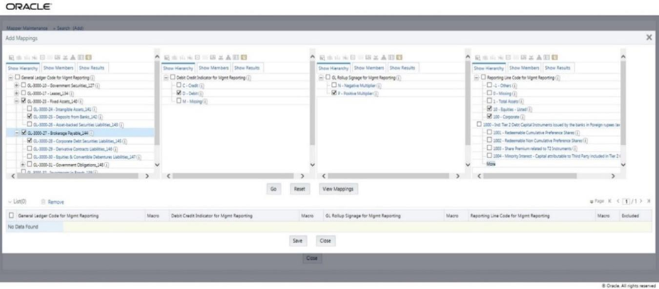

  2. The Add Mappings page is displayed. For illustration, select parent members of the General Ledger Code for Mgmt Reporting hierarchy, GL-3000-23 – Fixed Assets_140 and GL-3000-27 – Brokerage Payable_144, and their child members GL-3000-24 – Intangible Assets_141 and GL- 3000-28 – Corporate Debt Securities Liabilities_145 respectively, and the member of the Debit Credit Indicator for Mgmt Reporting hierarchy C - Credit to map to the members of the Reporting Line Code for Mgmt Reporting hierarchy 10 – Equities - Listed and 100 – Corporate with the member of the GL Rollup Signage for Mgmt Reporting hierarchy P - Positive Multiplier.
    Figure 29-20 Add Mappings page for the many parents to many Reporting Line Codes mapping at parent and child hierarchy level
    This illustration shows the Add Mappings page for the many parents to many Reporting Line Codes mapping at parent and child hierarchy level. Select the required codes.
