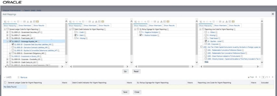

  1. In the Mapper Maintenance page, in the Member combinations section, click Add.
  2. The Add Mappings page is displayed. For illustration, select one parent member of the General Ledger Code for Mgmt Reporting hierarchy GL-3000-27 – Brokerage Payable_144 and its child member (Descendant) GL-3000-28 – Corporate Debt Securities Liabilities_145, and the member of the Debit Credit Indicator for Mgmt Reporting hierarchy D - Debit to map to the member of the Reporting Line Code for Mgmt Reporting hierarchy 10 – Equities - Listed with the member of the GL Rollup Signage for Mgmt Reporting hierarchy P - Positive Multiplier.
    Figure 29-26 Add Mappings page for the mapping combinations at parent hierarchy level by removing one or more Descendants
    This illustration shows the Add Mappings page for the mapping combinations at parent hierarchy level by removing one or more Descendants. Select the required codes.

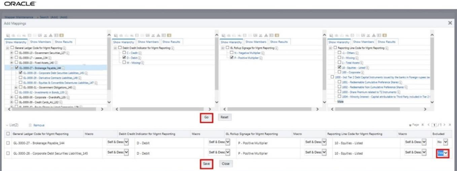

  3. To map the members, click Go. The list of mapped members appear at the bottom. To exclude the Descendant of the GL Code from the mapping, in the Macro column, select Self & Descendants, and in the Excluded column, select Yes. To save the mappings, click Save.
    Figure 29-27 Map the members and save the mappings by excluding Descendants
    This illustration shows mapping the members and saving the mappings by excluding Descendants. Click Go to proceed with the mapping. To exclude the Descendants of the GL Code from the mapping, in the Macro column, select Self and Descendants. Then click Save to save the mappings.

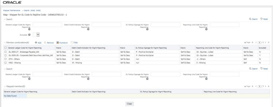

  4. An acknowledgement message is displayed. To confirm saving the mappings, click Yes.
  5. The mapped member combinations are listed in the Mapper Maintenance page with the Macro value of GL Code as Self.
    Figure 29-28 Mapped member combinations are listed in the Mapper Maintenance page
    This illustration shows the mapped member combinations listed in the Mapper Maintenance page.
