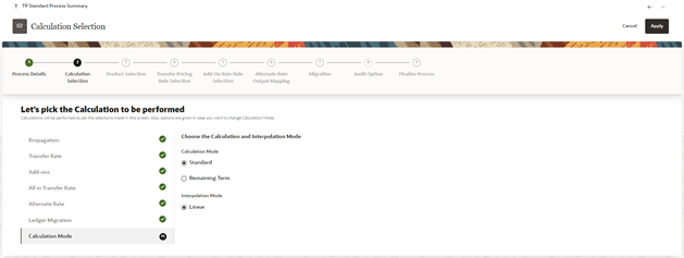

  2. Click Apply to display the Calculation Selection screen.
  3. Select the relevant details for the Calculation. For more information, see the Calculation Selection section.
    Figure 5-131 Sample Train that displays additional screens
  4. Select the relevant options for Calculation from the available list. For more information, see the Calculation Selection section.
