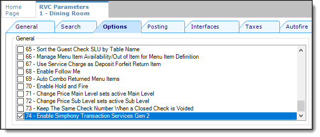

  3. Select the revenue center, click Setup, and then click RVC Parameters.
  4. Click the Options tab, and then enable 74 - Enable Simphony Transaction Services Gen 2.
    Figure 14-2 RVC Parameters Options
    This figure shows the RVC Parameters module, Options tab.
  5. Click Save.
