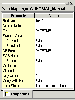

  6. Repeat this procedure as often as necessary to create additional item mappings for the child controls of group controls such as radio buttons. To view control path properties for any path, click the path in the Data Mappings window.
  7. Specify the properties of the item by clicking the item icon and editing the values in the Properties window. For more information, see Item mapping properties.
