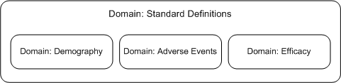

You can create Application Areas or child Domains whose sole purpose is to store library definitions. For example, in a Domain whose sole purpose is to store standard definitions, you could create Application Areas to store different categories of definitions to make the definitions easier to find by browsing. For example, you could create one Application Area for Demography-related Tables, Load Sets, Programs, Report Sets, and Workflows, and another Application Area for Adverse Events-related definitions.
The user interface separates objects within a library by object type, so there is no need to use Application Areas or child Domains to do that. You can use classification to label definitions by categories such as Demography and Adverse Events, but you can use definitions' classifications only during searching, not browsing.

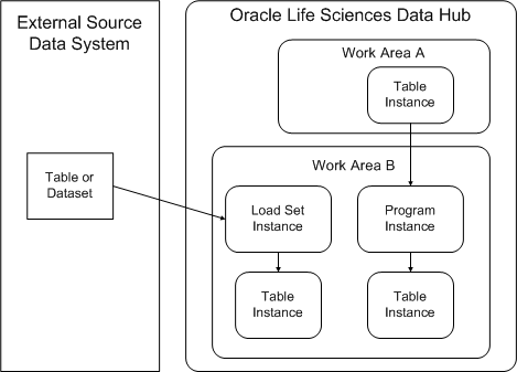

Data Flow
After a Work Area is installed, you can populate its underlying database schema with data in two basic ways:
To load data from an external system, define, install, and run a Load Set (see Loading Data) in the Work Area.
To operate on data already stored in Oracle LSH, define a Program in the Work Area and map each of its source Table Descriptors to a Table instance in any Work Area in Oracle LSH (see Operating on Data). Then install and run the Program.
Therefore it is not necessary to load data into the same Work Area where it will be processed. You can load a set of data to one Work Area and read it from a Program in any Work Area afterward. Figure 3-2 represents data flow options graphically.

- Example 4: Domain for Standard Definitions

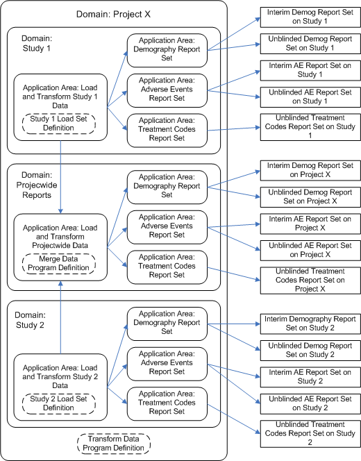

Example 1: Project Domain with Reporting on Separately Stored Study Data
Alternatively, you can keep each study's data separate throughout the process except to report on the project as a whole. Within each project Domain, create the following child Domains:
- A Domain for Each Study. Load data for each study in the project into an
Application Area in its own Domain. Create a Load Set from the source tables or data
sets. Oracle LSH stores the Load Set definition in the Application Area library.
If you collect data for different studies using slightly different formats, define a Program to copy raw data into Table instances with a standard data type and length for the project. Create an instance of the Program for each study, mapping its source table descriptors to the appropriate raw data table instances.
Create Report Sets and run each of them on the standardized study data. If necessary, create a different version of the Report Sets for each study.
When you are ready to unblind study data, run the Report Sets in Unblind mode or unblind each Table instance.
- A Domain for Projectwide Data and Reports. Define a Program to copy data from
the standardized table instances for each study into a single set of table instances
for the project.
Run the Report Sets for the project as whole. If necessary, create a new version of each Report Set for the projectwide data.
When all studies are unblinded, run the Report Sets in unblinded mode or unblind each Table instance and then run the Report Sets.

As each study becomes ready for unblinding, repeat the procedure. You can run the same or different report sets on the unblinded study data for each study and, when all studies in the project are unblinded, run the same Report Sets on projectwide data.
Figure 3-4 Organizational Structure for Example 1, with Data Flow
Use standard definitions of Tables, Programs, Data Marts, and so on to make it easier to reuse definitions and reduce the amount of work required for validation. Put standard definitions in a Domain only when you have thoroughly tested and validated them so that they are approved for reuse.
You may want to use CDISC data formats for standard Table definitions and create Programs that read from and write to those tables, for example.
You can use child Domains to organize definitions by type. For example, create a child Demography Domain to store demography-related Tables, Programs, Report Sets, and Data Marts. Create an Adverse Events Domain and an Efficacy Domain, and so on.
Figure 3-5 Standard Definitions Domain
You can create these definitions as needed in other Domains and move them to the standard definition Domain when they are ready, or you can create Application Areas and Work Areas inside these Domains for the purpose of creating and testing standard definitions.Parent topic: Examples of Organization Design
