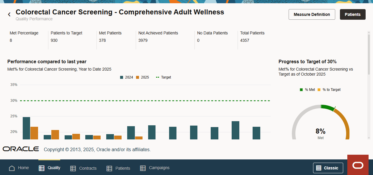

The following information about the measure is included on the measures detail page:
  • Met Percentage: The percentage of the target goal that has been met.
  • Patients to Target: The number of patients to target to achieve the measure goal.
  • Met Patients: The number of patients that have successfully met the measure.
  • Not Achieved Patients: The number of patients that have not met the measure.
  • No Data Patients: The number of patients for which there is no data.
  • Total Patients: The total number of patients eligible for the measure.
  • Performance Compared to Last Year: A comparison of the met percentage for the measure between the current year and the previous year.

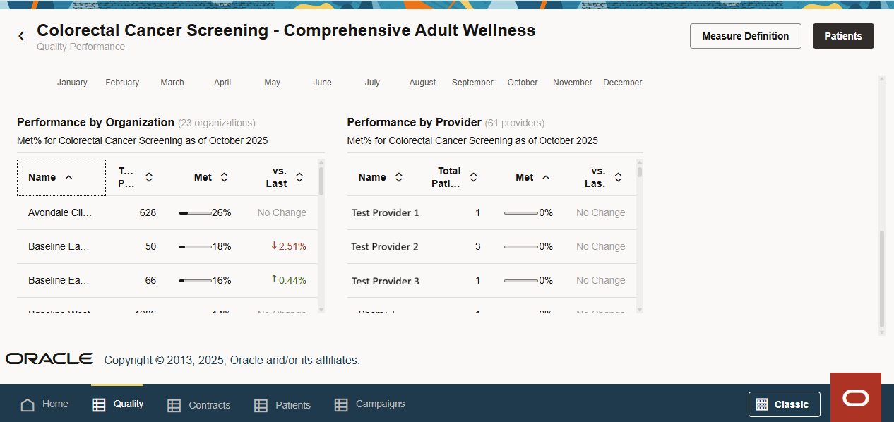

  • Performance by Organization: A list of organizations and their progress toward the measure goal. You can sort the list by each heading in the table:
    • Name (alphabetic)
    • Total Patients
    • Met (percentage met for the measure)
    • vs. Last (change versus last year)
  • Performance by Provider: A list of providers and their progress toward the measure goal. You can sort the list by each heading in the table:
    • Name (alphabetic)
    • Total Patients

Measure detail view showing bar graph
Measure detail view showing organizations and providers
